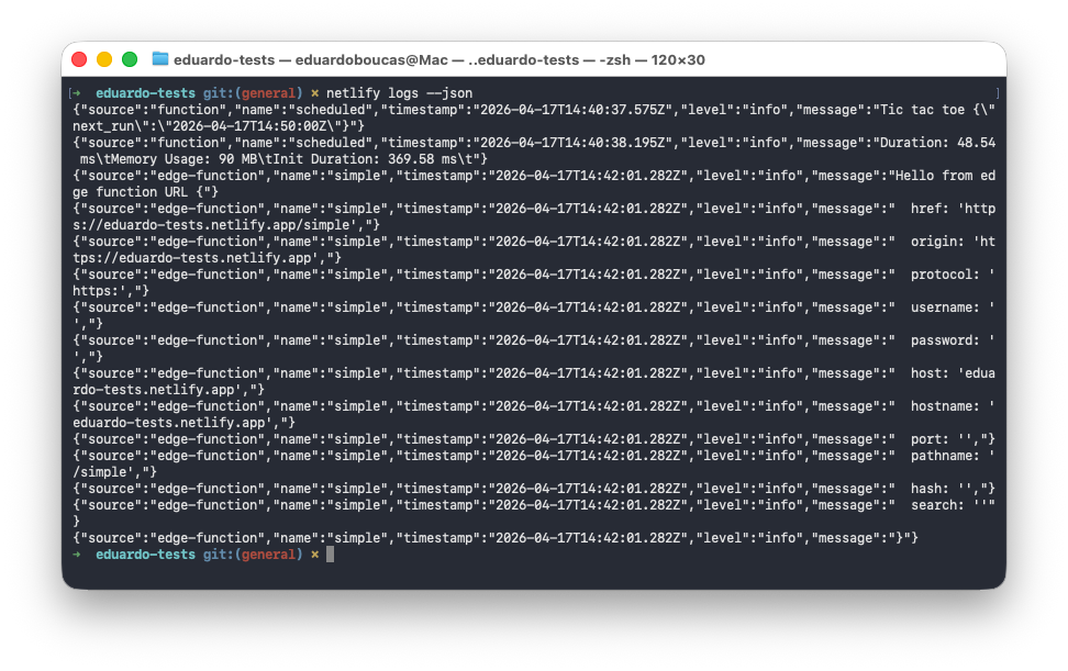

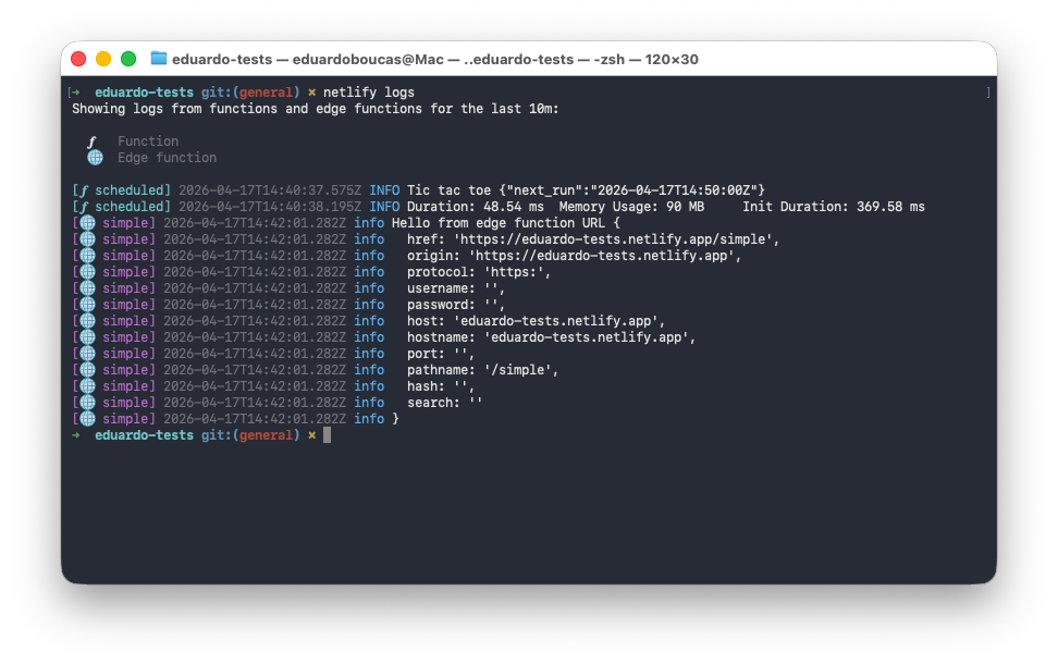

The Netlify CLI now includes a
netlify logscommand, giving you a powerful and flexible way to access logs for your projects whether you’re a developer debugging locally or an AI agent processing structured output.Filter by source
Use
--sourceto pull logs from functions, edge functions, deploys, or any combination of them together. Color-coded output makes it easy to tell sources apart at a glance when you’re tailing multiple at once.
Need to narrow it down further? The
--functionand--edge-functionflags let you filter to a specific function by name, and--urllets you target the exact deploy you want logs from.Historical and real-time views
The
--sinceand--untilflags let you query logs over any specific time window — useful for tracking down what happened during a past deploy or incident. When you want to watch logs as they come in,--followstreams them in real time.JSON Lines support
Pass
--jsonto get structured output in JSON Lines format. This works in both historical and real-time modes, makingnetlify logseasy to pipe into your own tooling or integrate into automated workflows.
Update to the latest Netlify CLI to start using it:
npm install -g netlify-cli@latestThen run
netlify logs --helpto see all available options. -
