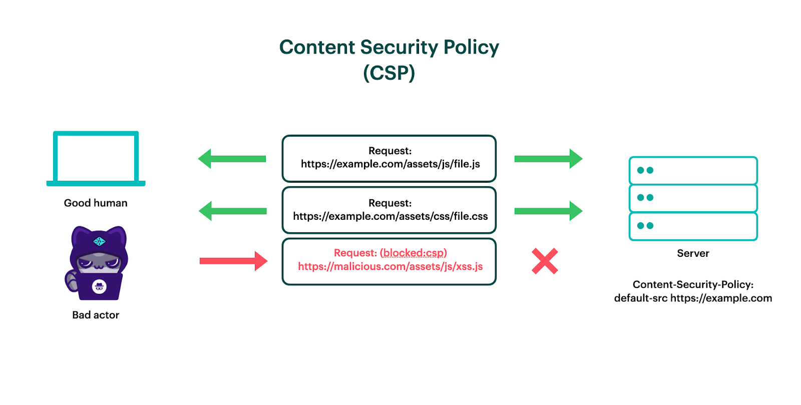

A Content Security Policy (CSP) is “a mechanism by which web developers can control the resources which a particular page can fetch or execute”. It instructs the browser to restrict network requests to a set of trusted domains specified by the website. It is an effective tool in the security tool belt that helps prevent resources — scripts, stylesheets, images, etc — from loading or executing without the website owner’s consent.
When we refer to a CSP, we are talking about a website’s Content-Security-Policy response header. The header’s value is a string of text, a semicolon-separated list of directives (like script-src, image-src, connect-src, etc) and their source lists, a list of domains (or content hashes) separated by spaces. This response header controls which external resources are allowed to be accessed by the site.

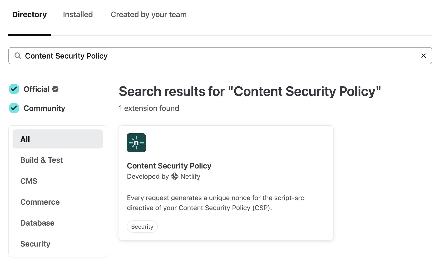

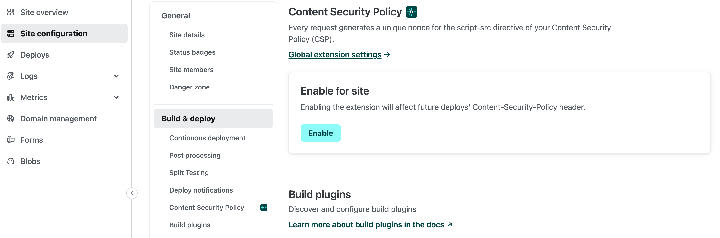

We’ve developed an extension using the Netlify SDK that will configure and deploy this edge function for you, called the Content Security Policy extension. Simply head to the Extensions page for your team, search for “Content Security Policy”, and install the extension:
After you install the extension on your team, navigate to Site configuration > Build & Deploy > Content Security Policy for the site you want to add a CSP nonce to and select Enable:

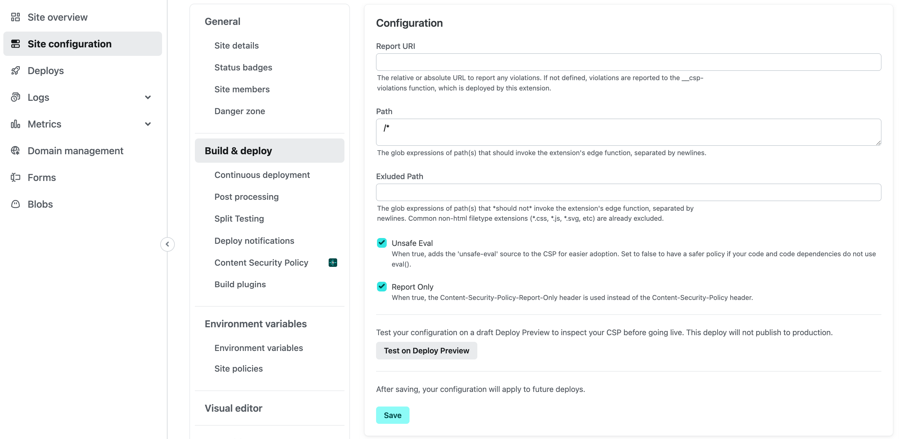

The page will update and you can then configure the options in the same section:

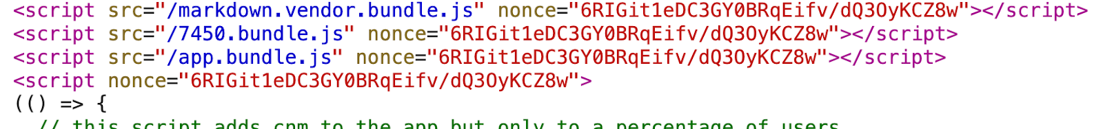

script-src 'nonce-6RIGit1eDC3GY0BRqEifv/dQ3OyKCZ8w' 'strict-dynamic' 'unsafe-inline' 'unsafe-eval' 'self' https: http:; report-uri /.netlify/functions/__csp-violations
Here, the 'unsafe-inline', 'self', https:, and http: sources are supplied for backwards-compatibility purposes, and are ignored by browsers that support the strict-dynamic source list keyword. Modern browsers support strict-dynamic (CSP Level 3 in Chrome 52+, Edge 79+, Firefox 52+, and Safari 15.4+).
By default, the extension will use the Content-Security-Policy-Report-Only response header for your CSP. This means that violations will be logged, but not blocked, giving you insight into how production traffic behaves with the policy without breaking functionality. Violations will be reported to and logged by a Netlify Function also deployed by the extension — you can monitor the violation reports by checking the logs of the __csp-violations function.
To graduate from a Content-Security-Policy-Report-Only header to a Content-Security-Policy header, remove the 'unsafe-eval' source list keyword (present by default for easier adoption), or configure a custom report-uri, just change the configuration values for the extension under Site configuration > Build & Deploy > Content Security Policy.
To gradually control the rollout of the nonce in your CSP while you monitor violation reports, you can set the CSP_NONCE_DISTRIBUTION environment variable to a value between 0 and 1. This value controls the percentage of traffic that would receive a transformed response containing the CSP nonce.

The dynamic nonce gets added to both external and inline scripts.
