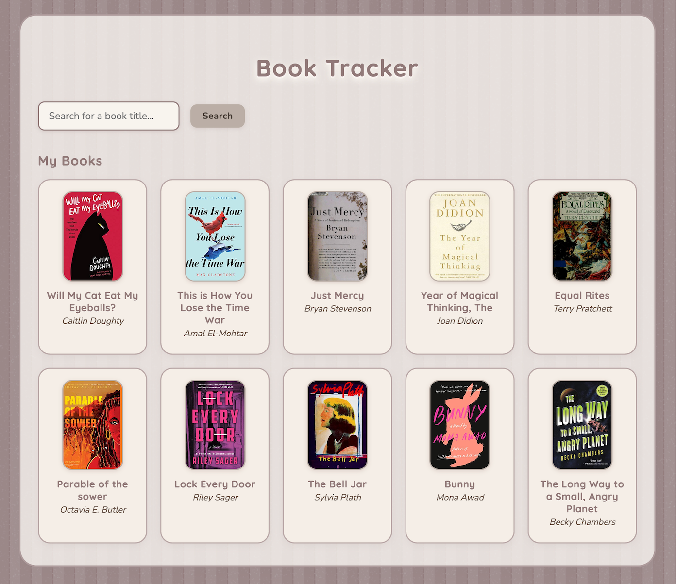

Building a book tracker in minutes
Let’s see this in practice. With our MCP Server and Netlify DB, you can now have this conversation with your AI agent, something like ‘Create a book reading tracker app with a database’.
The agent can then scaffold a complete fullstack application using Netlify:
- Frontend components → React with Vite for fast development and building
- API endpoint → Netlify Function handling book storage and retrieval
- Database → PostgreSQL via Netlify DB, automatically configured
- Cover images → Book covers stored in Netlify Blobs
- Deployment → Live URL with Git-based CI/CD
Here’s the complete working backend and API the agent generated in our case:
import { neon } from "@netlify/neon";import type { Context, Config } from "@netlify/functions";
const sql = neon();
// Ensure table existsasync function ensureTable() { await sql(` CREATE TABLE IF NOT EXISTS books ( id SERIAL PRIMARY KEY, title TEXT NOT NULL, author TEXT NOT NULL, cover_url TEXT NOT NULL ) `);}
export default async (req: Request, context: Context) => { await ensureTable();
if (req.method === "GET") { // Fetch all books const rows = await sql("SELECT * FROM books ORDER BY id DESC"); return new Response(JSON.stringify(rows), { headers: { "Content-Type": "application/json" }, }); } else if (req.method === "POST") { // Add a new book const { title, author, cover_url } = await req.json();
if (!title || !author || !cover_url) { return new Response(JSON.stringify({ error: "Missing fields" }), { status: 400, headers: { "Content-Type": "application/json" }, }); }
await sql( "INSERT INTO books (title, author, cover_url) VALUES ($1, $2, $3)", [title, author, cover_url] );
return new Response(JSON.stringify({ success: true }), { headers: { "Content-Type": "application/json" }, }); }
return new Response("Method Not Allowed", { status: 405 });};
export const config: Config = { path: "/api/books",};One prompt, two commands, and 50 lines code later, we have a working backend.
Explore and deploy the full React demo in Netlify’s examples on GitHub.

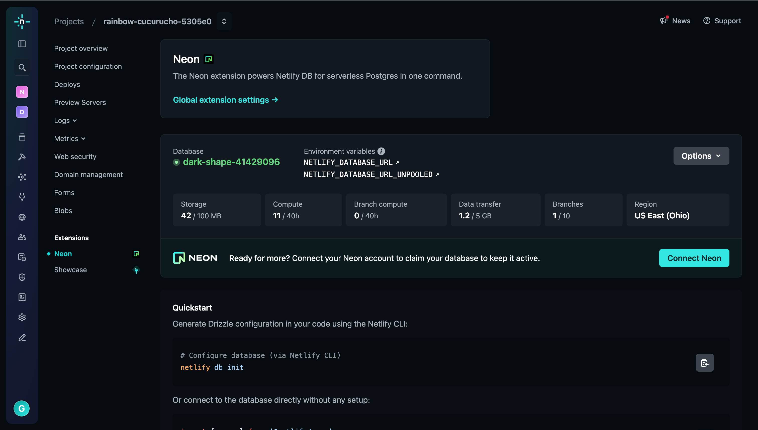

Production-ready Postgres
Netlify DB starts simple but grows with your needs. Development databases work immediately and give you 7 days to explore before you’re required to connect it to your Neon account. Which you can do from the Netlify Dashboard:
When you’re ready for production you can use Neon to:
- Add RLS policies for secure, multi-user applications
- Branch your database for safer feature development
- Scale compute resources as your application grows
And because Netlify DB is built entirely on open source PostgreSQL, you maintain full control of your data and can use any Postgres-compatible tools.
