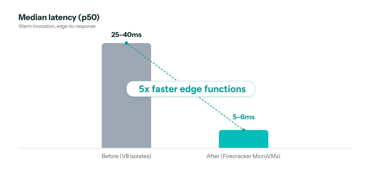

The numbers, first
An edge function runs in front of a site, on every request that matches it. The time it takes is time a customer spends waiting, so milliseconds here count for more than they do almost anywhere else.
A warm invocation — routing to a compute node, entering a MicroVM, running the function, producing response headers — now costs:
  • ~5–6ms at median (p50), down from 25–40ms on our previous infrastructure
  • 47.4% faster p99 invocations
  • 99.998% availability
  • 5x faster edge function log delivery
Median warm-invocation latency decreased from 25–40 milliseconds with V8 isolates to 5–6 milliseconds with Firecracker MicroVMs

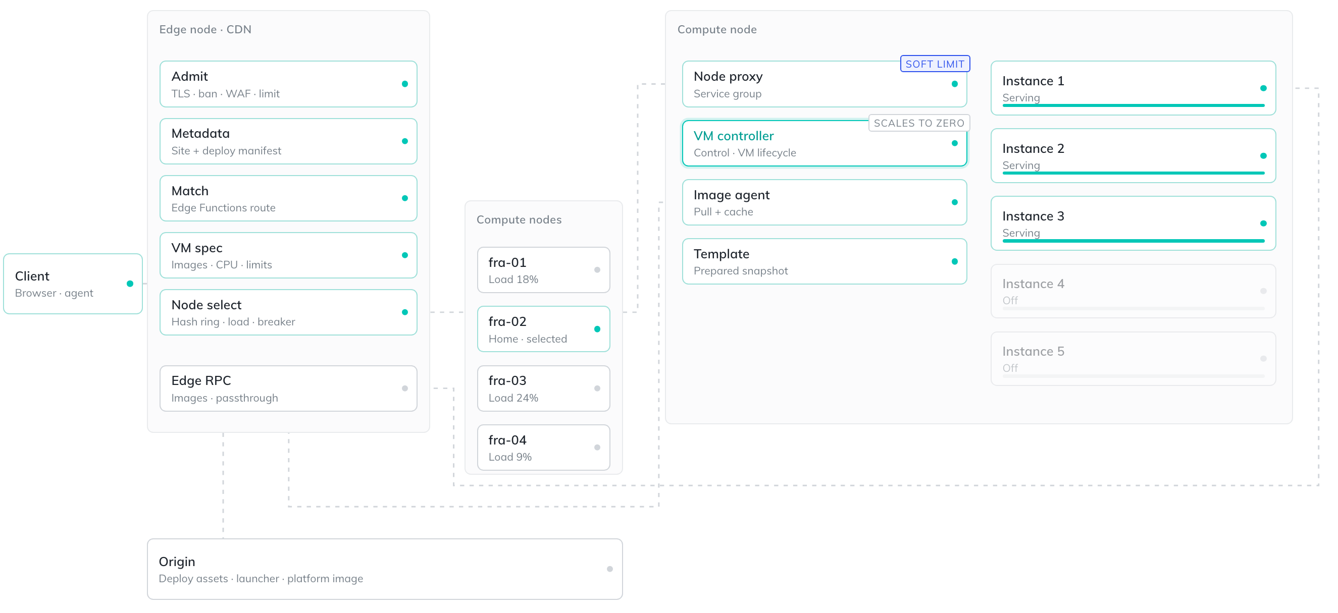

What happens during request time
What follows is the path a single request takes, in order: it arrives at the edge node, it’s turned into a specification, is routed to a compute node, and then handed off to a MicroVM that may or may not already exist based on whether it’s a cold or warm invocation.
Warm and cold Edge Function requests traveling from the client through an edge node and compute node to a MicroVM instance

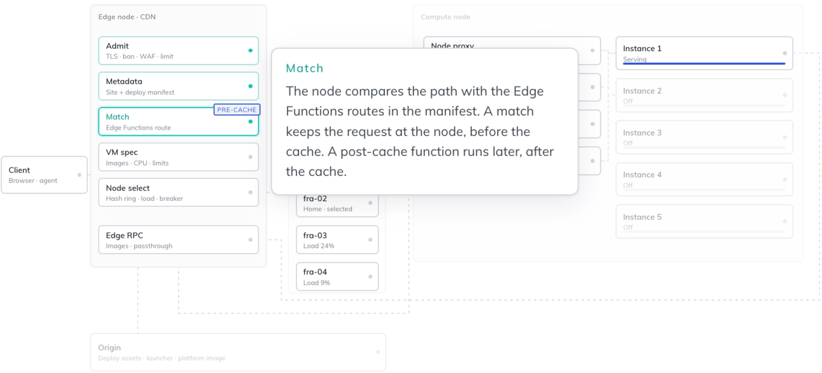

Request arrives at the edge node
Every request lands on the Netlify edge node closest to the client. The node terminates the TLS connection and checks the request path against the Edge Functions’ routes for that deploy.
If nothing matches, the request carries on to the cache and onto the origin as usual. If a route does match, this is the point where the request used to leave our network. With our old infrastructure it went out over the internet, ran the edge function, and came back to us to pass on. With the new compute platform, the request is forwarded to a compute node within our network.
An edge node matching an Edge Function route before forwarding the request to a compute node
Creating an Edge Function service
When the compute node receives the request with the machine specification and the service ID, it first checks to see if a service with that ID already exists. If it does, it forwards the request into the service for it to send into the MicroVM. A service lets us have multiple MicroVMs associated with the same site’s Edge Functions, and allows us to configure parameters for when to scale MicroVMs in and out. For example, we configure each service to only allow a fixed number of requests to be handled by a MicroVM before we shut it down, to avoid MicroVMs running indefinitely. We use the same parameters to know when to eagerly boot up another MicroVM in anticipation of one shutting down.
If a service for the site’s edge functions doesn’t already exist on the compute node, one is created, and we check to see if we have all the images in the machine specification on disk. If any are missing, they’re fetched from the edge node and written to disk. This approach means we only fetch the edge function images that are receiving traffic in that region.
The edge node writes a spec
Before the request goes anywhere, the edge node writes a specification for the machine that will run a function. The spec names three images: the runtime, our platform image, and the edge function image. It also sets the CPU, memory, and connection limits.
The spec travels with the request, on every request. Its hash and site-specific information is computed to become a service ID. This allows for isolation, since two deploys with different code or different environment variables are different services, and they never share a MicroVM.
This isolation matters most for failures we don’t want to be possible. A potentially compromised deploy runs in a separate MicroVM, and even if it escapes the runtime, it cannot poison other customers or the compute layer itself. V8 isolates, no matter their name, do not provide this level of isolation.

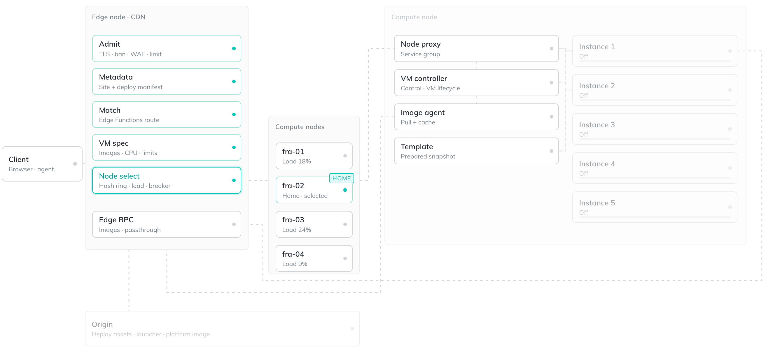

Choosing a compute node to run an edge function
Each region has a group of compute nodes. The edge node picks one for the service using rendezvous hashing: the same service lands on the same node every time, which is what keeps a MicroVM warm and the code already on disk and in cache once it’s been read. This stickiness gives us a caching strategy. If we spread requests evenly across the swarm, we’d end up with a higher level of cold starts.
It’s important to remember that while sending every request for a function to the same compute node is the fast path, it’s also how a hot spot forms — where one busy function competes for resources with everything else on that box. A service taking a large share of a region’s traffic pinned to a single node will saturate the node at the expense of other services.
We balance this by relaxing the stickiness. Over a certain threshold, we spread the service across a slice of nodes. This lets us absorb sudden spikes in traffic from a single customer without affecting other services that hashed to the same node.
Finally, once a node is chosen, it pulls in the function’s code. A compute node that has served the function before already has it. A node seeing it for the first time fetches it once and caches it, so only the first request pays that cost.
An edge node selecting a compute node where Edge Function images are pulled and cached
Starting the MicroVM
Each function runs in its own Firecracker MicroVM. These are created in under a millisecond and start in about 2ms at p99, because the VM starts a stripped-down Linux environment rather than a full operating system. The edge function’s files are mounted as an uncompressed EROFS image and then memory-mapped, so the VM reads only the parts of the bundle it actually uses instead of loading all of it.
When the MicroVM boots up and the JavaScript server begins to listen on a port, we take a snapshot of the MicroVM. When the edge function isn’t being invoked, the MicroVMs running it scale to zero instead of sitting idle. The next time it’s invoked, we start a new MicroVM from that snapshot. The snapshot is memory-mapped, so the VM can start executing without waiting for the entire snapshot to be read back into memory.
The lifecycle of the VM — boot, snapshot, restore, and scale to zero — is the work of Unikraft’s product. We worked closely with them throughout the migration to make sure it holds up under our request volume and traffic patterns.
Running and response handling
After operating this project for several years, we already had learnings we incorporated to maximize performance and the ability to debug. At scale, we’ve run into all kinds of issues, from running out of ports on virtual switches to DNS (we were surprised, but it wasn’t always DNS).
In this iteration, we made sure compute nodes run local DNS resolvers. We’ve also expanded the metrics we collect, recording things like boot time, time to first port open, and time to start user code. There are also several circuit breakers in place to ensure prompt rerouting and decommissioning of compute nodes.
Circuit breakers monitoring the Edge Function request path and MicroVM instances
That’s the whole path, and on a warm instance it adds about 6ms. None of it leaves our network, and we’re in control of the whole request cycle. Everything above happens between the request arriving and the response going back out.
