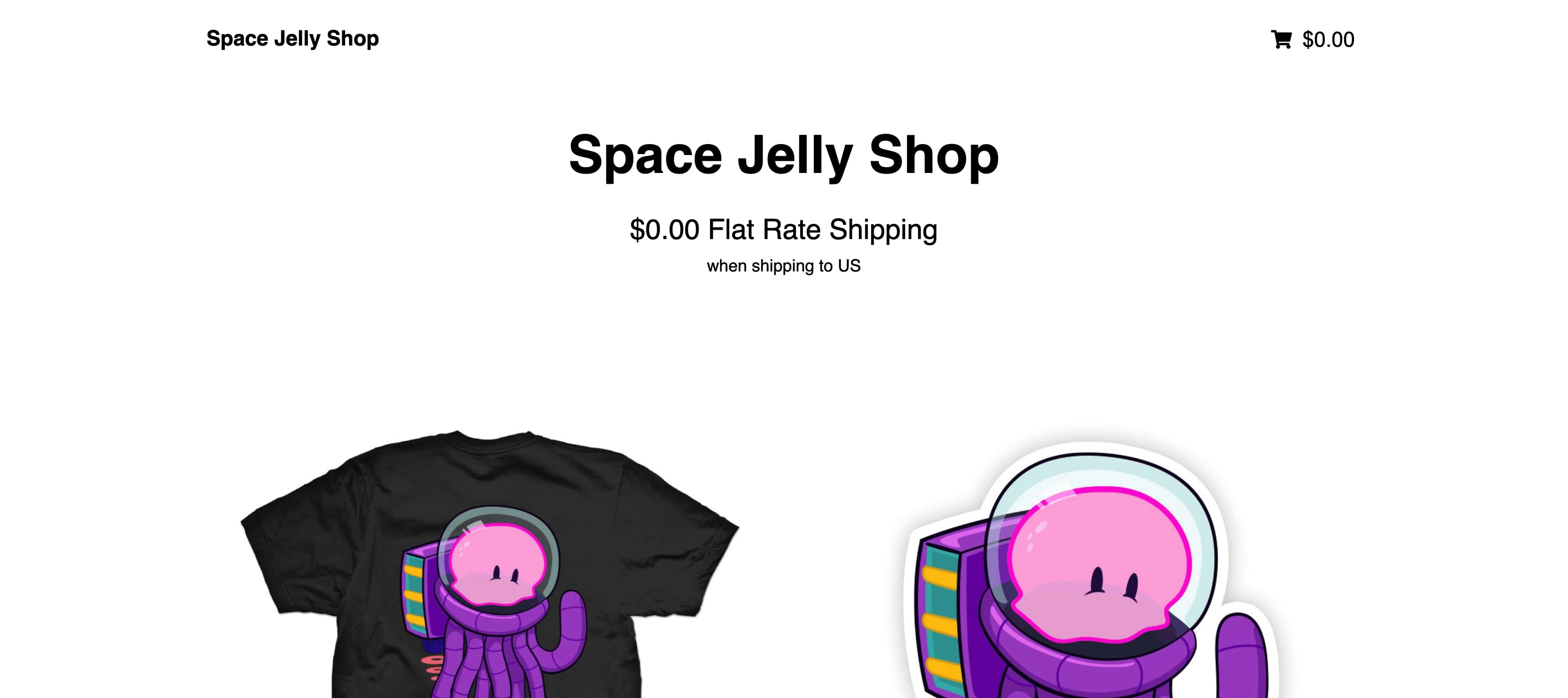

netlify dev
And once you visit it in your browser at http://localhost:8888/, we should see our new application!

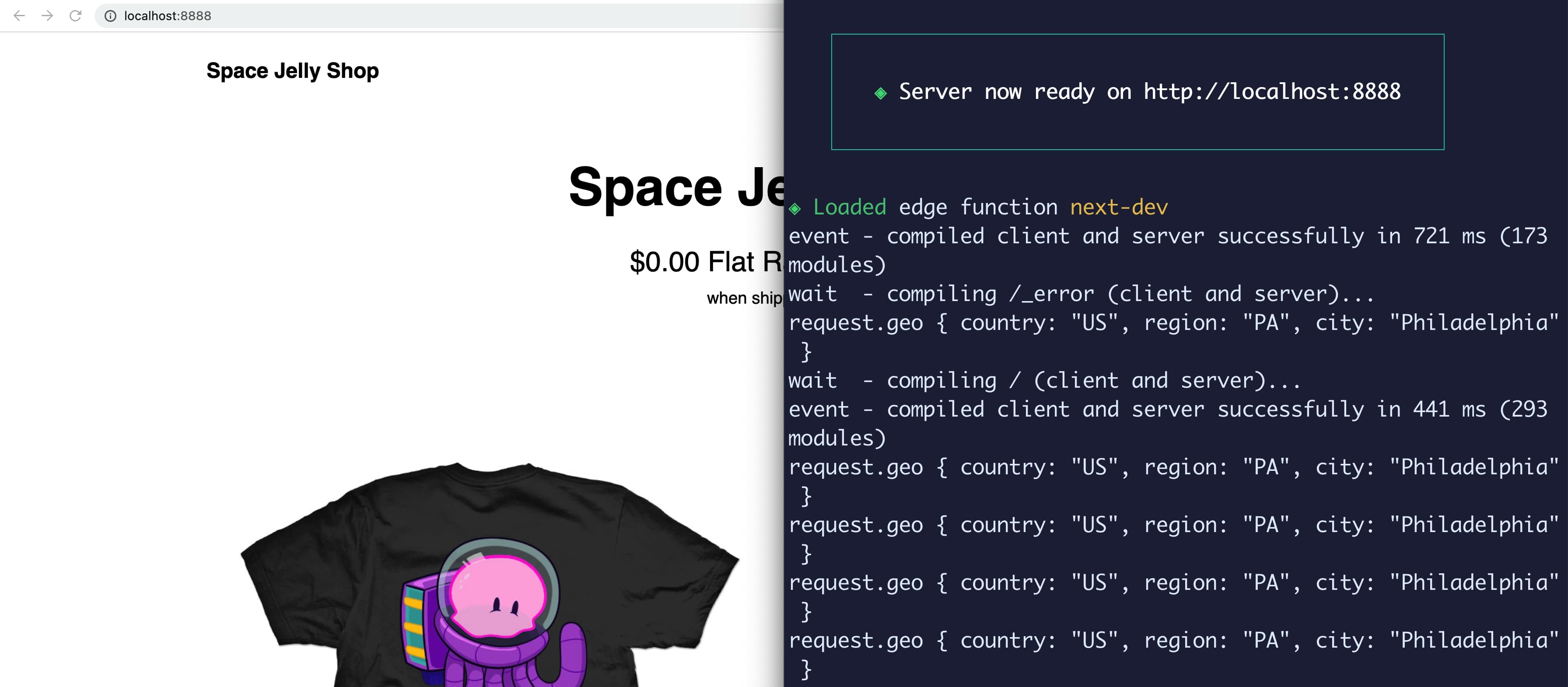

After the response definition, add a new console log:
console.log('request.geo', request.geo)
And if we reload the page and check out our terminal, we should see our city, state, and country!

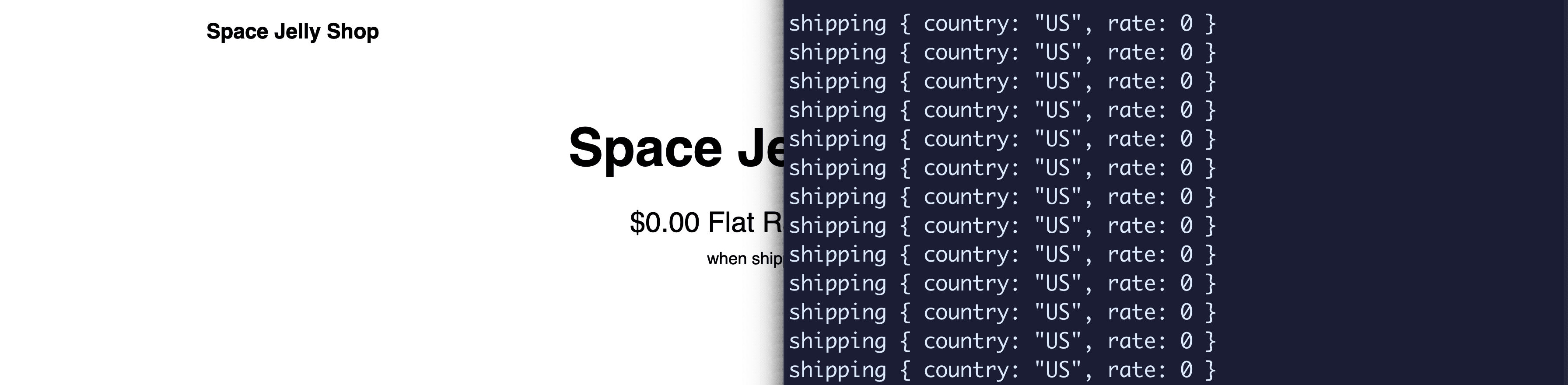

Then we can use our geographic location to find our rate:
Instead of the console log add:
const shipping = shippingRates.find(({ country }) => country === request.geo.country);
console.log('shipping', shipping);
Here we’re using the find method to look for the first item in our shipping rates array that include the country we’re trying to match.
If our country is in that list, once we reload the page, we should see our shipping rate logged to the terminal.

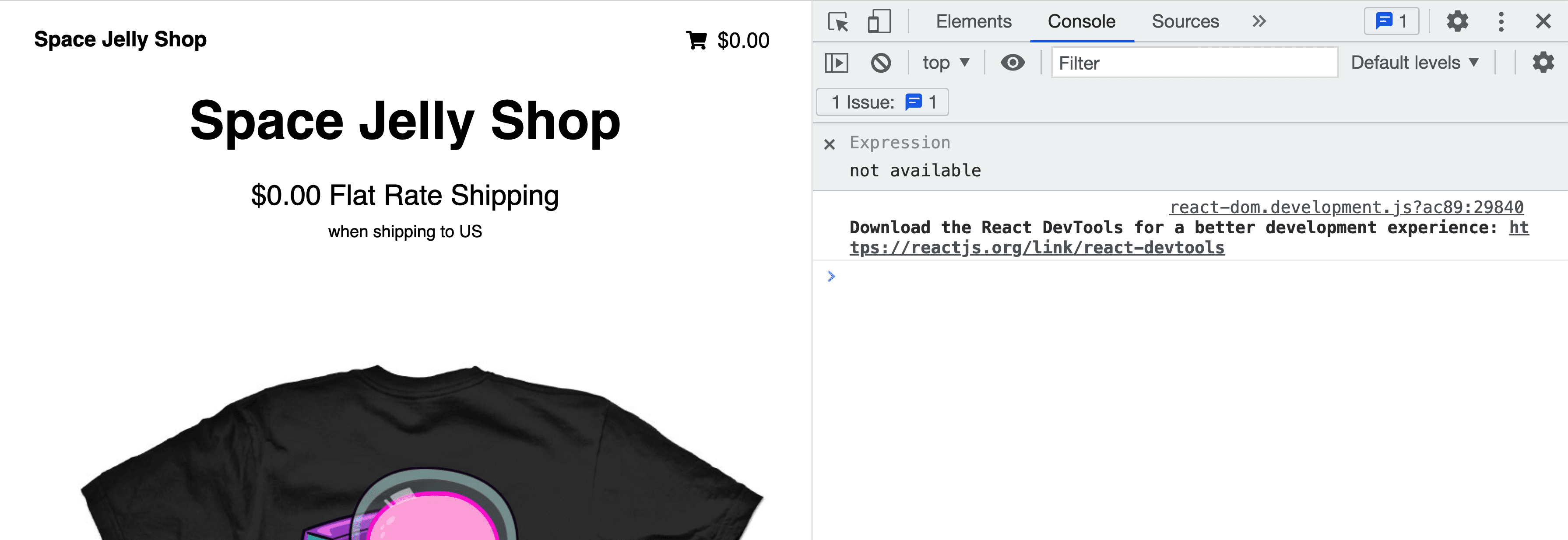

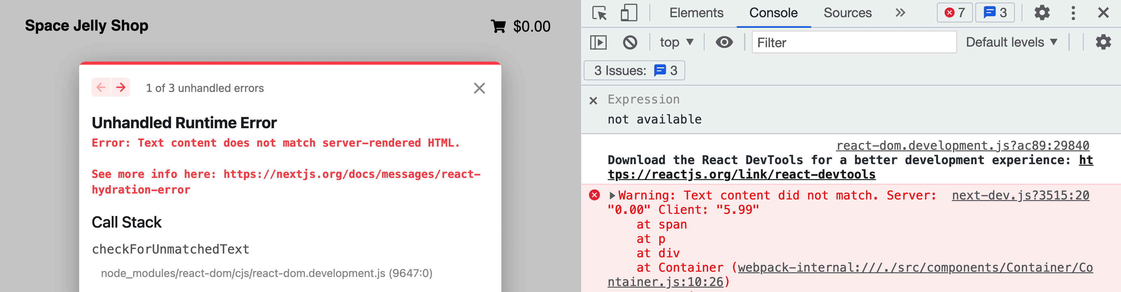

Once you refresh the page, depending on where you’re located, you might have mixed results.
If you’re in the US, it will reload like nothing happened.
If you’re outside of the US and you hadn’t made any other changes, you’re going to hit a snag!
Tip: If you’re in the US, you can test out the error by changing the country in the
findmethod inside ofgetStaticProps. Try “CA”!
Now as we talked about a few paragraphs ago, this was expected. If both versions of our Next.js lifecycle don’t match, we’ll get a React hydration error in Next.js.
So let’s fix this.
Below where we are replacing our text inside of middleware.js add:
response.setPageProp('shipping', shipping);
We’re taking out shipping object which was dynamically determined from our location and setting the prop to that value.
And now when you refresh the page, both the server and the client versions of our page will match, and we no longer get an error!

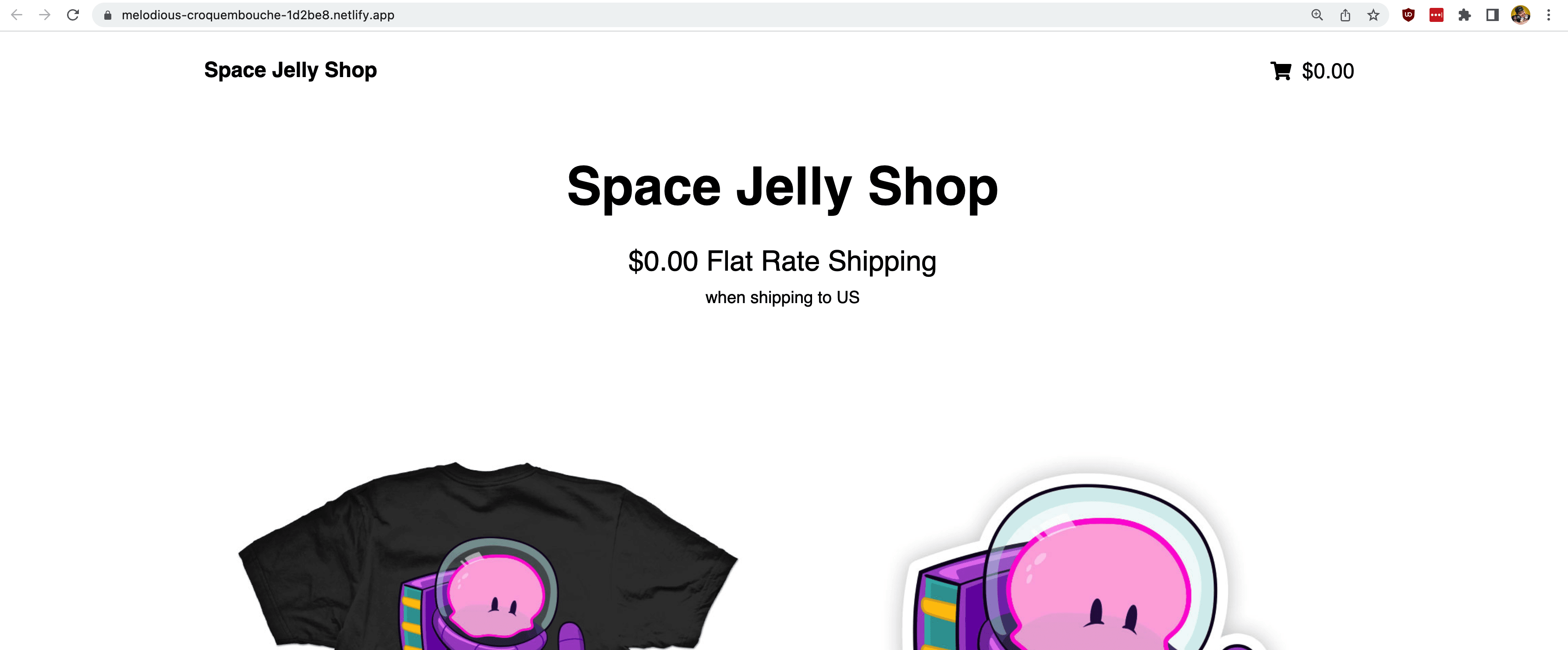

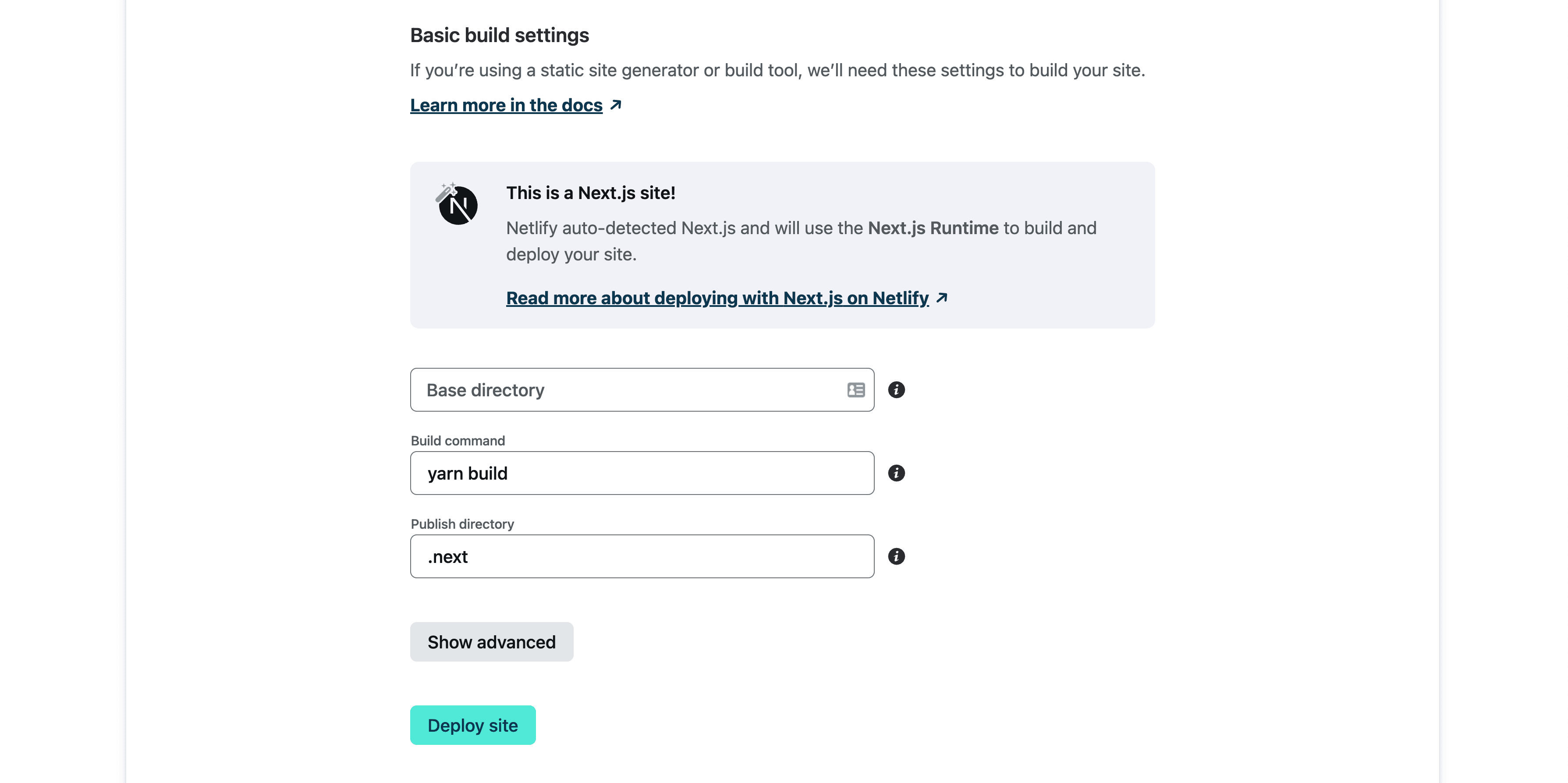

Step 3: Deploy the Next.js App to Netlify

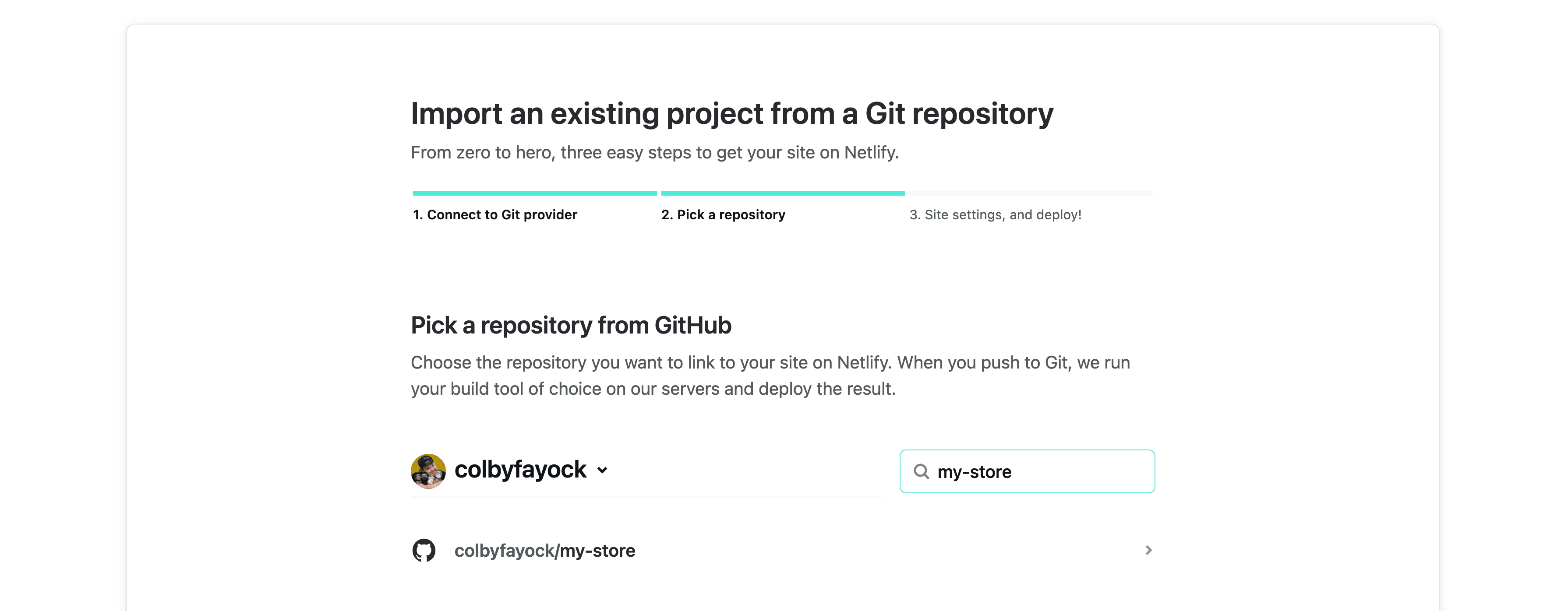

Finally, we want to deploy it to Netlify so we can share it with the world.
You can either continue to do this with the Netlify CLI or use the UI to import the project from your favorite Git Provider.
For deploying from the UI, first select Add new site from your Netlify dashboard, connect to your Git Provider, then find your repository.
Once you select your project, if your project is following typical Next.js conventions, Netlify will detect that it’s a Next.js site and automatically configure your project build settings.
That means, all we have to do is click Deploy site!
And after we do, Netlify will kick off the build process, and deploy the results.
Once that build completes, you’ll see a green success message of Published where you can now open your new globally available Next.js site!
