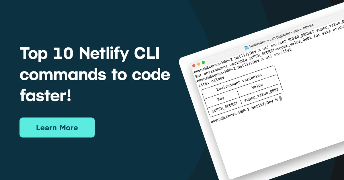

Netlify env:set
Managing environment variables are particularly challenging when working from multiple environments. With this command, you can immediately create environment variables for your Netlify site from the command line. And with your local site linked to Netlify, the environment variables set locally will be picked up by Netlify when your site is building:
You can also use the list subcommand to see a list of all the environment variables available on your site and their values.
