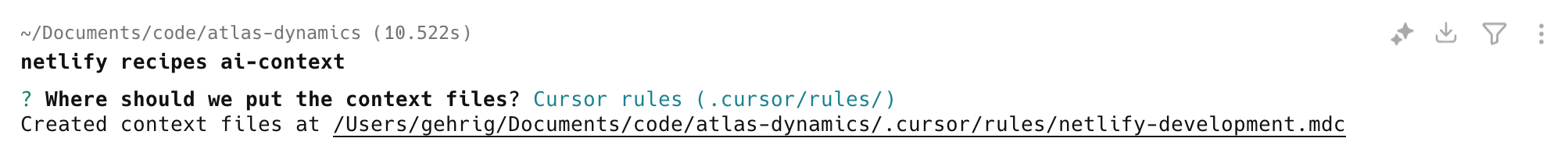

Here’s how this works with Netlify’s Edge Functions. Add context files to your codebase with the netlify recipes ai-context command:
When an AI agent reads our context file, it learns the platform’s patterns:
