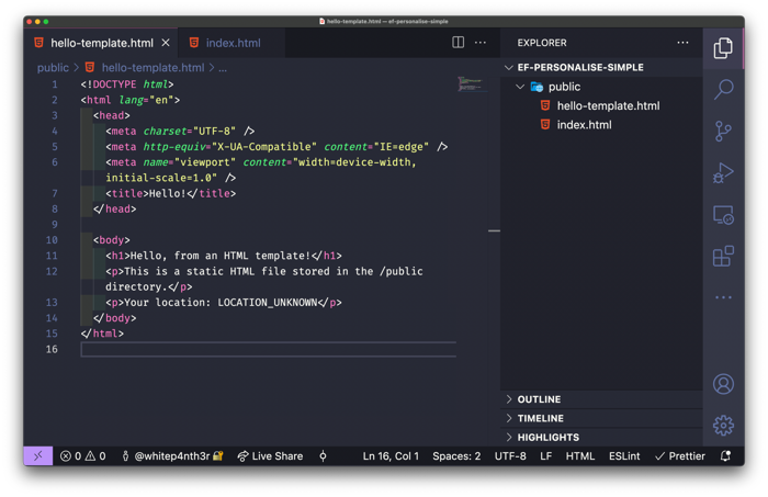

In a new project directory, create a public directory. And inside that, add an index.html, and a file named hello-template.html.
Add some basic boilerplate to the index.html file (if you’re using VSCode you can type ! followed by tab in an HTML file to generate some HTML boilerplate), or you can copy and paste the file from the tutorial repository.
Next, add some similar boilerplate to hello-template.html, as well as some placeholder content that we’ll replace using an Edge Function in the next step. We’re going to be replacing the placeholder with some geolocation data, so I’ve named my placeholder LOCATION_UNKNOWN.

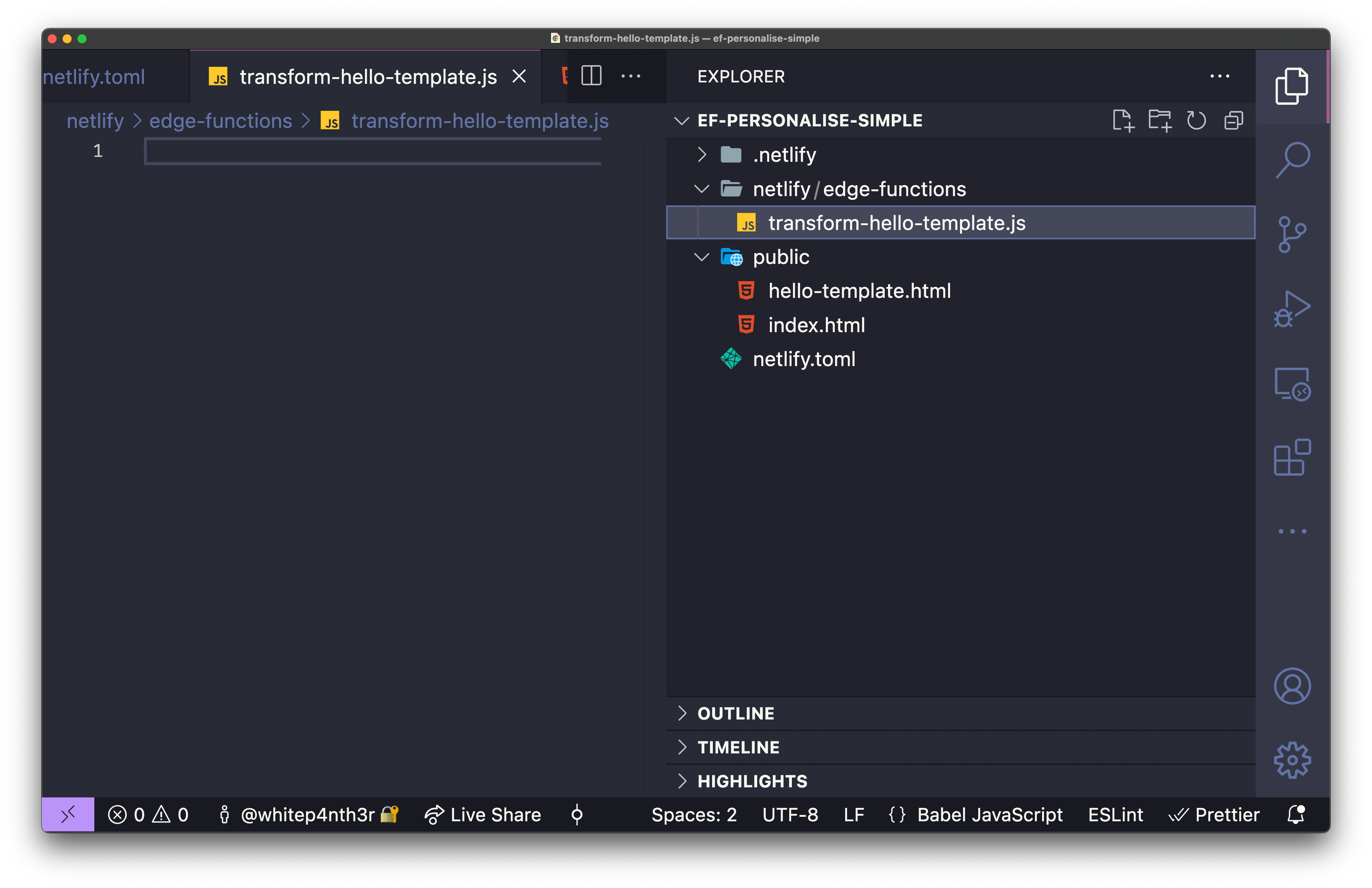

You can write Edge Functions using JavaScript or TypeScript. In this tutorial, we’re going to write Edge Function code in JavaScript. Edge Function files live in a special directory so that Netlify knows how to bundle them when you deploy your site. At the root of your project, create a netlify directory, and inside that add an edge-functions directory. Create a new file inside the edge-functions directory and name it transform-hello-template.js.
Before we write the Edge Function code, let’s wire up the file to the development environment. In your netlify.toml file, add the following code, below the build settings. This tells Netlify to run the transform-hello-template function when a user requests the hello-template page in the browser. Stop and start your development server so the CLI picks up the changes in netlify.toml.

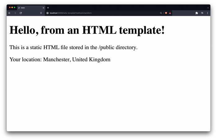

Finally, we return a new HTTP Response containing the updated page. Navigate to the following URL in your browser: http://localhost:8888/hello-template?method=transform — and you’ll see the placeholder updated with Edge-powered geolocation data! Personalization with no JavaScript: achievement unlocked! 🏆
