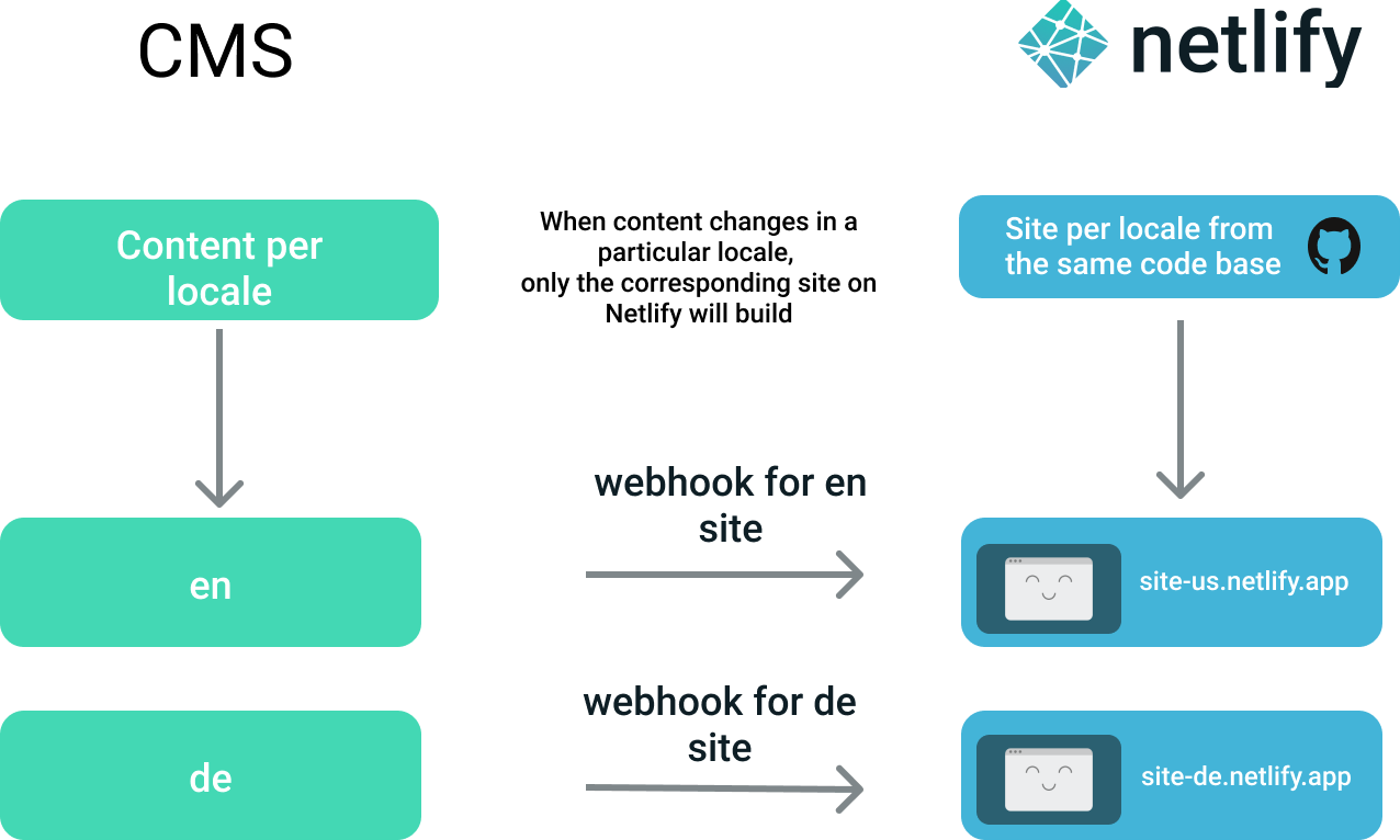

This also assumes you are able to split your content within your CMS for the two specific sites. Typically teams use a translation service like Smartling or Transifex amongst many others that will sync the main language (say, en) to others. When a change is made in the CMS, the service will kick off jobs for the other languages too and keep them all in sync.
This is what the setup looks like.

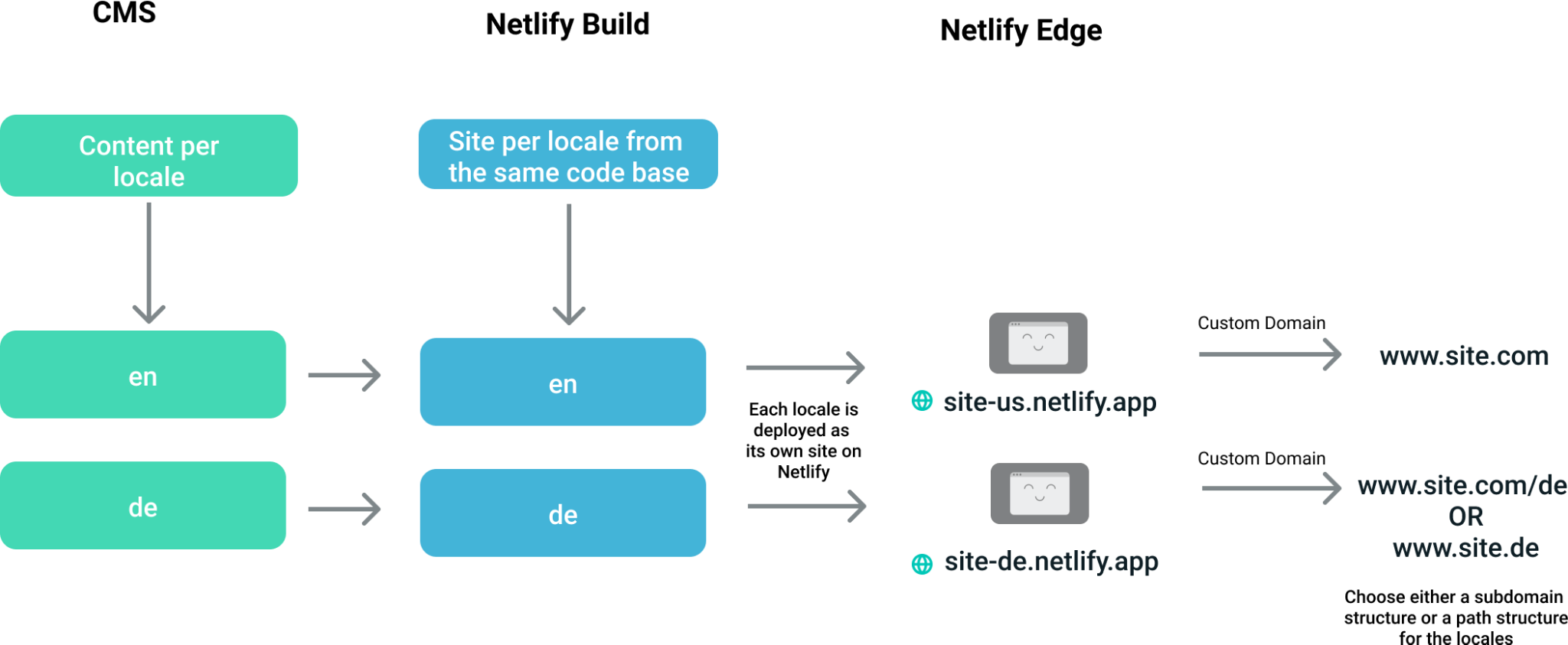

Deploying these locales as separate sites gives you a lot of advantages:.
- By default they come with a
.netlify.appsubdomain, which you can either retain and access the locales at the subpath —- likewww.site.com/enandwww.site.com/dealong with proxy rules on Netlify - Or, you could give it a custom subdomain that can be accessed at
www.site.com,site.de.comand have a subdomain structure for the sites that you can set up using Netlify Redirects. - Containing and managing the builds per site/locale. Changes in a certain locale will only trigger builds in those specific sites, and not all of them. This helps keep your build times in check and also helps push content out quickly.
- Teams have more control over the build/deploy workflow per site. As your company scales internationally, new sites can be spun up with minimal fuss and without touching the existing sites.
- Per locale, you can even spin up multiple lower level environments like staging, UAT, etc and there will be a clean separation of the environments for you to test on.

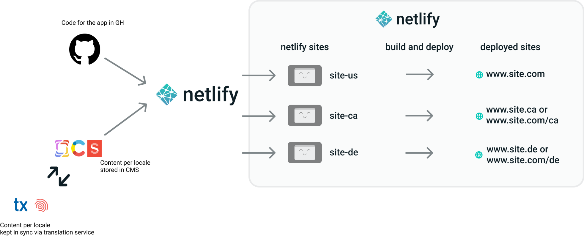

Ultimately, this is how the workflow for building and deploying your sites will come together:.

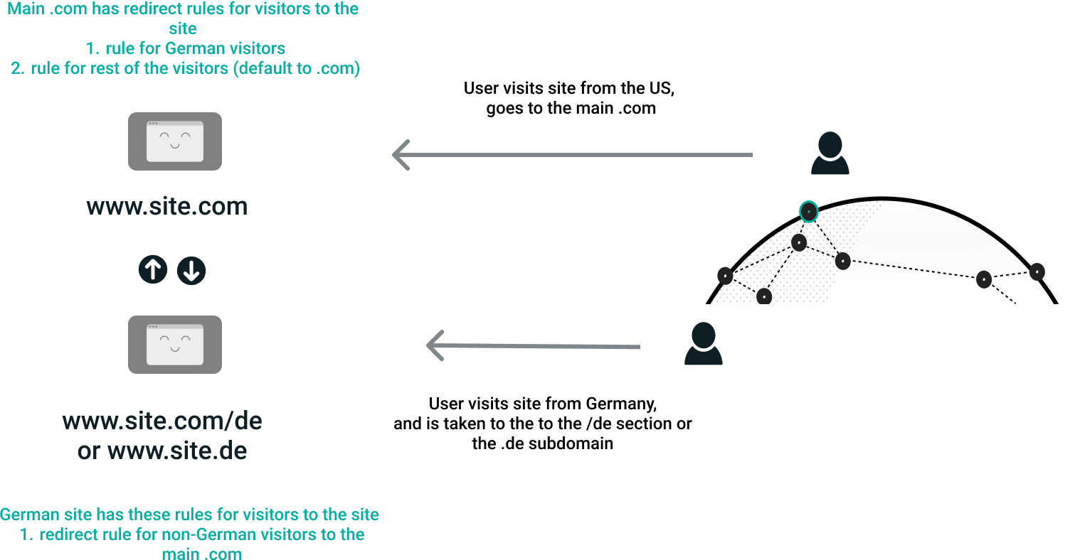

From a user perspective, you can ensure that the experience between locales is seamless.
- The first thing you need to know is the user’s location, so that the right site can be served. The user’s location is determined from the browser settings or can be overridden using JS when a user clicks on a specific locale.
- Next, you will have to add rules to the Netlify edge that will ensure the user is taken to the right site, the main
.comor the.desite based on their location. For this, Netlify Redirects and Proxies can be set up at the edge.
If you want to redirect the user to the .de subdomain (de.site.com), then you’ll need rules like this in the netlify.toml file of your main .com domain:
# A redirect rule with many of the supported properties
[[redirects]]
from = "/*"
to = "/de.site.com/:splat"
status = 301
# By default, redirects won’t be applied if there’s a file with the same
# path as the one defined in the `from` property. Setting `force` to `true`
# will make the redirect rule take precedence over any existing files.
force = true
# Redirect based on conditions including browser language, geolocation,
# identity role, and/or cookie presence.
conditions = {Language = ["de"], Country = ["DE"]}
If instead you want to proxy content from the /de folder instead, you can write a rule like this:
/de/* /site-de.netlify.app 200 ---> This will proxy content for the /de path from the de specific site on Netlify
Sometimes, within a region, you might have language specific localization. For instance, a Canadian site might have both French and English versions, say www.site.ca/fr and www.site.ca/en. In this case, you can have one root site, such as www.site.ca that will serve the /en content, and another Netlify site for the /fr content, say site-fr.netlify.app that you can proxy all the /fr routes to.
Another option here is to have the following structure: site.com/ca/fr/ and site.com/ca/en which you can also support with Netlify language based redirects.
