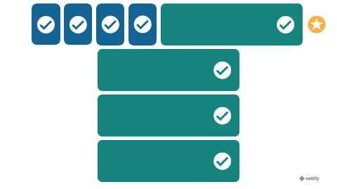

Each of the new blocks in this diagram is a new page that is built at runtime and added to the “stack.”

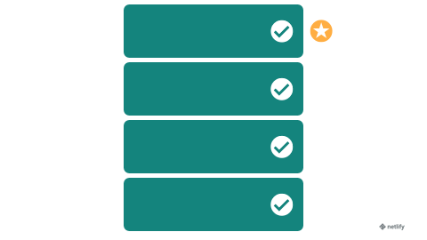

If you rollback your site to a different deploy, because your page is cached separately from the bundle, it could exist in a different state for your user than expected. It could be the old version of the site, the new version, or some funky in-between cached version trying to revalidate itself. And unfortunately, debugging this is difficult, because different users (and the dev team!) would see different pages, and it might be difficult to duplicate.
Notice how in this graphic, the pages that are cached separately stick around with their nice big checkmarks, while the rolled-back page is no longer the shipped deploy. If the users navigate to those cached routes, they might see out-of-date data.
