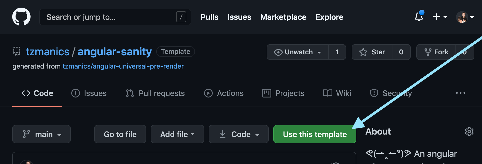

git clone https://github.com/tzmanics/angular-sanity
Or we can click the ‘Use this template’ button from the repo’s homepage.

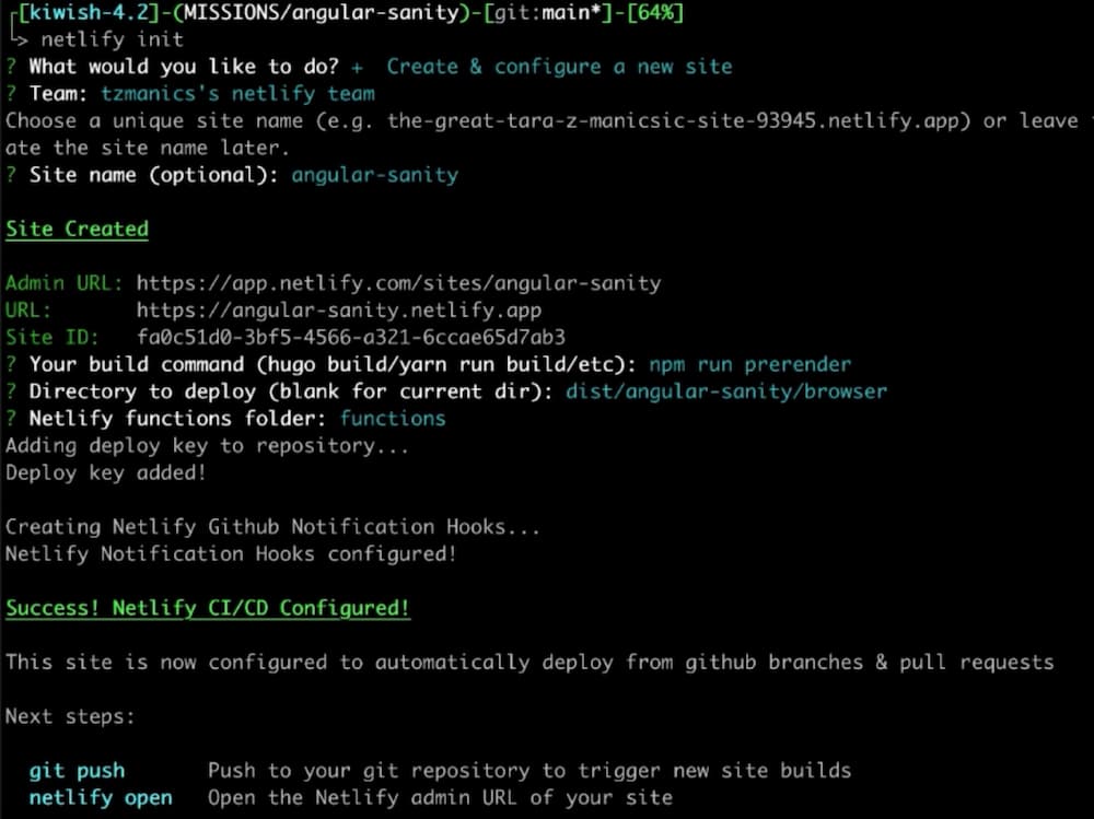

Deploying the Project to Netlify
We can now hook this site up to Netlify so whenever we push a new commit it will trigger a new deploy (CI/CD). Having it live we can see what our users will experience when they request the site. The template project already has a Netlify configuration file, netlify.toml. We can just run a few commands using the Netlify CLI.
npm install netlify-cli -g
netlify login
netlify init
First, we install the Netlify CLI globally (if we don’t already have it installed) and log in (unless we’re already logged in). The netlify init command will ask a few questions and set the command and publish settings with the project’s netlify.toml file. This command will also trigger a deploy of the project. We can run netlify open to get to the project dashboard, to see when the build has been published.
Once this is set up, we can commit the changes we made when we changed this project name.

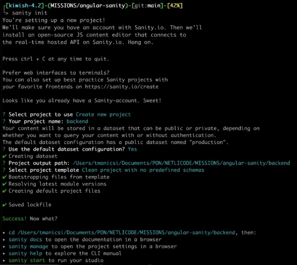

Now it’s time to set up the Sanity.io instance locally. We can do this with the Sanity.io CLI first by installing the CLI tool then initializing a Sanity.io project:
npm install -g @sanity/cli
sanity init
When we run sanity init it will make sure we’re logged in (and have an account) then it will step through prompts to set up a new project.
We’ll create a new project and name it backend, say yes to the defaults, but use the Clean project with no redefined schemas. Using the clean product will allow us to write custom schemas without too much overhead that may be confusing.
Change into the Sanity.io instance backend folder and run sanity start to start the UI up locally.
cd backend
sanity start

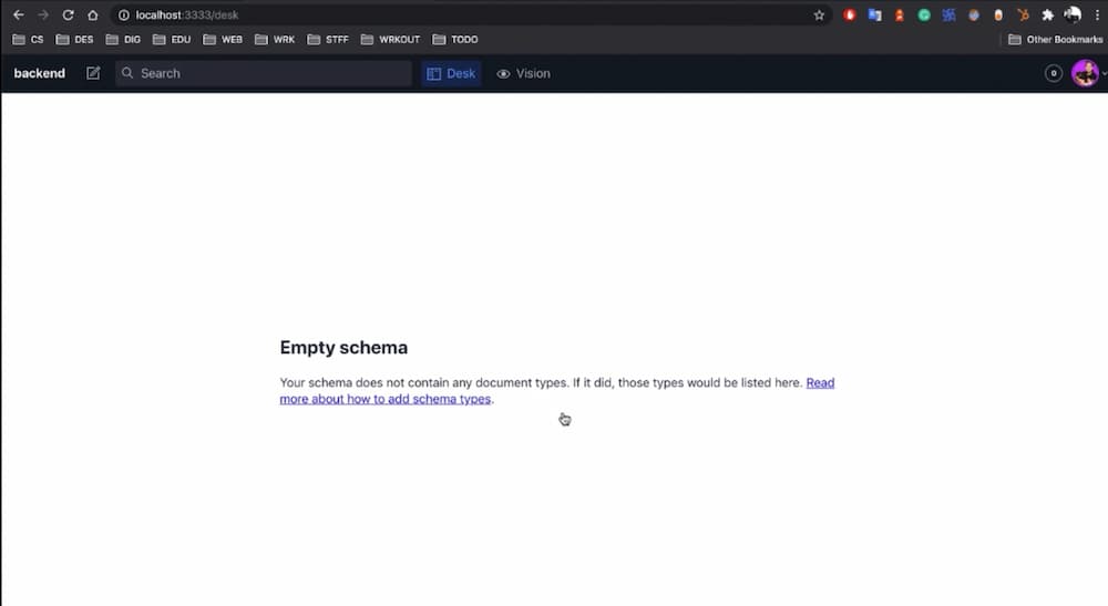

Then head to http://localhost:3333/ to see what we have to work with. It’s nothing. This is right because we haven’t added any schemas yet!

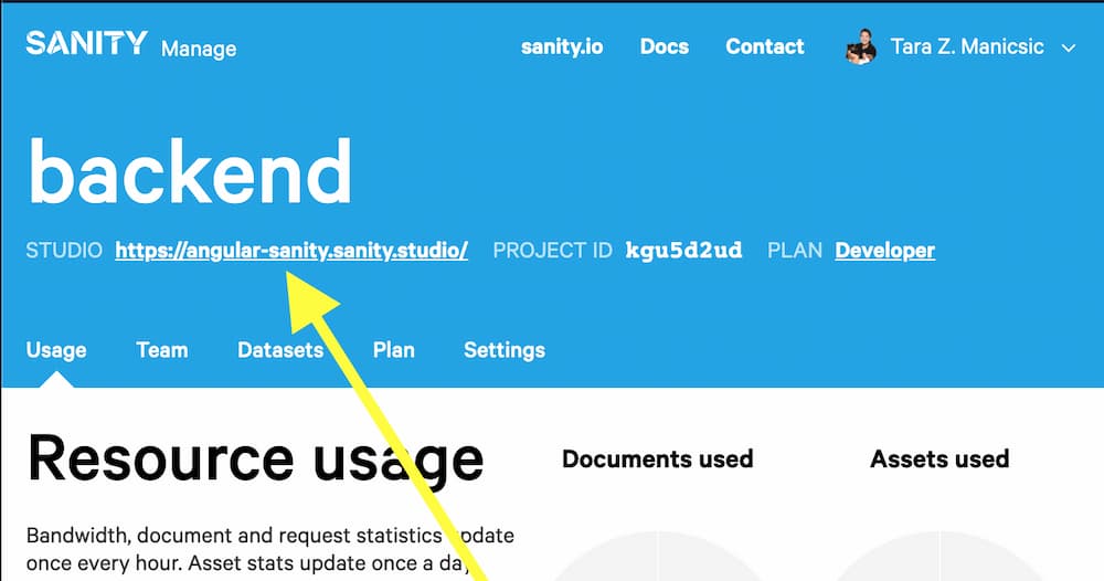

Deploying the Sanity.io Desk
Although we can host our Sanity.io instance on Netlify, I want to show the built-in way. From the terminal, we can run sanity deploy and it will prompt for a name then set the live instance at https://.sanity.desk. Once made, this information can be found at the top of the project page at sanity.io.
Anytime we want to update the deployed version of the Sanity.io instance, we’ll need to run the sanity deploy command again.

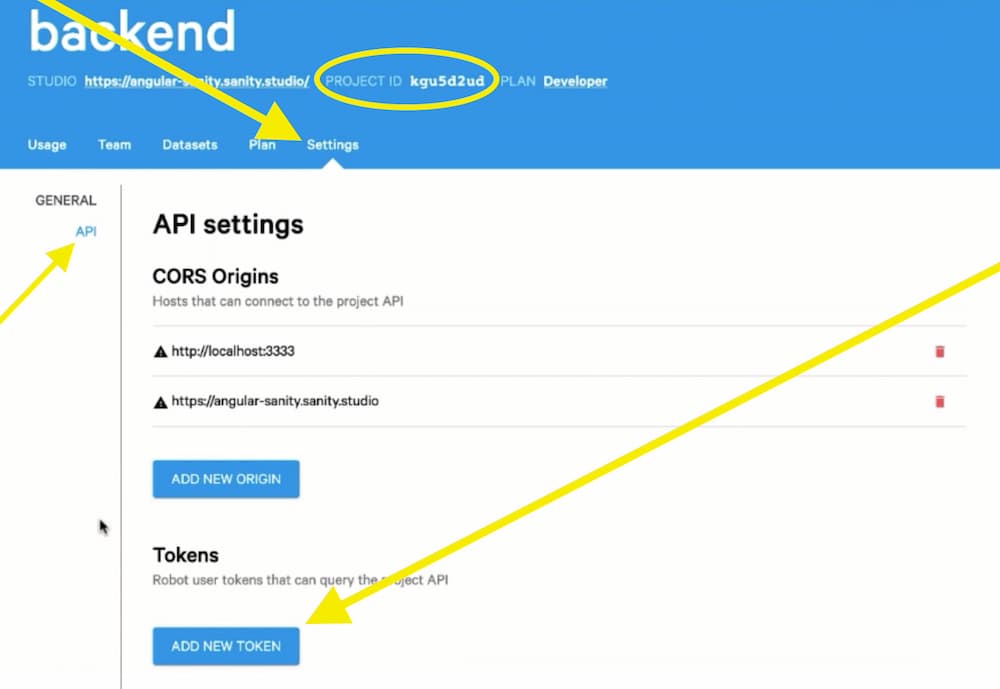

Adding Sanity.io Environment Variables

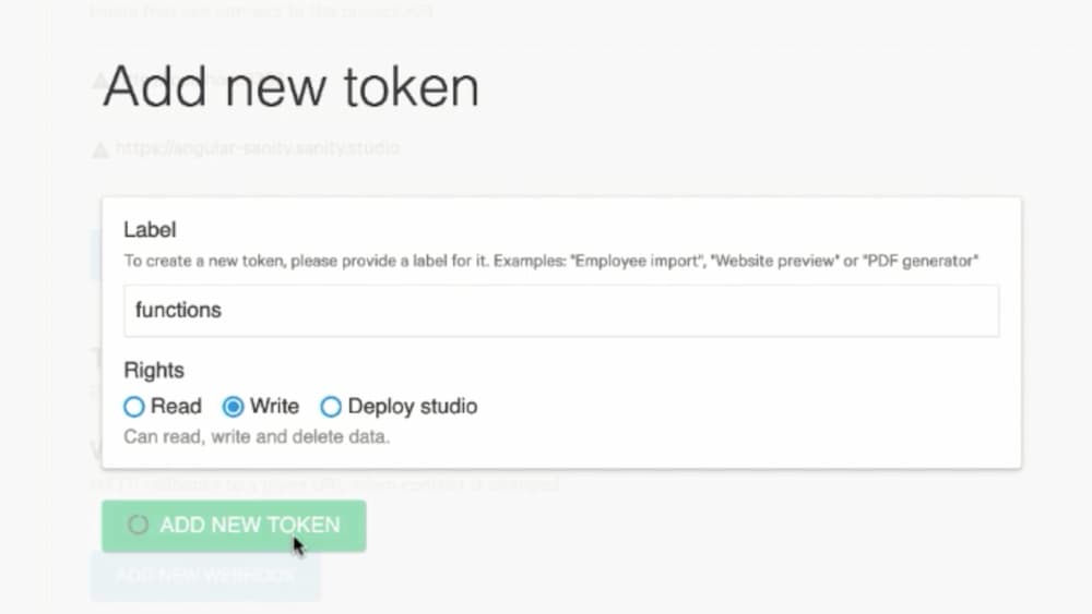

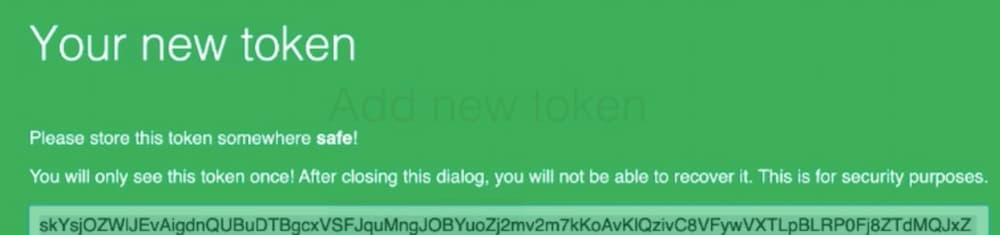

To connect to the CMS, we’ll need to use some project credentials: the project id, dataset, and a token. We can grab this information from the project’s dashboard. First, the project id is at the top of the page and we know we are using the ‘production’ data set. To get the Sanity.io token we’ll go to Settings/API/Tokens and click the ‘Add New Token’ button.
Then, we’ll name the token ‘functions’ and give it rights to write (which includes read, write, and delete data). When we click the ‘Add New Token’ button, we’ll get a token to copy.

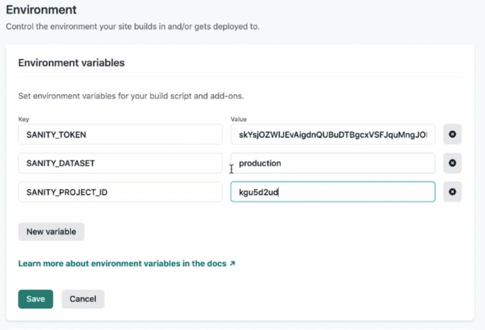

Next, we’ll head back over to the project’s Netlify dashboard to enter these values. Go to Site settings/Build & deploy/Environment and click the Edit variables button. We will add the following variables:
SANITY_TOKEN= (the token we just created and copied)SANITY_DATASET= productionSANITY_PROJECT_ID= <your project id (e.g. kgu5d2ud)>

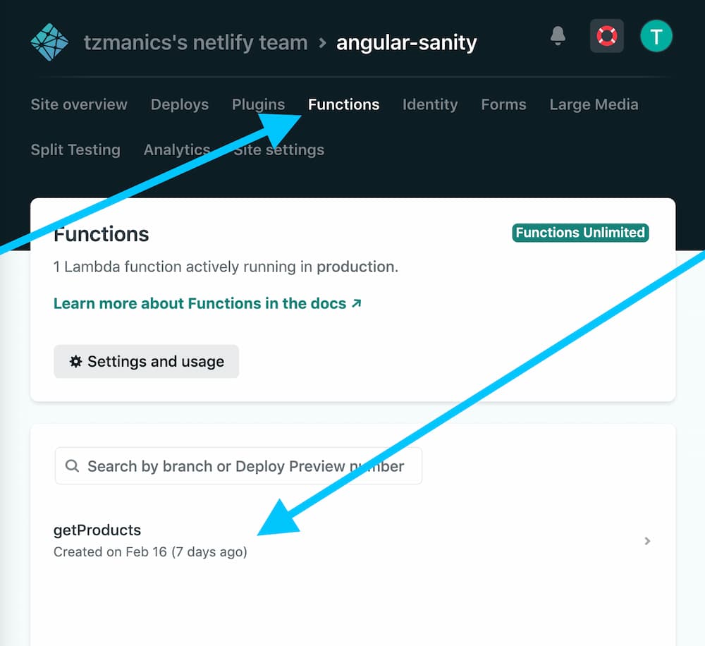

We have everything in place to actually make a serverless function to grab the CMS data. Woohoo! Let’s get coding.

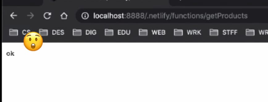

Testing Locally
Through the Netlify CLI we can start up a local development environment by using the netlify dev command. Before we run that, let’s set local build settings for command and publish for the dev environment in the netlify.toml configuration file.
[build]
command = "npm run prerender"
functions = "./functions"
publish = "dist/angular-sanity/browser"
[dev]
command = "npm run start"
publish = "src"

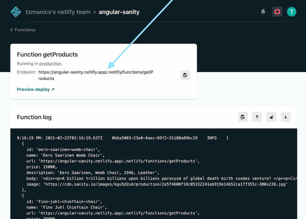

Now when we run netlify dev, we can head to http://localhost:8888/.netlify/functions/getProduct to see the output from the test function: ‘ok’. Riveting, I know.
📓 Here’s a blog post on getting started with Netlify Functions if you want to learn more about what’s going on here.

return allProducts;
return {
statusCode: 200,
headers: { 'Content-Type': 'application/json' },
body: JSON.stringify(products),
Live Logs & Results
Once we have our function live, where do we find the logs? Netlify has a dedicated section for the functions to make them easy to keep track of and manage. From the project dashboard, there is a ‘Functions’ tab where we can see all the functions listed that the project uses.
To deploy the updated function we can git add, commit, and push the changes. The new build will be triggered and if we go to https://angular-sanity.netlify.app/.netlify/functions/getProducts we can see the output on the page and in our logs.
Functional Function Finita!
We have a template site set up, a customized instance of Sanity.io, and a function that’s grabbing our CMS data! We are so skilled! In part two of this tutorial, we’ll use add an Angular service and component to integrate this data into the site. Then we’ll set up a Build Hook so that we re-deploy the site with the newest data as soon as it’s entered. I hope to see you there and until then, happy coding 👩🏻💻
