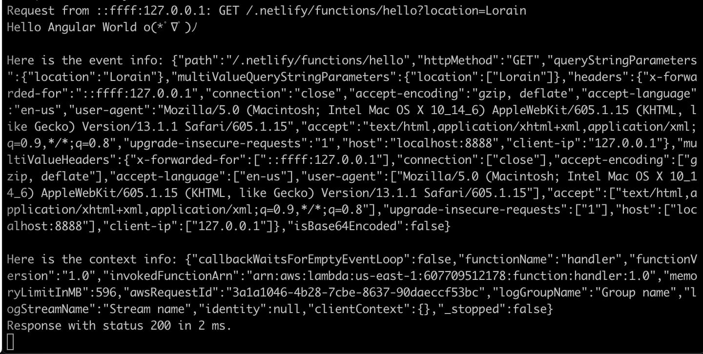

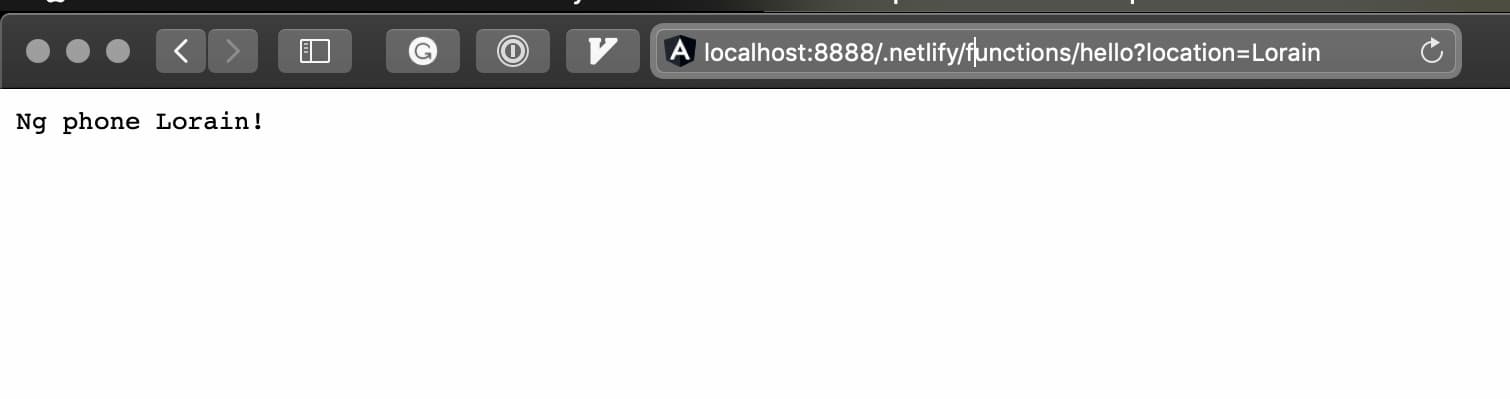

To trigger the function, we want to hit the endpoint where the function lives (.netlify/functions/hello). This will change based on what you named your function (but not what directory you saved it in as Netlify will always hold it in .netlify/functions). So, if it was a different name the endpoint would be /.netlify/functions/my-netlify-function.
We will also pass the query parameter location and set it like so:
http://localhost:8888/.netlify/functions/hello?location=Lorain
The functions logs will be displayed in the terminal so we can now see the objects we get for event and context.

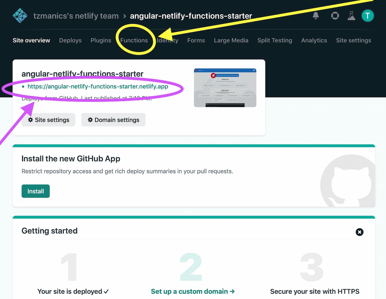

The easiest way to get this project deployed is to run netlify init from the root directory. This command will walk through the process of connecting the project to Netlify, deploying it, and setting up continuous deployment if we have a git repo hooked up to the project.
netlify init

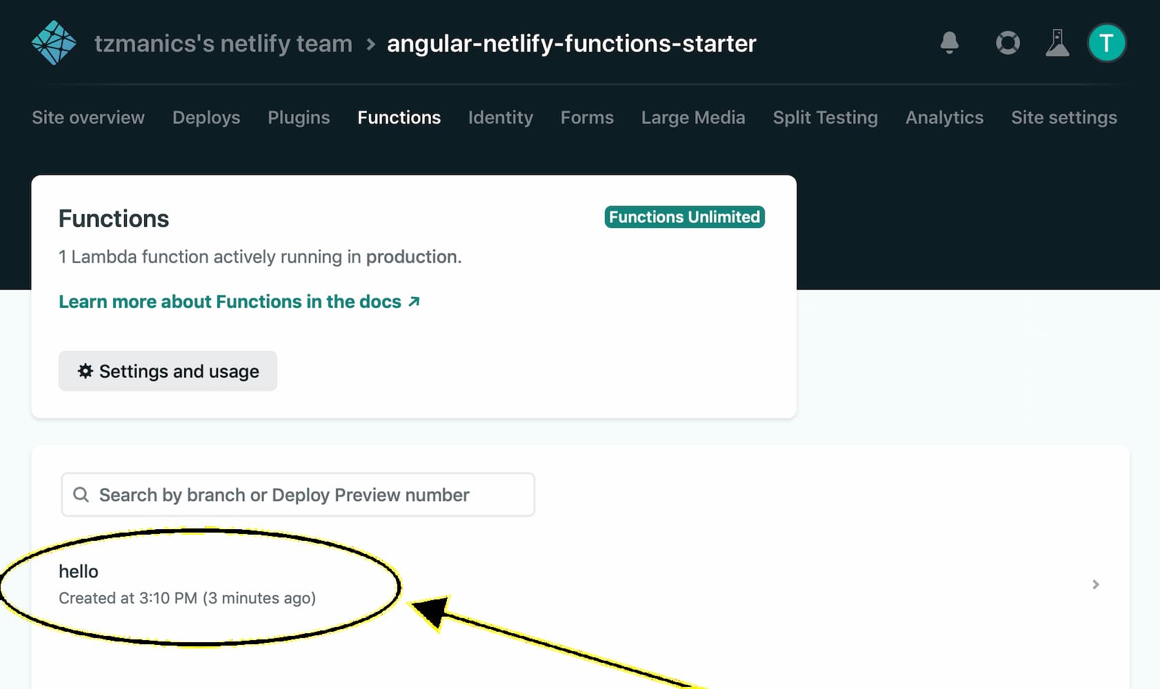

Once that’s set up we can run netlify open to see this project’s dashboard. Here we can find the link to our live site as well as the link to our ‘Functions’ dashboard.

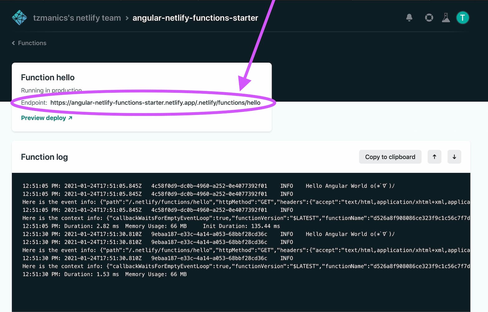

Moving to the Functions dashboard, we can see our new ‘hello’ function listed and click it to look at the information and logs for this function.
The ‘hello’ function’s dashboard will list the endpoint for our function and also list all of its logs.

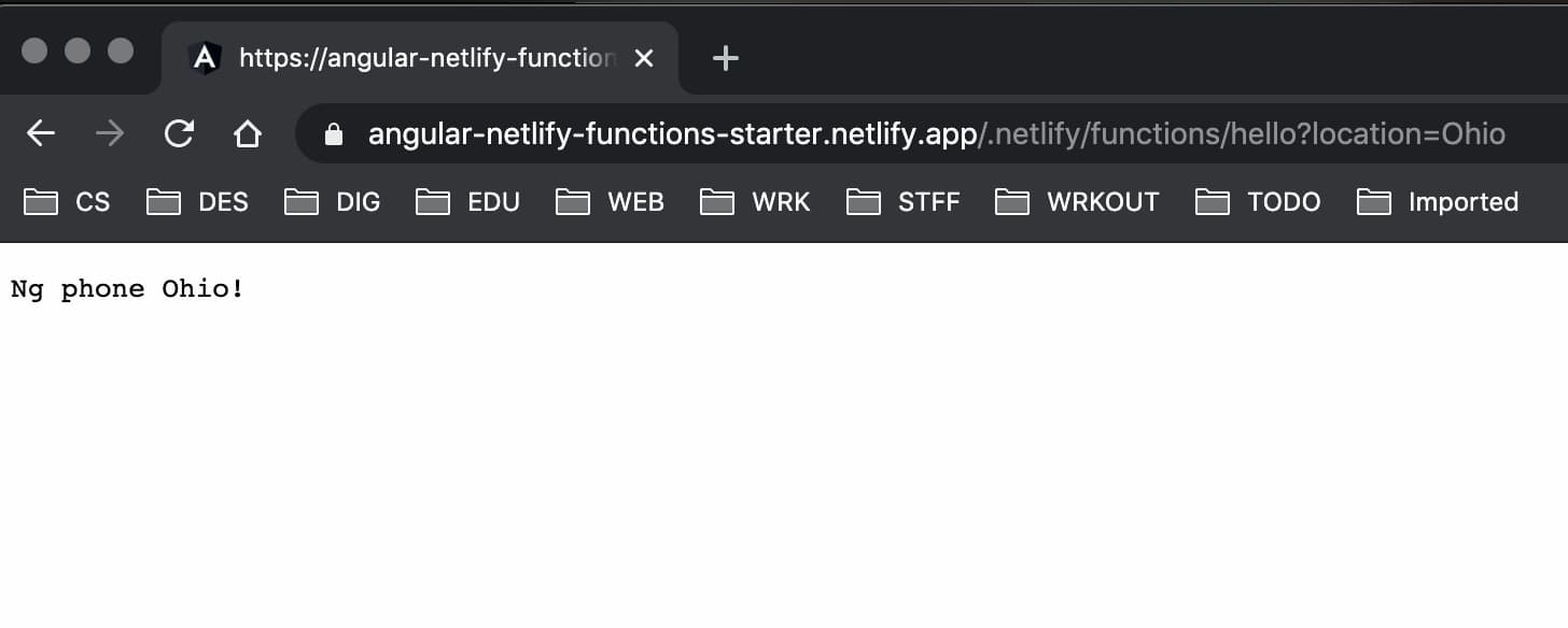

We copy the endpoint then add the location parameter like so:
https://angular-netlify-functions-starter.netlify.app/.netlify/functions/hello?location=Ohio
