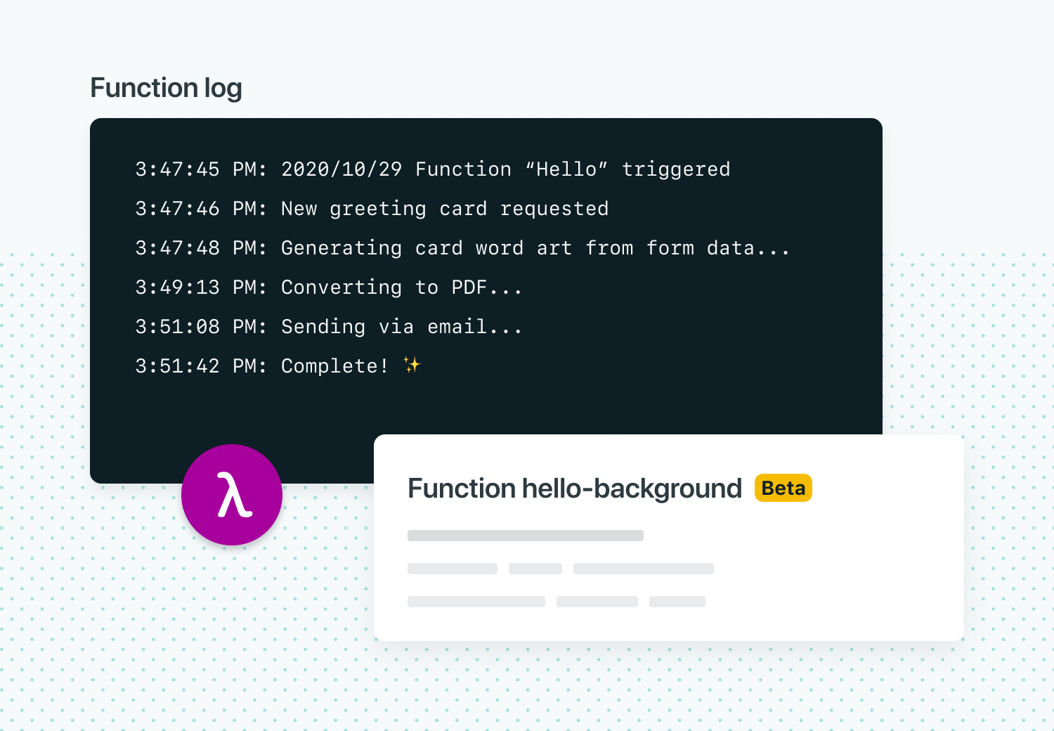

However, if you change the name to
hello-background.js
It will deploy as a background function that returns an immediate client response on successful invocation, then continues running in the background until it completes asynchronously — up to 15 minutes later.
