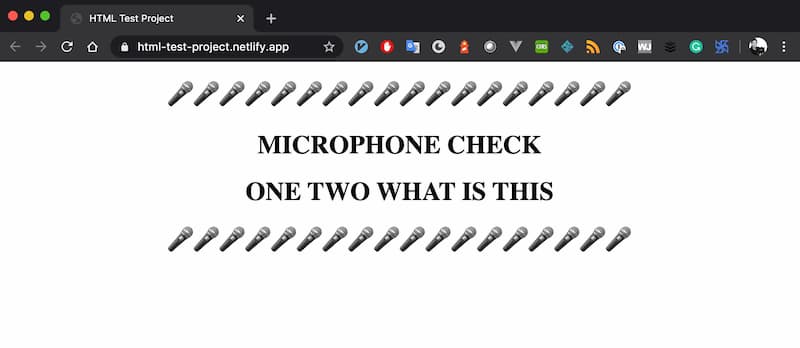

Speaking of code to run it on, we’ll need a test project to sic our Build Plugin on. Since we’ll mostly be logging information to see how the plugins work, a simple, single index.html site with a netlify.toml Netlify configuration file will do. Wouldn’t you know it, we have one right in the example build plugin folder: 🐙 here is the link to the example site’s folder.
This project is a thing of beauty, I know.

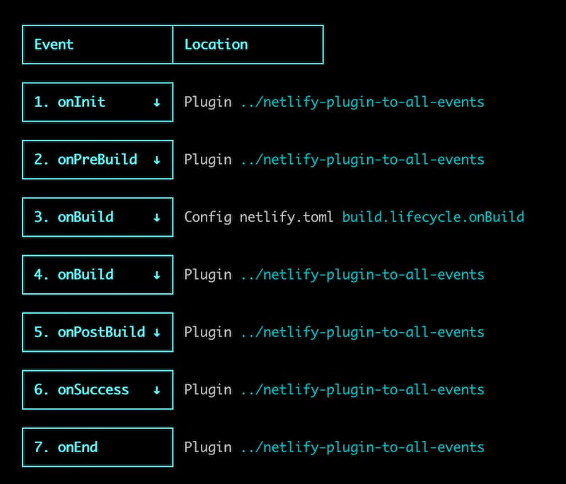

Now that we have the plugin added to our project why don’t we dry it out, ahem, I mean try it out with the netlify build --dry CLI command. This command will just show us that there is something that is listening to each build event. Since we’re using the --dry flag it’s just a summary and won’t actually follow-through on the actions that would be triggered by the build events (it’s not actually running the build.)
cd test-project/
netlify build --dry
This output confirms that our Build Plugin is being triggered at all the build events. We can now turn this into a real build, Pinocchio. To do this we’ll just drop the --dry flag.
🔑 Bonus tidbit: if you get tired of typing
Netlifyin the CLI you can type the shorter version,ntl!
ntl build
One thing you may notice from these logs is that the output for onError didn’t show up. That’s because we had no errors, woohoo! Later on, we’ll intentionally add an error so we can see this event triggered and look into how to handle errors.

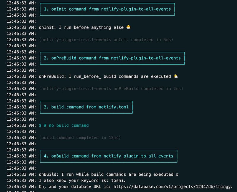

Accessing User Input
With everything properly declared we can now use inputs inside of our Build Plugin. We can pass the inputs object as a parameter to whichever event we plan to use it in. We have the option of either passing in the whole inputs object or a specific input. Here’s what it looks like for each of those scenarios:
// index.js
onPreBuild: ({ inputs: { keyword } }) => {
console.log('onPreBuild: I run_before_ build commands are executed 🌤');
console.log('I will only use the keyword input: ', keyword);
onBuild: ({ inputs }) => {
console.log(
'onBuild: I run while build commands are being executed ⚙️'
console.log(`I also know your keyword is: ${inputs.keyword}.`);
console.log(`Oh, and your database URL is: ${inputs.databaseUrl}.`);
🐙 This link takes you to the commit where we added inputs to the
onPostBuildevent

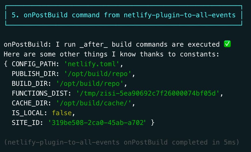

Netlify Constants
Netlify isn’t going to send us on our Build Plugins journey empty-handed. This isn’t an episode of Survivorman. Netlify provides us with accoutrements called [constants]. Just like inputs we can pass these constants as an object or individually into our events. Here’s what we have to work with:
CONFIG_PATH: the path to the project’s Netlify configuration filePUBLISH_DIR: the directory the user lists to publish their project fromBUILD_DIR: the directory that contains the files and assets generated by the buildFUNCTIONS_DIST: the directory of Netlify Functions source codeCACHE_DIR: where the project’s cache will liveIS_LOCAL: a boolean signifying if the build is local or notSITE_ID: the project’s Netlify site ID
Let’s go ahead and add some constants to our code in the index.js file.
onPostBuild: ({ constants }) => {
console.log( 'onPostBuild: I run _after_ build commands are executed ✅');
console.log('Here are some other things I know thanks to constants:');
console.log(constants);
If we run ntl build now we’ll see all the constants and their values for our test project.
These logs are from the deployed version of the test project. The SITE_ID has been edited because it’s sensititve information and not everyone out there is as nice as you 😘. The other values are the true, unedited information. We can access this individual information for each project that uses our plugin. In another plugin I built, Brand Guardian, I use the PUBLISH_DIR to get the route to all project’s HTML files and check for spelling errors of uniquely spelled brand words.

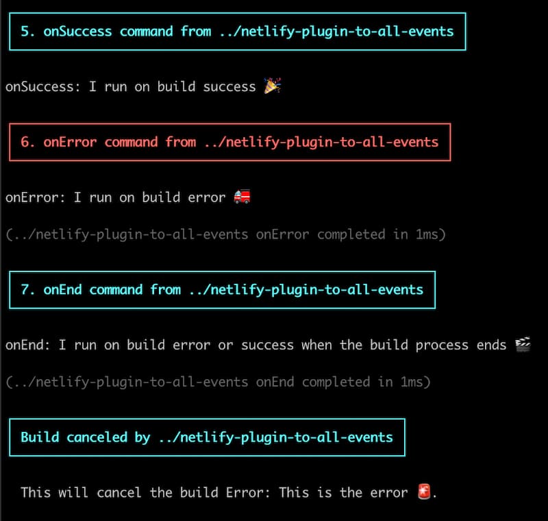

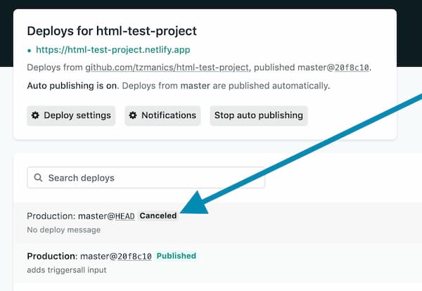

In our Build Plugin we can add an error handler like so:
// index.js
onSuccess: ({ utils }) => {
console.log('onSuccess: I run on build success 🎉');
try {
throw new Error('This is the error 🚨');
} catch (error) {
utils.build.cancelBuild(`This will cancel the build ${error}.`);
There’s a lot going on in these logs. First, we see that onSuccess was triggered because technically the build happened before we triggered an error so the build was successful. Because we triggered an error we finally got to see the, hopefully often elusive, onError event get triggered. The very last line we see the main event, the message that the build has been canceled along with the error we passed in. If we run this on a deployed application the build will also show up as canceled in thr deploy dashboard.
🐙 In this repo commit we add the different types of error handling to the Build Plugin.
