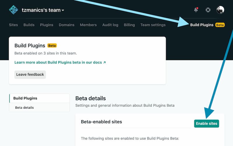

How to Enable Netlify Build Plugins
Let’s get things started with an easy win: enabling Build Plugins for a project. At the top of the team or project page there is a ‘Build Plugins Beta’ button. Click that to head to the Build Plugins page. Here we can find a button that says ‘Enable sites’, pick from our project list and select one or multiple sites. Then click the ‘Enable’ button and they will show up on our list of ‘Beta-enabled sites’.

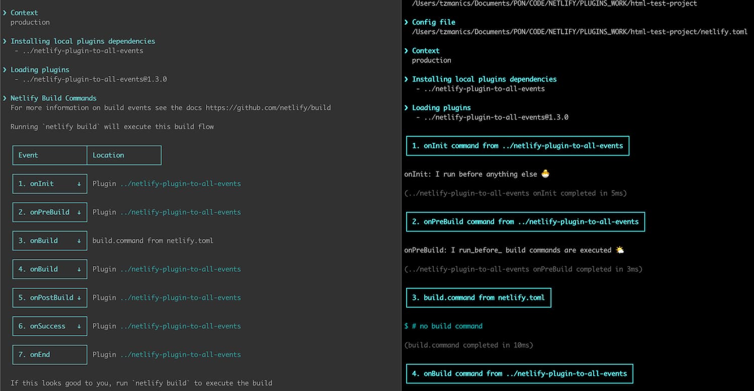

With that, we have all the code to let Netlify know that we are incorporating a build plugin into our project. If we were to trigger a build with this added to our project this is what our logs would look like:

Local Build Commands
Using the Netlify CLI we can get a preview of the build process. There are two ways of doing this:
netlify build --dry: show you a summary of what the build will do at each stage without running a full buildnetlify build: will execute a build locally and output all the logs
Here’s a side-by-side snippet of the logs:
We are all setup to run Build Plugins locally.
