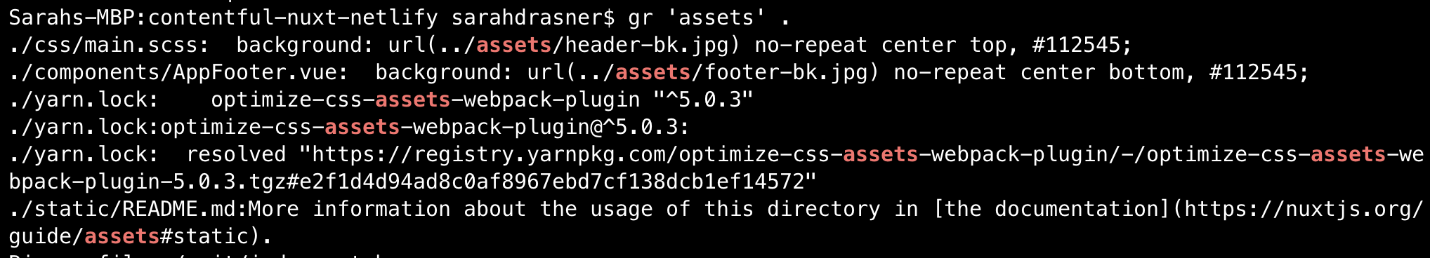

Search for Strings Bash Alias
It’s fairly common that I want to look for a certain incidence of a string within a repo or project. This handy tool lets us find all of the matches for that string in a given directory. You can use a dot for the current directory, or the name of the directory otherwise. The -r flag searches recursively through all the inner directories, and the --color will colorize the term you’re searching for in each line so you can see it more clearly
Here’s what I use:
alias gr='grep --color -r'

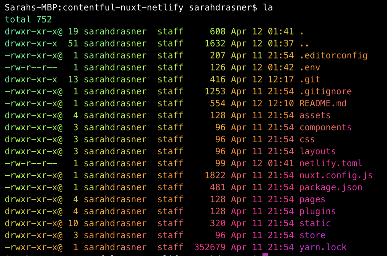

Make a Rainbow Party in your Terminal, Why Not
When I first created this alias a few years back, a few folks doubted that I could it keep it going for long. Surely, day after day, rainbows would get annoying? I’m happy to report that everyone who doubted me now has this installed. This isn’t surprising when you consider two things: the color actually helps with readability- you can separate the lines and scan more easily when there’s some visual distinction. And also because rainbows are dope.
First we’ll have to install lolcat. If you have homebrew installed, you would run: brew install lolcat
Then in our .bash_profile, we’ll enable the color output and add two different aliases- one for simple ls (I use l, but you could use ls here, too), and one for ls -la which shows hidden files and some more information like when it was created, how many bytes, and so forth. I alias this to la.
#enable color output
export CLICOLOR=1
export LSCOLORS=gx
alias l='ls | lolcat'
alias la='ls -la | lolcat'
Now we have a nice colored output for a lot of file information:
