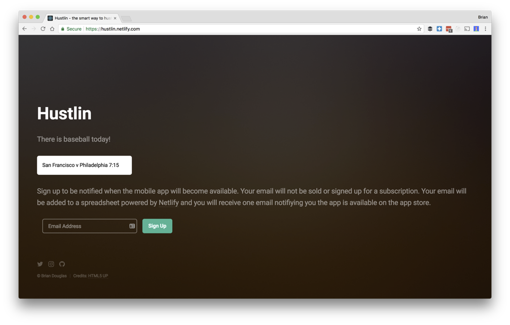

I built an app called Hustlin that knows when there is a home game and sends notifications at the start and anticipated end times. I generated the project really quickly using Ruby on Rails and deployed to production using Heroku.

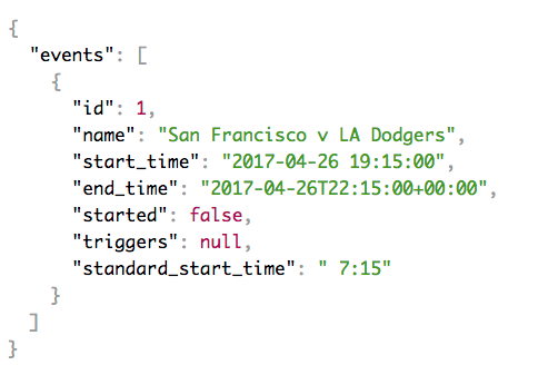

AWS is one of the providers the Serverless Framework works with out of the box and the CLI made it easy to try out. My simple JSON for home baseball games fits nicely in an AWS-provided DynamoDB table. To get started I used the CLI to deploy the node templates.

After creating the boilerplate I created a seed function to move my existing JSON to a DynamoDB table. This was significantly less code than my previous version of Hustlin, it was 102 lines of code to be exact.

This switch has saved me 100% of the $84 a year I was paying previously. Now that I am saving on time and money, I can start working on making this project provide real time notifications during baseball games and really see if that 1 million invocations can be achieved. If you have interest in this project, please keep an eye open for notifications at hustlin.netlify.com for the 2018 season.
