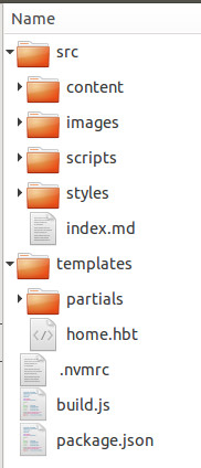

1. Create Folder Structure
We’ll start out by creating a simple folder structure for our project as outlined in the picture below, with a number of files.
Alternatively you can fork a clone of the empty structure here, complete with empty files, ready to be filled in.
We’ll fill in the content of the files in the following steps and more files will be added along the way.
The folder structure for this project:

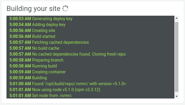

2. Create .nvmrc file
Did you notice the .nvmrc file in the tree above?
The helpful program nvm or node version manager, has a little known feature that’ll help you define what version of node you’re running with your project, by simply adding a file to the root of the project named .nvmrc with the version inside. While you may not be using nvm yourself (you should really consider it), Netlify will use this information when building your site for you.
Since Metalsmith is a little picky with regards to what version of node it works with (anything after 0.12.x should do), we’ll add the newest version number we know is running on Netlify to this file.
To figure out which options we have, we open Netlify’s build image here and from line 95 and down we find the various versions of node available, with version 5.1.0 being the newest.
In the .nvmrc file I write the following and save:
stable
Easy enough. To simply use the newest stable version available on Netlify, we write stable. You could also write 5.1.0, as seen in the build image, but as any newer version should also work flawlessly, we stick with stable.

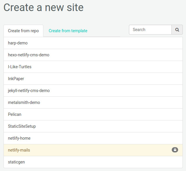

Step 4: Choose Your Repo
Once you’re connected to GitHub, Netlify will show you a list of your GitHub repositories, as seen above. For the purpose of this tutorial we’ll select the “metalsmith-demo” repo we just pushed to GitHub.

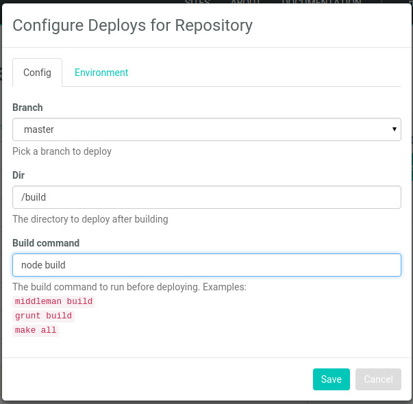

Fill in the configuration settings as seen in the screen shot below:
Click the ‘Save’ button and watch the magic unfold.
Step 6: Build Your Site
Once you click save, Netlify will step in and take over, though it will let you know what’s happening along the way. This may take a few minutes, so take a break and Netlify will do the rest, while you watch the progress.

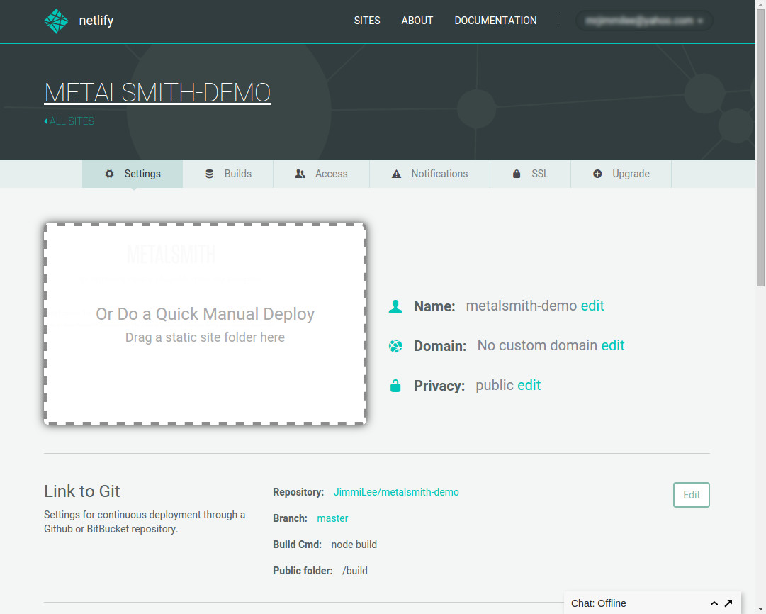

Step 7: The End
That’s it.
Once Netlify has build your site, it will assign a random name to it and you’ll be presented with the site and the control panel for the site, ready for additional customizing.
You can change the site to be private and password protected, which is great for work in progress. You can also assign a custom domain name and it’s easy to change settings for your site in general and gives you a good quick overview.
