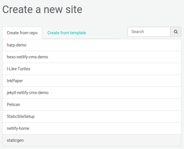

Step 4: Choose Your Repo
Once you’re connected to GitHub, Netlify will show you a list of your Git repos, as seen above. For the purpose of this tutorial we’ll select the “jekyll-netlify-cms-demo” repo we just pushed to GitHub.

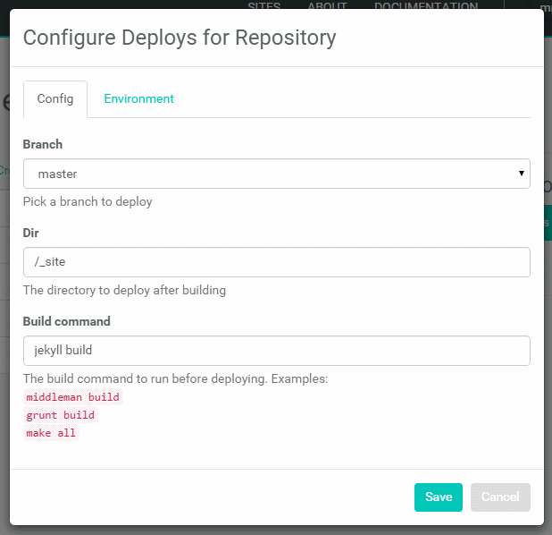

Netlify can detect the build command you need with most site generators, Jekyll being one of them:

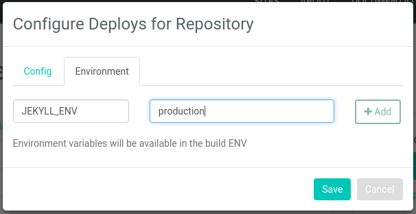

In most cases, there’s nothing we need to configure, but for this build we need to set an environment variable under the environment tab, as seen below:
Take care that it’s spelled exactly like shown, with capital letters on the left and normal letters to the right, like this:
JEKYLL_ENV = production

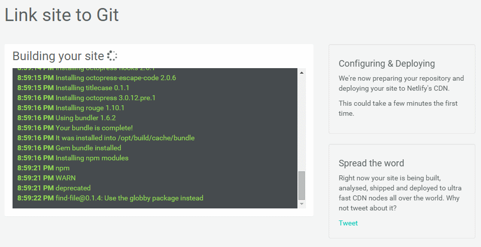

Step 6: Build Your Site
Once you click save, Netlify will step in and take over, though it will let you know what’s happening on the way, as seen in this screen shot:
Now it’s time to sit back and relax, as the next step may take a few minutes. Take a break and Netlify will do the rest, while you watch the progress.

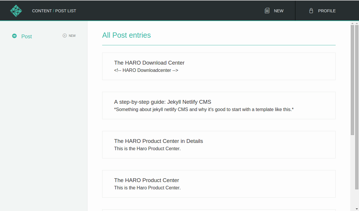

Step 9: Trying Out Netlify CMS
We tried testing the CMS system locally earlier in this guide and it’s virtually the same using it online, you just have to change the address to https://mysite.netlify.com/admin to access the CMS system and then log in with GitHub, since we’re using GitHub auth when working online.
