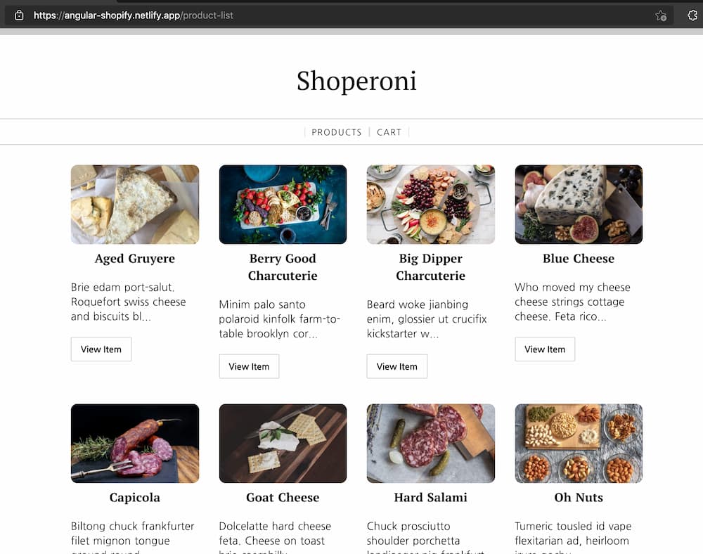

- Grab products from Shopify for the main products page

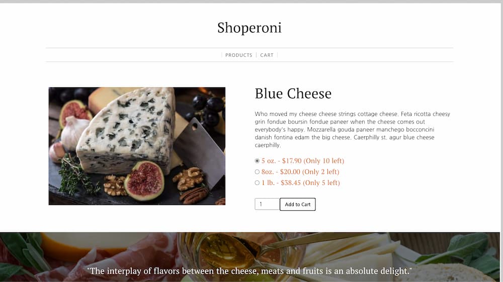

- Loop through the products in a details page that uses the product title as the route
- Add radio buttons for products with multiple variants

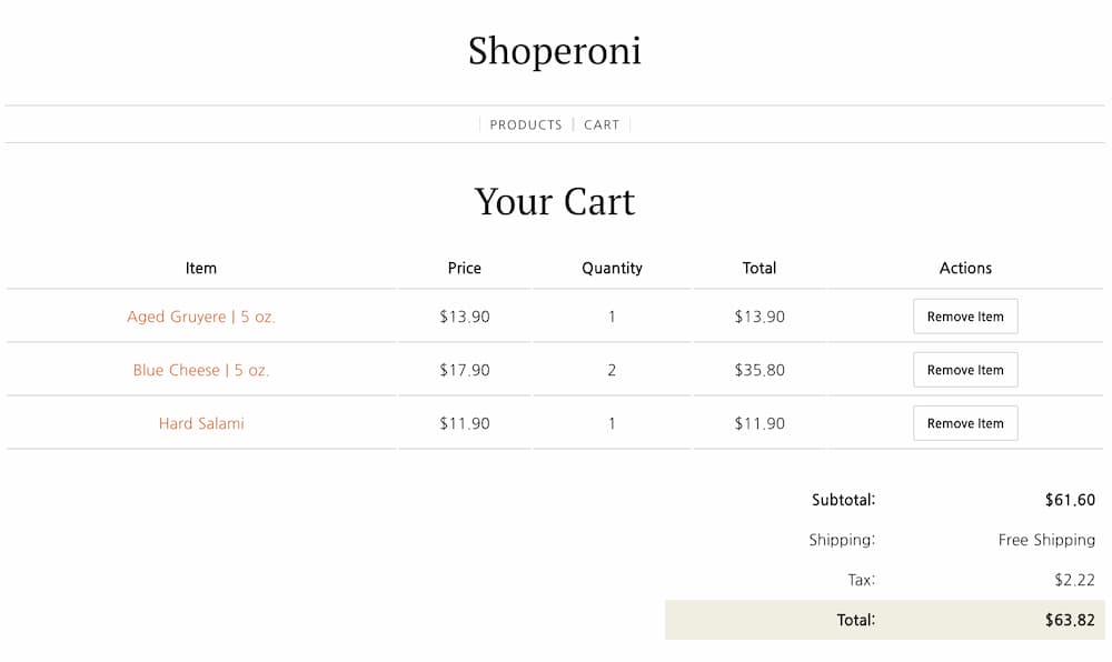

- Utilize the Shopify cart to add and remove items and
- Add taxes and shipping to show the user the total amount
