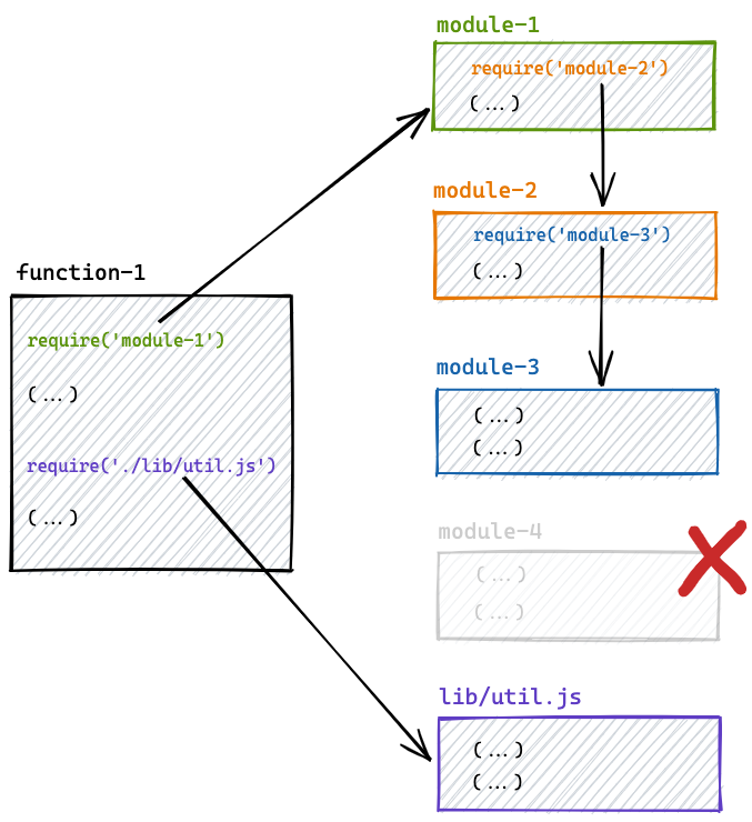

If we look at a function, how do we find all the files and libraries that it uses? Simply packaging up the function’s directory doesn’t work, as it may be using files from a parent directory or a Node module inside a node_modules directory somewhere in the file system.
A better approach is to find every require and import call in the code and mark each referenced file as being required for the deployment. We must do this recursively, such that if a function requires module-1 and that module requires module-2, both modules need to be part of the deployment. This process must be repeated over and over again, until there are no more references to go through.
At the end of this process, we can discard any files or modules that weren’t visited during the traversal.

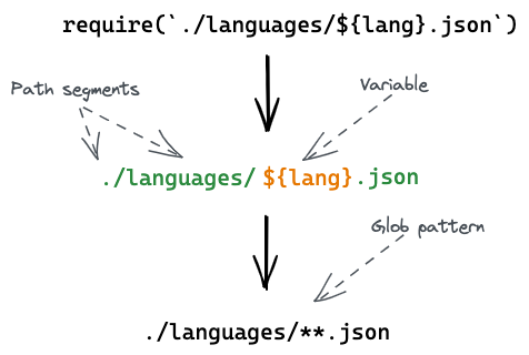

In the case of a reference with a dynamic expression, the ideal scenario would be to look at at the require or import calls and automatically figure out which additional files need to be included in the deployment, without asking the user to explicitly configure it. And that’s precisely what we do when you opt-in to the esbuild bundler.
When zip-it-and-ship-it finds a reference with a dynamic expression, it gets parsed so that we can make sense of its structure. Unlike static expressions, the goal is not to look for the path of the referenced file, which is impossible to know; instead, the system will look for the list of paths that the reference may resolve to at runtime.
Going back to the function above, zip-it-and-ship-it will take ./languages/${lang}.json and infer that, at runtime, this expression can reference any file with a .json extension living inside the languages directory or any of its sub-directories. If we translate this to a glob pattern and add that to the list of included files, our function deployment will have all the files it needs to resolve this expression when the function is invoked.
