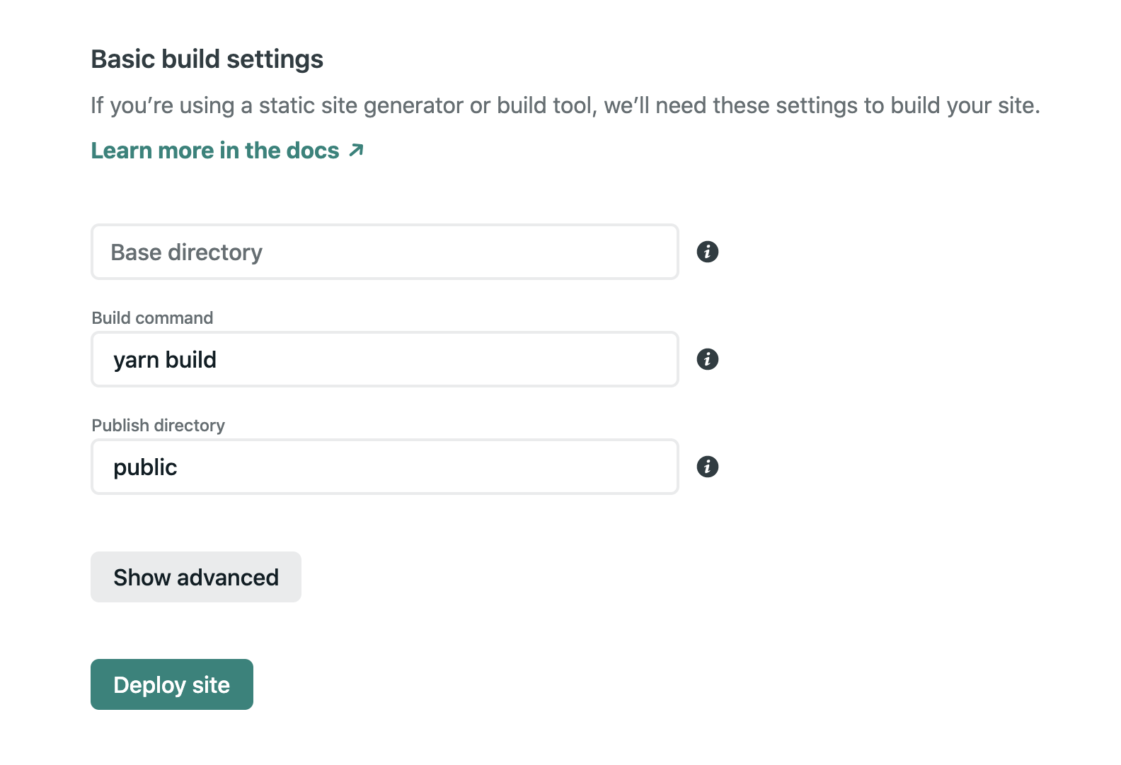

Base directory field in the UI
When you get started with a “New site from Git” you’ll find a new, optional field labeled “Base directory.” Before this field was added in this part of the Netlify UI, your only option was to configure the base directly in the netlify.toml file or to configure it in your Site settings after a first deploy failed.

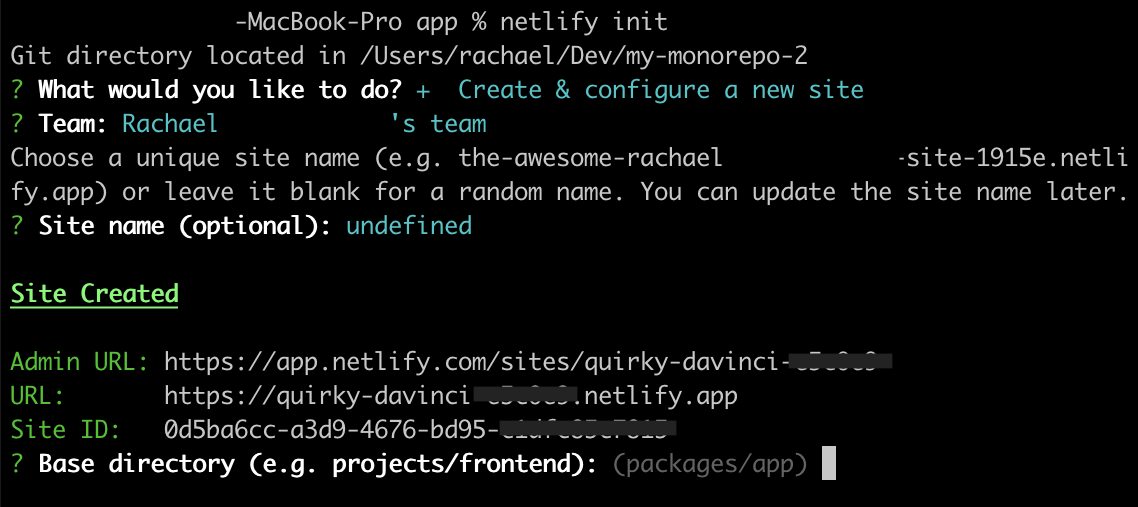

Set the base directory with a command in Netlify CLI
When you run the netlify init command in the CLI from a subdirectory instead of the root of a repository, you’ll be prompted about whether you want to set a base directory.
