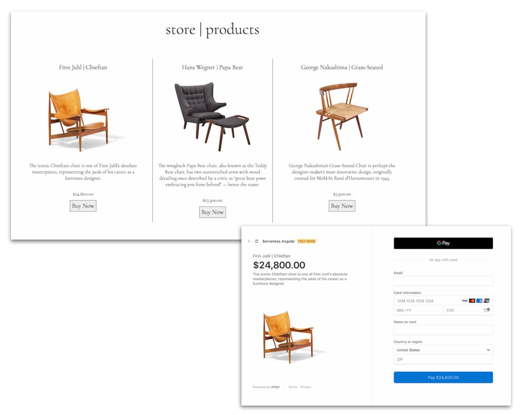

When it comes to eCommerce sites it’s pretty important to have people, you know, give you money. Stripe has a quick checkout process that we can plug into our existing application using a serverless function, like Netlify Functions. Instead of having to code out the whole transaction process, we can send Stripe information about the product the user wants to purchase and let them handle the rest. Words can only do so much, so let’s code this out.
First off, here is what the end product for today will look like: a simple product page with ‘Buy Now’ buttons and the Stripe checkout page the users are sent to for making their purchase.

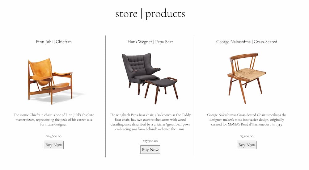

- remove the generated template code, add a header to the main page 🐙
- add and import a JSON list of products 🐙
- iterate over the JSON product list to display the products’ information and add a ‘Buy Now’ button 🐙
- style the page so it doesn’t look so silly 🐙
Here is what this page will look like:
With that in place, we can now add some functionality to that button!

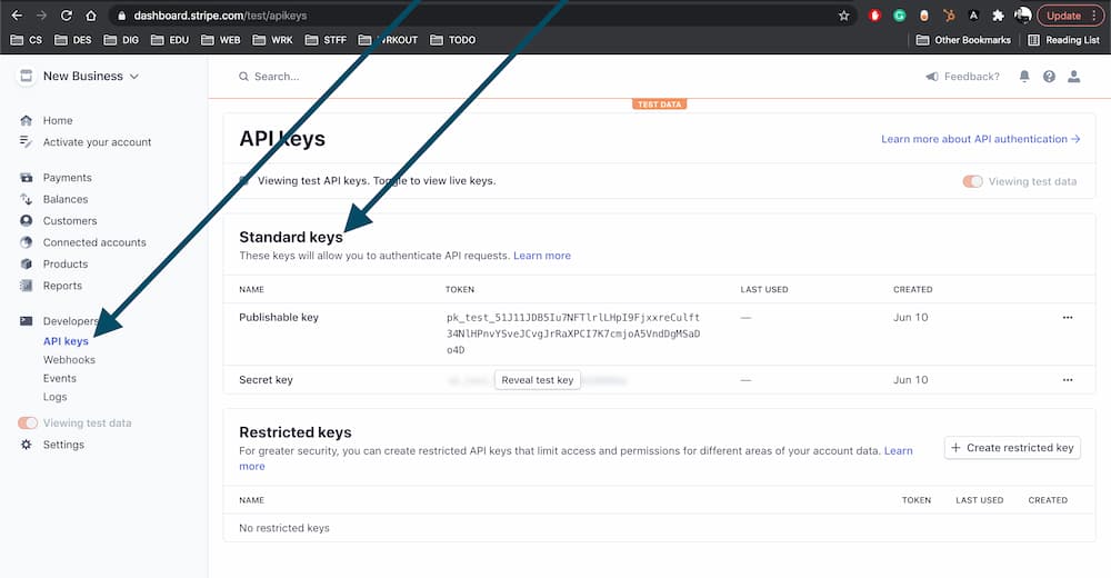

Grabbing Stripe Keys
On the Stripe dashboard at https://dashboard.stripe.com/test/apikeys, on the left-hand side under the ‘Developer’ menu, there is an ‘API keys’ menu. In that section, we’ll find the ‘Publishable key’ and ‘Secret key’ we need for this project.
🚨 If you have an activated Stripe account and are just trying this out make sure you have ‘Viewing test data’ toggled on the left-hand side of the dashboard.

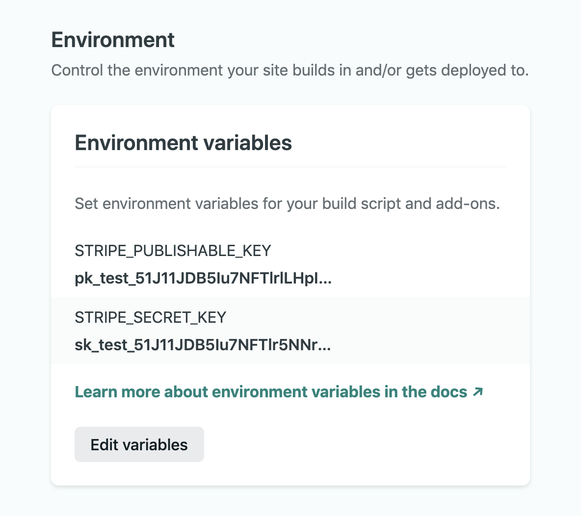

Adding Stripe Env Vars
Under the project’s ‘Environment’ menu is a section for ‘Environment variables’. Click the ‘Edit variables’ button to add the two Stripe keys from the Stripe account, naming them like so:
STRIPE_PUBLISHABLE_KEYSTRIPE_SECRET_KEY
Then click ‘Save’ and we’re all set!
With that, the project credentials are all set.

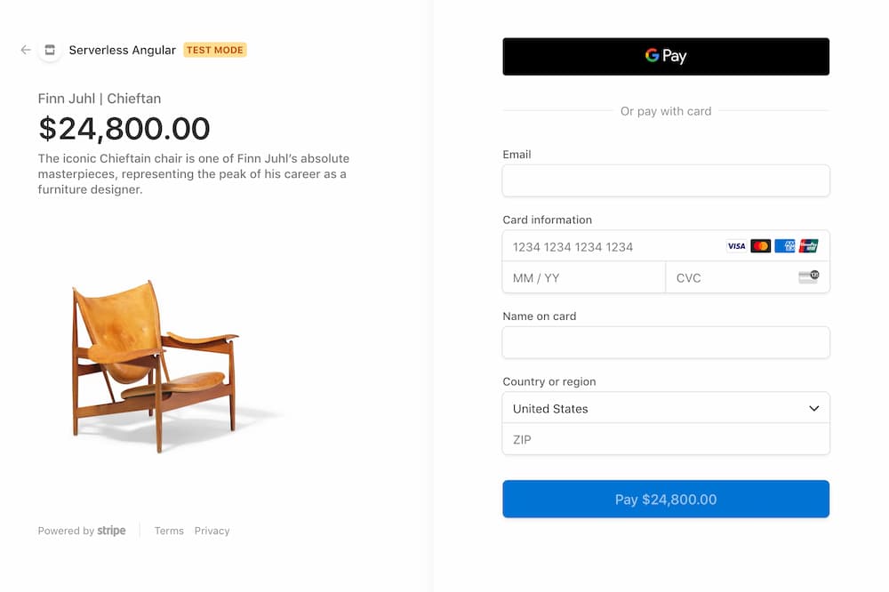

We can test it locally by running netlify dev or by pushing the new code up to the project repo (which would trigger a new deploy) and seeing how it works in the real world by going to the live site. Whichever environment, we should be able to click the ‘Buy Now’ button and be sent to the Stripe checkout process for the product clicked.
📚 To learn more about developing Netlify Functions with Angular check out this blog post on just that
Time to Checkout
Guess what, we can check out mentally now because we have a working checkout process! With this project, we were able to grab information about a product, pass it to a serverless Netlify Function that talks to the Stripe API, then open up the Stripe checkout page to handle the transaction. Instead of setting up a whole checkout process yourself leave it to the experts at Stripe. Now, you’ll have time to do more important things like eating croissants. Happy coding 👩🏻💻!
