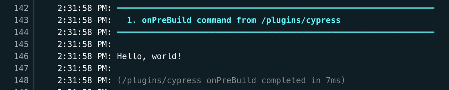

Our first draft of the plugin was printing Hello, world! before the build starts, so we could quickly check that the plugin was working.

Once these changes are committed and pushed, the deploy preview logs should be showing something like this:

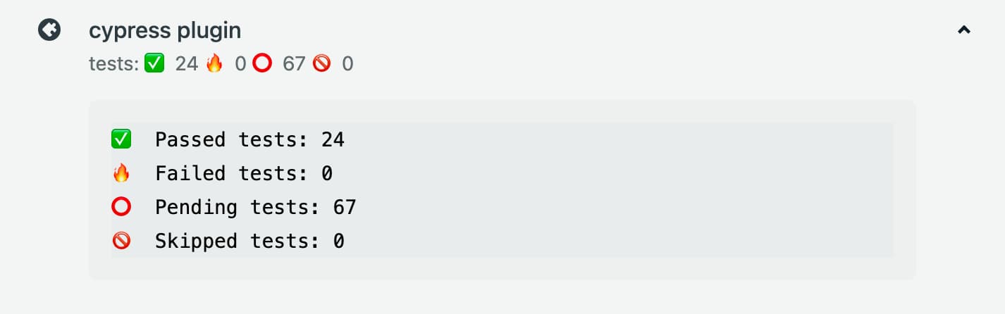

Displaying information in the deploy summary
Another property we have access to is utils. It lets us display some information in the deploy summary at the top of the deploy page, using utils.status.show.
We liked the way the existing Cypress build plugin showed information with icons, so we went with the same approach.
const summary = [
'tests:',
`✅ ${result.totalPassed}`,
`🔥 ${result.totalFailed}`,
`⭕️ ${result.totalPending}`,
`🚫 ${result.totalSkipped}`,
let text = `
✅ Passed tests: ${result.totalPassed}
🔥 Failed tests: ${result.totalFailed}
⭕️ Pending tests: ${result.totalPending}
🚫 Skipped tests: ${result.totalSkipped}
utils.status.show({
title: 'cypress plugin',
summary: summary.join(' '),
text,

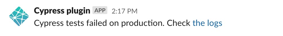

Posting Slack messages
Finally, we also want to post Slack messages to our main frontend channel to notify the guild that Cypress tests have failed, but only when it happens in the production environment.
This will look similar to the section above as this is done by doing a POST request to the Slack API.

When the tests fail in production, here’s what will be posted on Slack:
