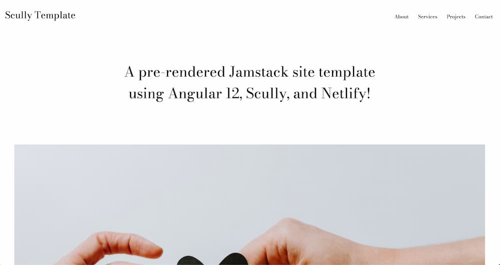

You can find the project repo here and this is what the template looks like.

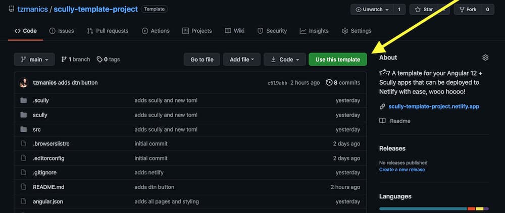

I was thinking ahead and made the project repo for this template a template project. So, we can just click the ‘Template’ button or clone the repo locally with the command git clone https://github.com/tzmanics/scully-template-project. Template, template, template, in case I hadn’t used that word enough.
If we need to rename the project we’ll have to find and replace every instance of scully-template-project. It exists many places in an Angular project so cloning with a new name (git clone https://github.com/tzmanics/scully-template-project new-name) is just the start. Most code editors will allow you to ‘replace all’ on a searched phrase to make the job easier.

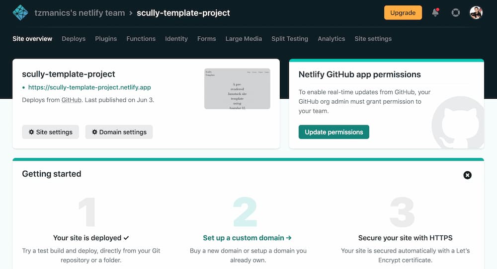

This template comes with a Netlify configuration file that sets us up to easily deploy to Netlify’s CDN (Content Delivery Network). If we want to also take advantage of continuous deployment we can install the Netlify CLI and initialize the project with these two commands.
npm install netlify-cli -g
netlify init
Now, whenever we push code changes to GitHub the project will automatically update and deploy the new build.
🧠 Fun Feature Fact: We recently released Collaborative Deploy Previews to help teams give impactful feedback on projects. You can try it out when you deploy this project.
Well, how about that, we got ourselves our own live Scully site.
