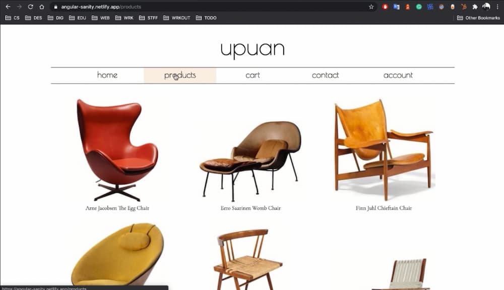

This is what the page will look like:

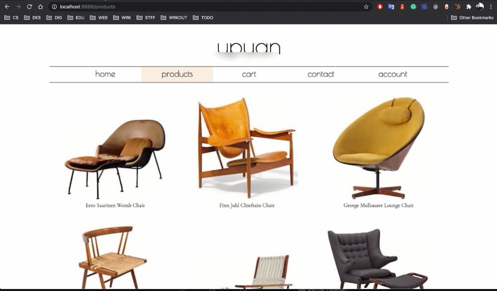

Eye on the Product
Get excited, we can finally see how this looks! To do so locally, we can run ntl dev in the root directory of the project. Then we’ll head to localhost:8888/products.
Now if we’ve either already hooked this project up to Netlify using the CLI ntl init command, or followed the steps in part 1 of this series, we have CI/CD set up. That means we can git commit the code changes we made and it will trigger a new build of the project. Then we can head to the project dashboard or run the command ntl open to have Netlify take us right to the dashboard. Once, the new build is published we should see the same products we saw locally.

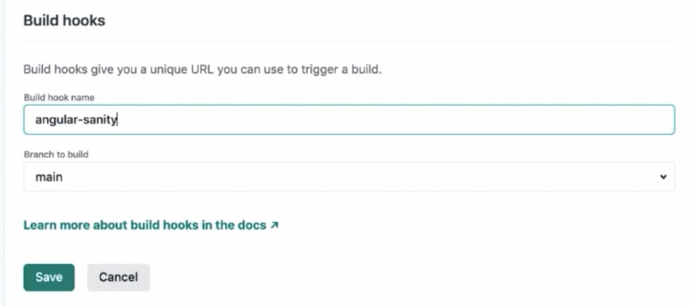

Adding a Netlify Build Hook

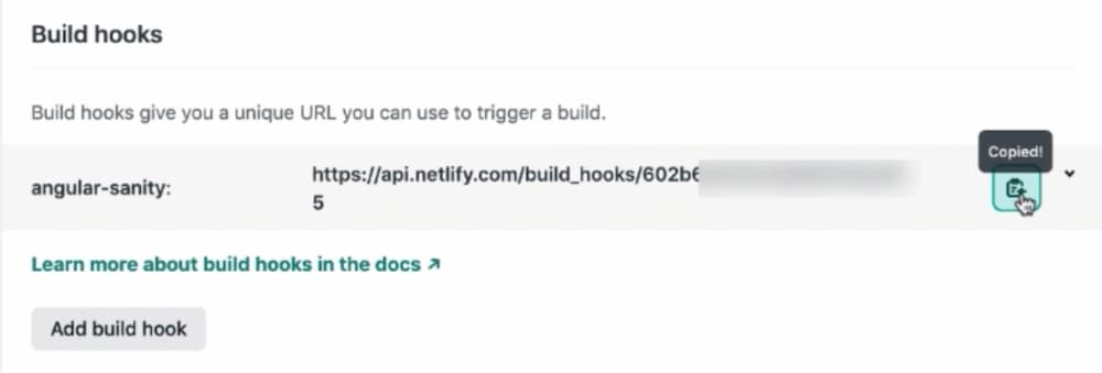

Netlify provides an easy interface for setting up Build Hooks through the project’s dashboard. We’ll head to Site settings > Build & deploy > Continuous deployment > Build hooks and click the ‘Add build hook’ button. Today we’ll just set the name to ‘angular-sanity’, for identification, and use the ‘main’ branch.
Once we have the build hook information saved, we’ll get a unique URL to copy for the next step. To trigger this hook, we need to send a POST request to that URL. Thankfully, Sanity.io has a quick process to set up that POST request.

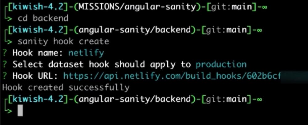

Creating a Sanity Hook
In the terminal, we need to make sure we’re in the backend directory where our Sanity.io instance lives. We can then use the Sanity.io CLI to create a hook with just one command.
sanity hook create
Through the prompts, we’ll name the hook netlify, set the dataset to production, and paste the link we just received from Netlify when we made the Build Hook.

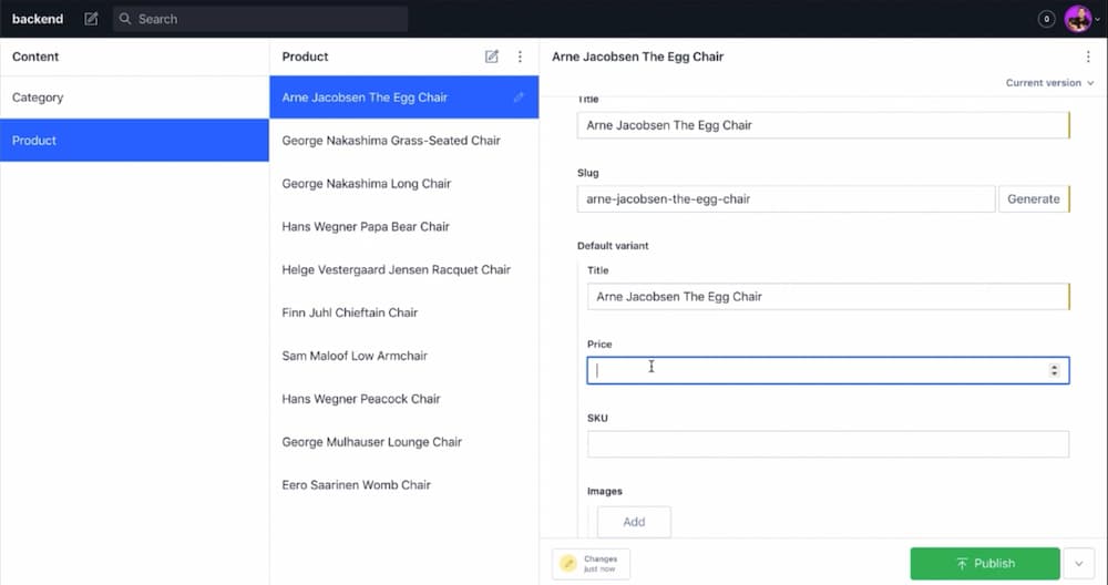

Hook Test

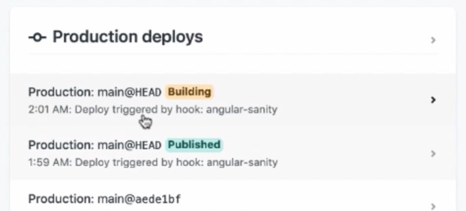

Does this work? Well, let’s add a new product and see about that. We can head back to our deployed Sanity.io instance. The address for this can be found at the top of the project dashboard beside ‘Studio’. Check out the section on Sanity deploying in the first part of this series to see where this link lives.

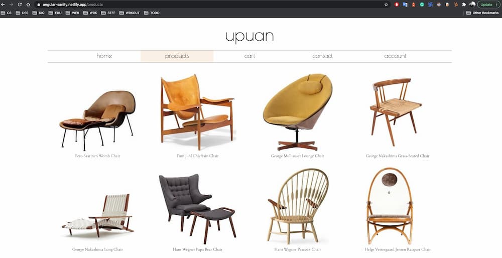

After hitting ‘Publish’ on the new data, we can look at the Netlify Production deploy logs (on the project’s main dashboard) and see that a build has been triggered by the Build Hook.
Once that deploy is published we just head back to our site and, voila, a new product!
