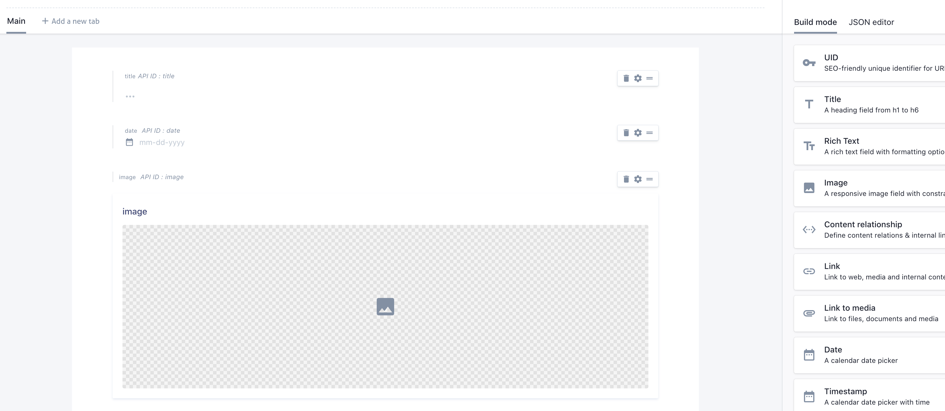

Go ahead and sign up for Prismic, and start a new repository. Once you’ve done that, create a new custom type:
Once you create that type, you can add whatever fields you’d like. I added a Title, Date, and Image:
From here, make a couple of Posts now so that you have something to populate your project with.
