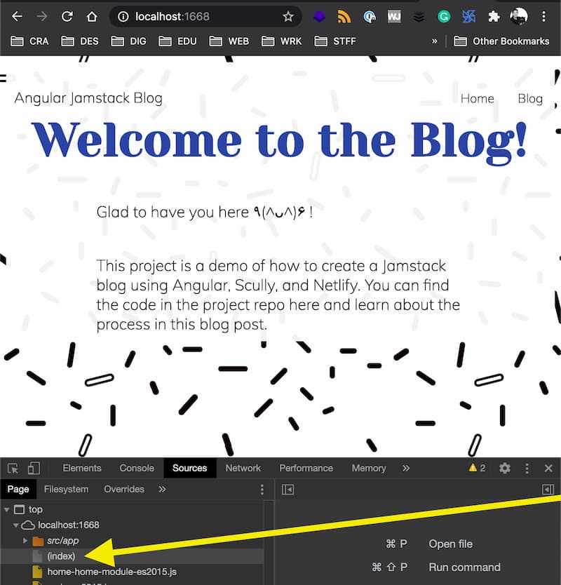

Now that we’re set up, we can incorporate Scully by running the Angular CLI’s ng add command and passing in the Scully library’s init command.
ng add @scullyio/init

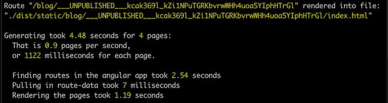

Once installed we can run ng build and npm run scully to build out the project and have Scully traverse the build project to find all the routes to pre-render.
ng build
npm run scully
🤔 We always want to build out the project before running Scully if there are any changes. Scully always looks at the build output to get its information.
Running Scully creates a new build output folder called static that contains the pre-rendered content in a directory for each route. To see what the pre-rendered content looks like we can use Scully’s serve command.
npm run scully serve

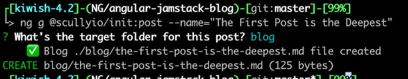

Poppin’ in Posts
To get some content into our blog we can generate a post using yet another generate command. This command will call on Scully’s post generation code and we can pass a name in as well.
ng g @scullyio/init:post --name="The First Post is the Deepest"
The CLI will prompt “What’s the target folder for this post?” We’ll go with the default “blog” directory that we created with the generate blog command. In the future we can make specific folders for posts, even nested folders.
🧠 Scully recursively looks for different routes so however far we nests our posts 🕵🏻♀️ Scully will find them.
We can see what was created by going to the /blog directory. We have some Front Matter and an h1 header with the title.

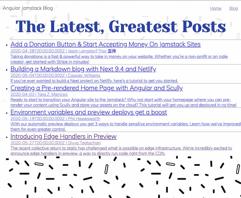

Page of Posts
Now we get to put a summary of all our posts on one page! First, we need to edit the blog-root.component.html. In this file we’ll add a div to hold a list of our posts. Inside that list we’ll call on *ngFor to have it make a list item for each post. We’re grabbing the information that is listed in the Front Matter via the scully-routes.json file. For this list we’ll list each posts title, author and description.
<!-- src/app/blog-root/blog-root.component.html -->
- <p>blog-root works!</p>
+<h1 class="title-box">The Latest, Greatest Posts</h1>
+<div class="blog-posts">
+ <ul>
+ <li *ngFor="let post of posts$ | async">
+ <a [routerLink]="post.route">
+ <div class="post-card">
+ <h2>{% raw %}{{ post.title }}{% endraw %}</h2>
+ <p>{% raw %}{{ post.authors }}{% endraw %}</p>
+ <b>{% raw %}{{ post.description }}{% endraw %}</b>
+ </div>
+ </a>
+ </li>
+ </ul>
+</div>
We need to pass in posts so that we have something to iterate over. We can do this inside the blog-root.component.ts file. Thankfully, Scully gives us ScullyRoutesService that lets us access all of the routes of the site. We can then filter those routes to only get the ones that start with /blog.
// src/app/blog-root/blog-root.component.ts
import { Component, OnInit } from '@angular/core';
+ import { ScullyRoute, ScullyRoutesService } from '@scullyio/ng-lib';
+ import { Observable } from 'rxjs';
+ import { map } from 'rxjs/operators';
@Component({
selector: 'app-blog-root',
templateUrl: './blog-root.component.html',
styleUrls: ['./blog-root.component.scss']
export class BlogRootComponent implements OnInit {
- constructor() { }
+ constructor(private scully: ScullyRoutesService) {}
+ posts$: Observable<ScullyRoute[]>;
- ngOnInit(): void { }
+ngOnInit() {
+ this.posts$ = this.scully.available$.pipe(
+ map(routeList => {
+ return routeList.filter((route: ScullyRoute) =>
+ route.route.startsWith(`/blog/`)
When Scully creates the list of blog posts it only grabs the posts marked as publish: true. This is another way we can use the frontmatter to do work for us. We can still reach unpublished posts with their slugs but they won’t show up in our lists.

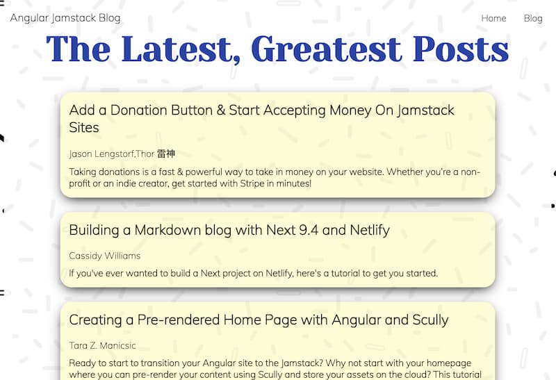

After re-running npm run jam-it, we can open up http://localhost:1668/blog to see we have all the blog posts! And, buddy, do they look silly!
Thankfully, we have CSS to the rescue!
Make it Pretty
Here is the CSS for the list of blog posts:

Let’s see what this looks like.
Much better, moving on!

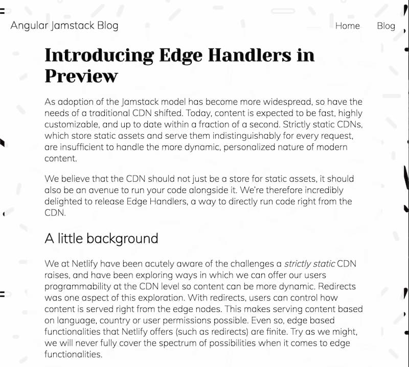

Post Page

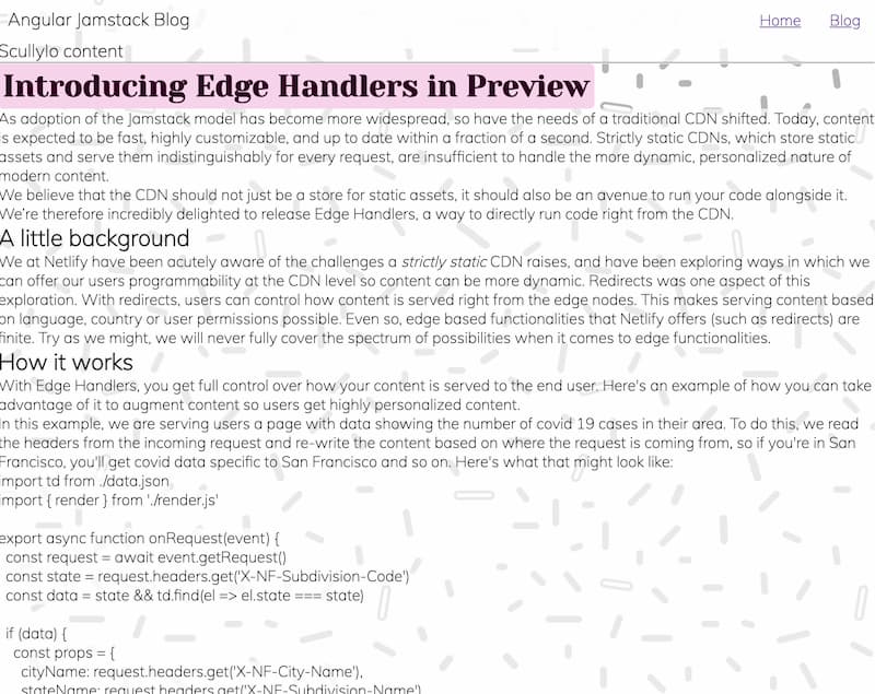

With a list of linked, lovely, um, posts. We want to make sure that the posts look great too. Let’s see.
What the what?? Why does it say ‘Scullyio content’ and why is it pink? If we take a look at the blog module that generating the blog via Scully created we get our answers. First off, in blog.component.html we see:
<!-- src/app/blog/blog.component.html -->
<h3>ScullyIo content</h3>
<hr />
<!-- This is where Scully will inject the static HTML -->
<scully-content></scully-content>
<hr />
<h4>End of content</h4>
This shows us that there are some hard-coded headers and an <hr> that we no longer need. We can change this by removing the superfluous stuff and adding a div around the scully-content so it’s easier to style.
- <h3>ScullyIo content</h3>
- <hr>
+ <div class="blog-post">
+ </div>
- <hr>
- <h4>End of content</h4>
The styling for posts is where we find the pink background.

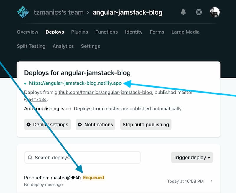

Initiate Init
To talk to Netlify we’ll need to install the Netlify CLI and run netlify init to hook our project up to a Netlify project.
npm install netlify-cli -g
netlify init
🤔 If you don’t have a Netlify account or project this command will walk you through doing all of that either through the command line or taking you to the Neltify UI.
Now, we can run ntl open to see our deployed site’s dashboard. Running netlify init also triggers a build so we can see there is already a deploy running. Once it’s ‘Published’ we can click the link Netlify provides at the top of the site’s dashboard.
With that our blog is live with all our witty, charming, highly-intellectual blog posts. Go us!
We Did it! 🎉
We now have a site with a home page, a list of all our blog posts, and blog post pages. Better still, it is all pre-rendered thanks to Scully and deployed to a CDN thanks to Netlify. I hope you share with us what you’ve created and keep making more content to share! Happy coding 👩🏻💻!
