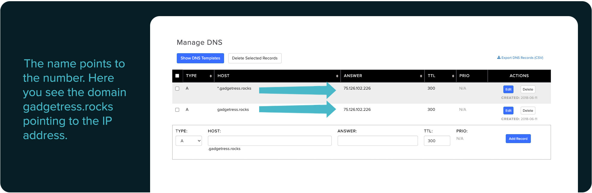

The impetus for DNS is actually pretty simple. At its core, computers are very good with numbers and humans are very good with names. DNS puts names to what otherwise is a number.
The name points to the number. Here you see the domain gadgetress.rocks pointing to the IP address.

A records are called Address Records or sometimes Host Records. These records point your domain to the IP address of your website or hosting. Let’s say that you own the domain name thiscode.rocks. It is hosted at Name.com and the IP address of your hosting server is 127.0.0.1. Usually you would have two DNS records to point your domain to the hosting that look like this:
A thiscode.rocks 127.0.0.1A *.thiscode.rocks 127.0.0.1
In this example, the first A record is pointing to the “bare” version of your domain. That means when someone goes to their browser and types in the domain name without www, it will resolve to the right server and website. The second A record is the wildcard version. This redirects any subdomains to your domain to the server; this includes www, and anything else people may type before your domain name.
You’d set up any specific subdomains the same way. So, if in the example above, you wanted to make a subdomain called test.thiscode.rocks, then you would create an A record that looks like this:
A test.thiscode.rocks 127.0.0.1
