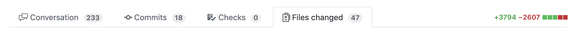

Small PRs are easier on reviewers
If someone has to read through and make sense of your code in order to evaluate it, it’s much easier to get through if it’s smaller and more focused. Think about it from the reviewer’s standpoint: it’s their job to make sure whatever code they’re reading makes it through this process in the best state possible. The smaller the amount of code, the lower the cognitive load you impose on them to envision all the moving parts and any potential side effects.
The higher the number of changes, the more conversation you’ll have to have.
It also requires reviewers to do much more work as a communicator, which takes two skills: the actual code review, and the ability to communicate how/why the changes need to be made. As a reviewer, sometimes I’m handed huge chunks of code, some of which I would like to take, some of which I can’t. This means I now have to break these concepts apart, explain the differences between them, and talk through an iteration plan. This is ok, but a lot more mental overhead for everyone involved, particularly because it can potentially be damaging to the team if the communication goes poorly. Smaller PRs keep the conversation focused, and as such, reduce the need for any communication gymnastics.

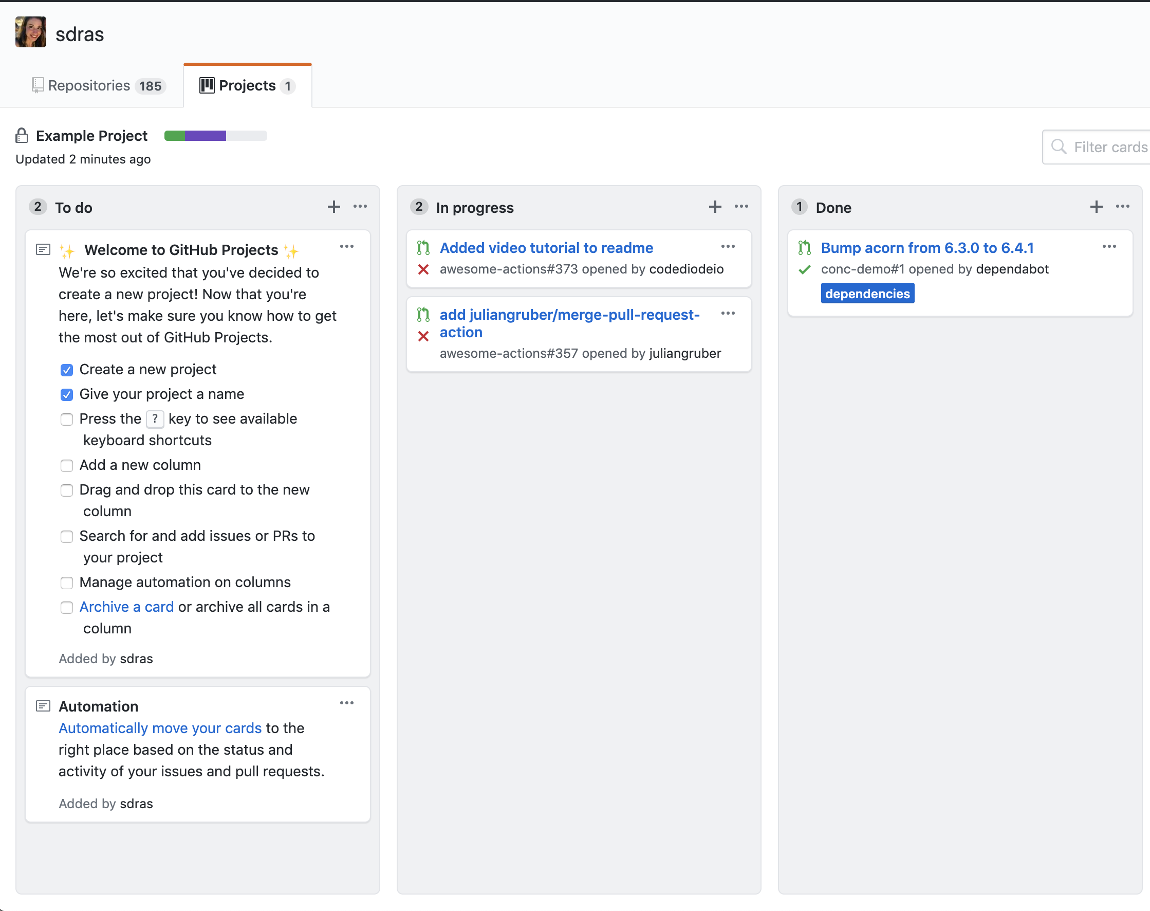

If you’re going to leave unfinished work, it’s helpful to keep track of what’s left. This is not just for you, but for any stakeholders like your teammates or PMs. A lot of teams will make use of project boards for this, which also helps you go over what’s going on in the project as a group
Example GitHub Board, you can add in issues as well as notes.

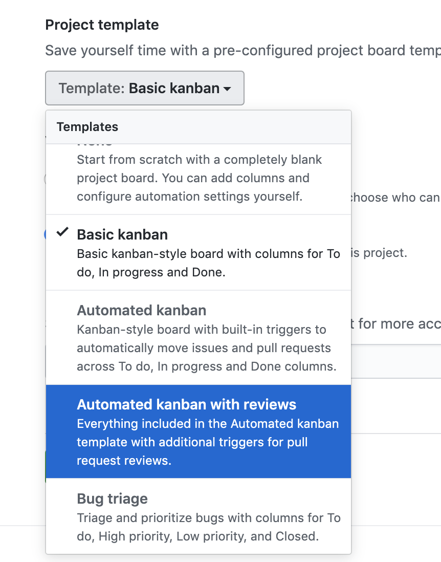

Some tools like GitHub and Jira will help you with some automation as well:

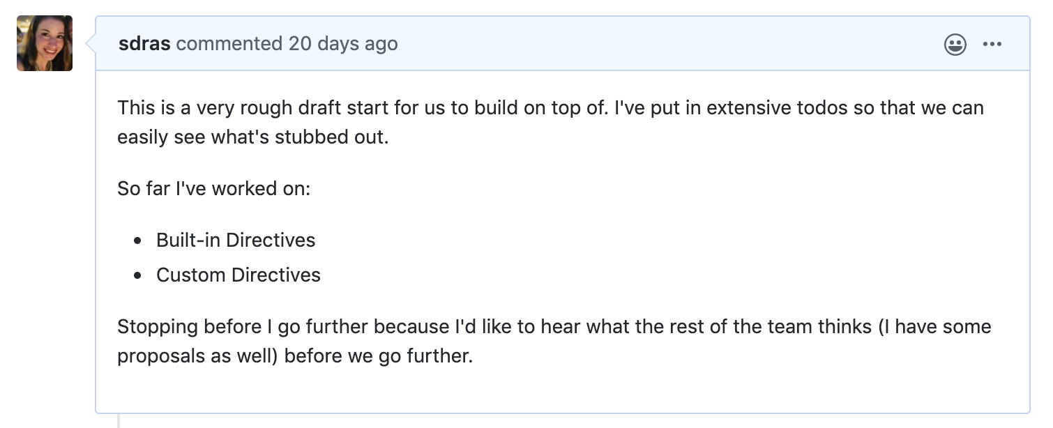

Even if you’re tracking things within these boards, it can be useful to your coworkers/reviewers to do a todo list or list of changes in the PR itself as well. This helps them immediately see the scope of the PR without having to check any other references, which can help with speed of execution:

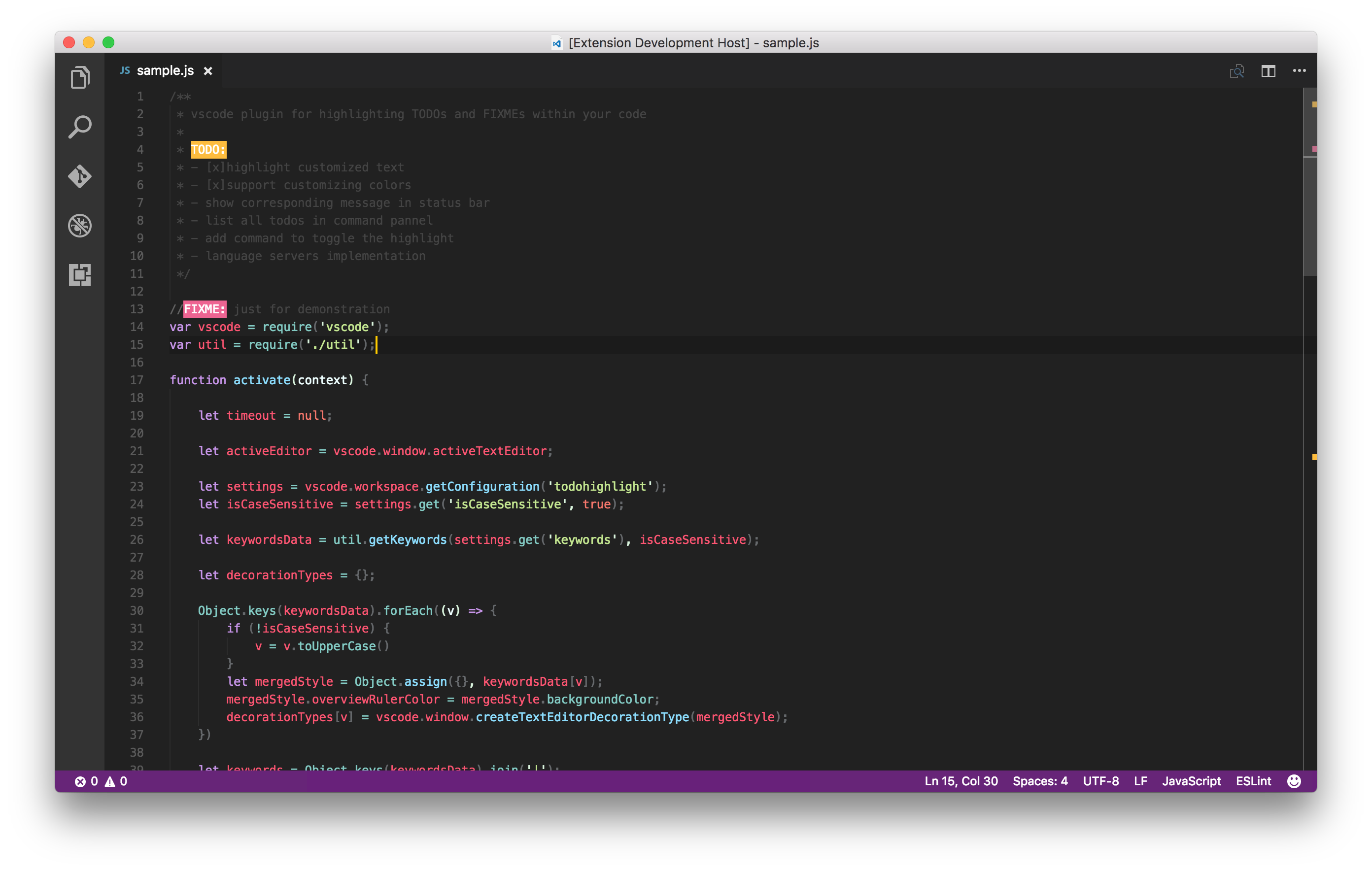

As mentioned above, you can also make use of To dos — I do this sometimes, and will track what’s left with this VS Code extension that goes through and highlights any to do comments for you. You can also override and customize it, should your team have a different convention.
