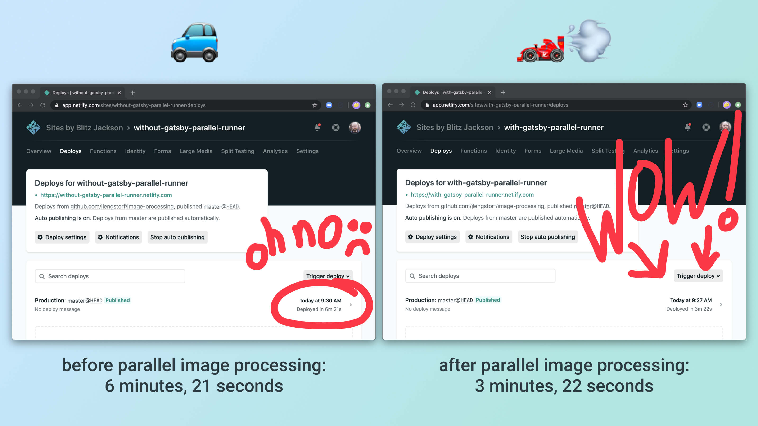

In this article we’ll implement gatsby-parallel-runner to make image-heavy Gatsby builds on Netlify nearly 2× faster!
On a demo site with lots of images, adding gatsby-parallel-runner reduced build times for the site from 6 minutes and 21 seconds down to 3 minutes 22 seconds — a whopping 47% drop!

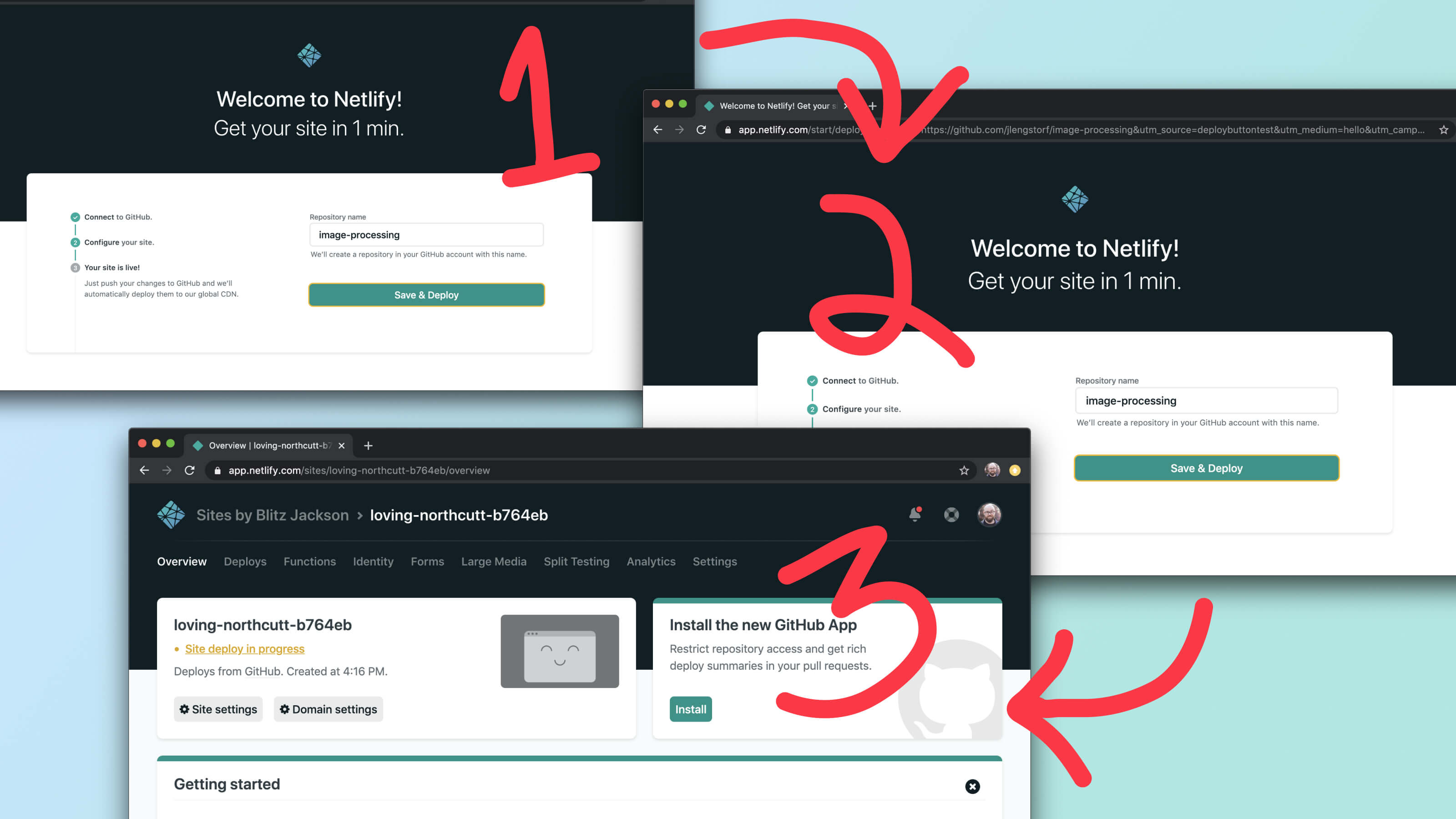

Set up the demo Gatsby site repo (optional)
For this tutorial, we’ll be using a repo with a lot of unoptimized images to make the impacts of parallel image processing clear. To avoid testing the speed of your internet connection, we’ll work entirely on Netlify for this tutorial.
Deploy the demo site to your Netlify account to get started. It’ll start building right away using the standard gatsby build command, which will take about 6 or 7 minutes.

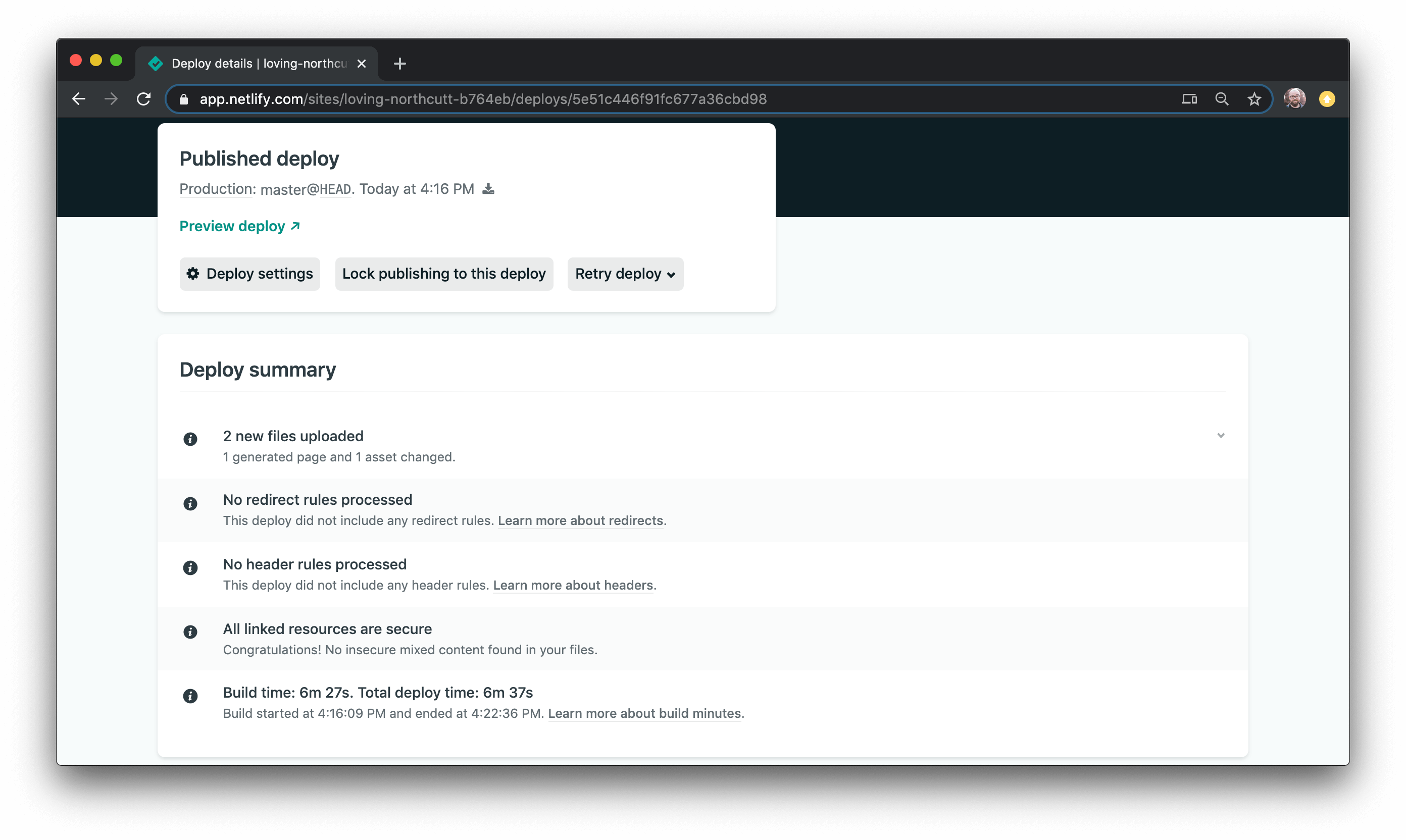

We can see how long this takes by checking the deploy log after the site builds:
The site took 6 minutes and 27 seconds to build. If we look into the raw build logs, we can see that the vast majority of that build time comes from the “Generating image thumbnails” step:
4:22:29 PM: success Generating image thumbnails - 260.467s - 2140/2140 8.22/s
In an image-heavy site like this one, almost all of the build time comes from image processing.

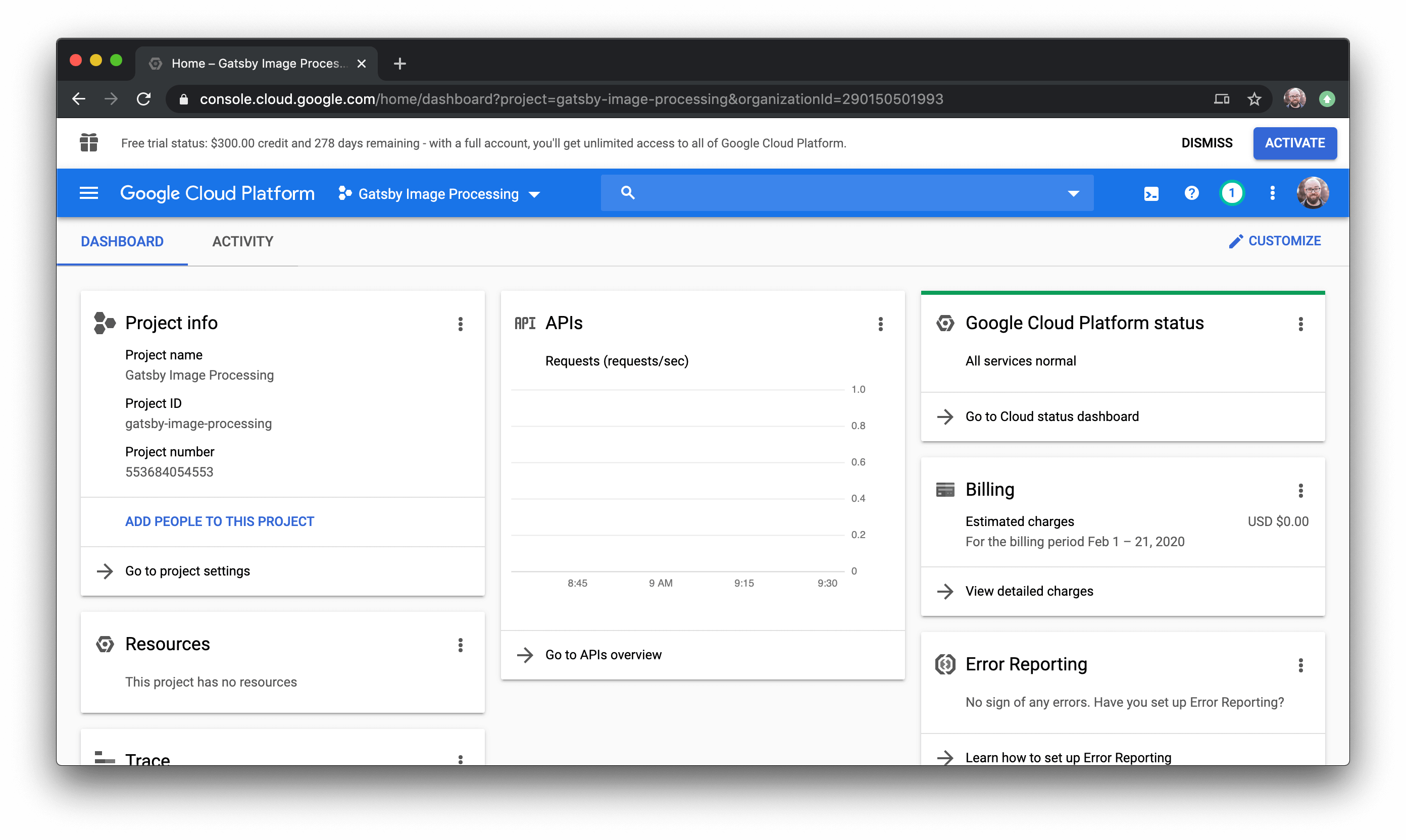

Create a new project
Once you’ve created a Google Cloud account, go to the Google Cloud Platform dashboard.
If you already have a Google Cloud account, click the dropdown next to the “Google Cloud Platform” banner, then choose “New Project” from the top-left of the modal that opens. Give it a name like “Gatsby Image Processing” so it’s easy to remember why you created it later.
If you just set up your Google Cloud account, it should walk you through creating your first project.

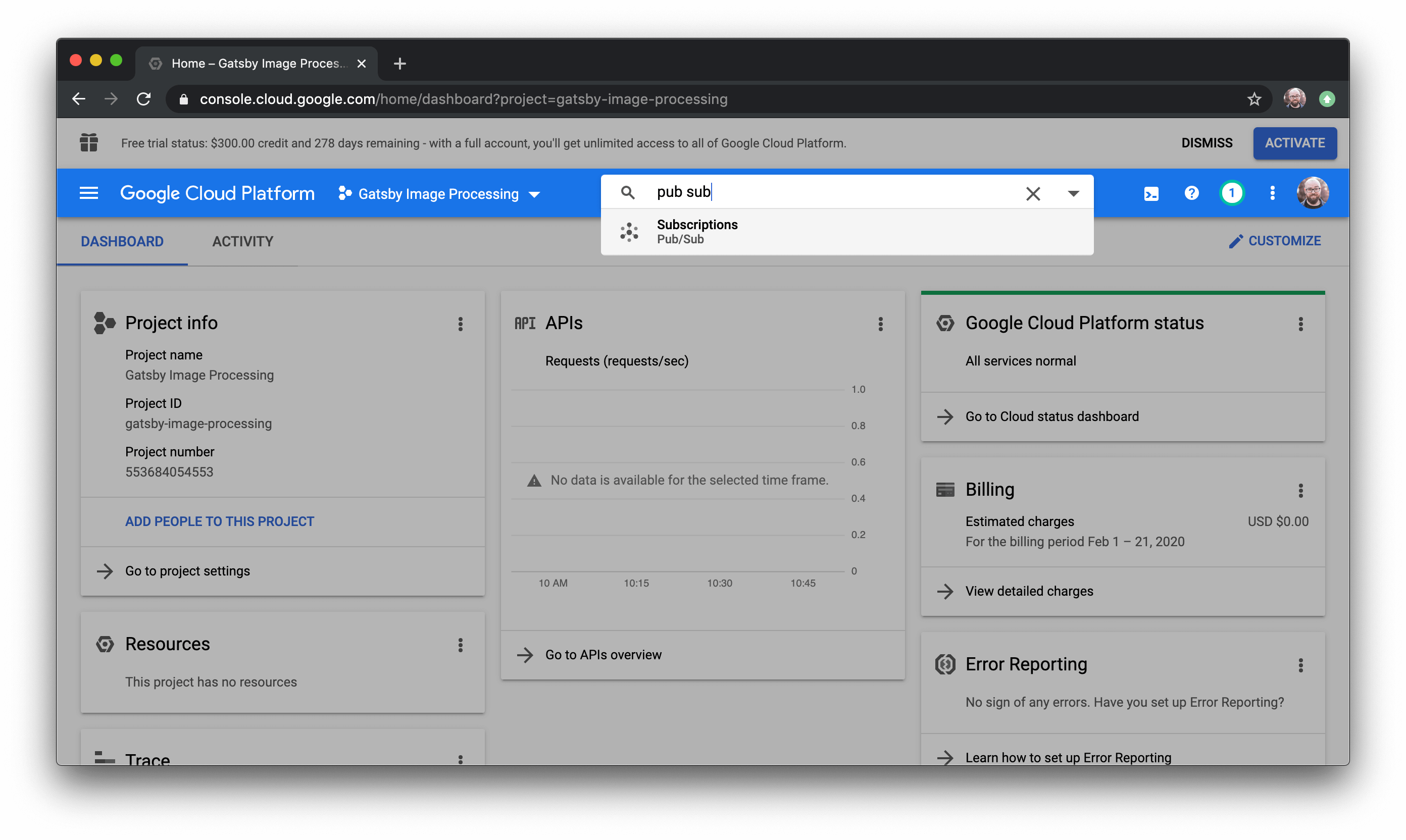

Enable Cloud Pub/Sub
From the dashboard, type “pub sub” into the search bar at the top, then click “Subscriptions” in the results that appear.
You’ll see a note that the Pub/Sub service is being enabled for your account.
This also enables the Pub/Sub API, which is called by the gatsby-parallel-runner to send and receive messages from Gatsby.

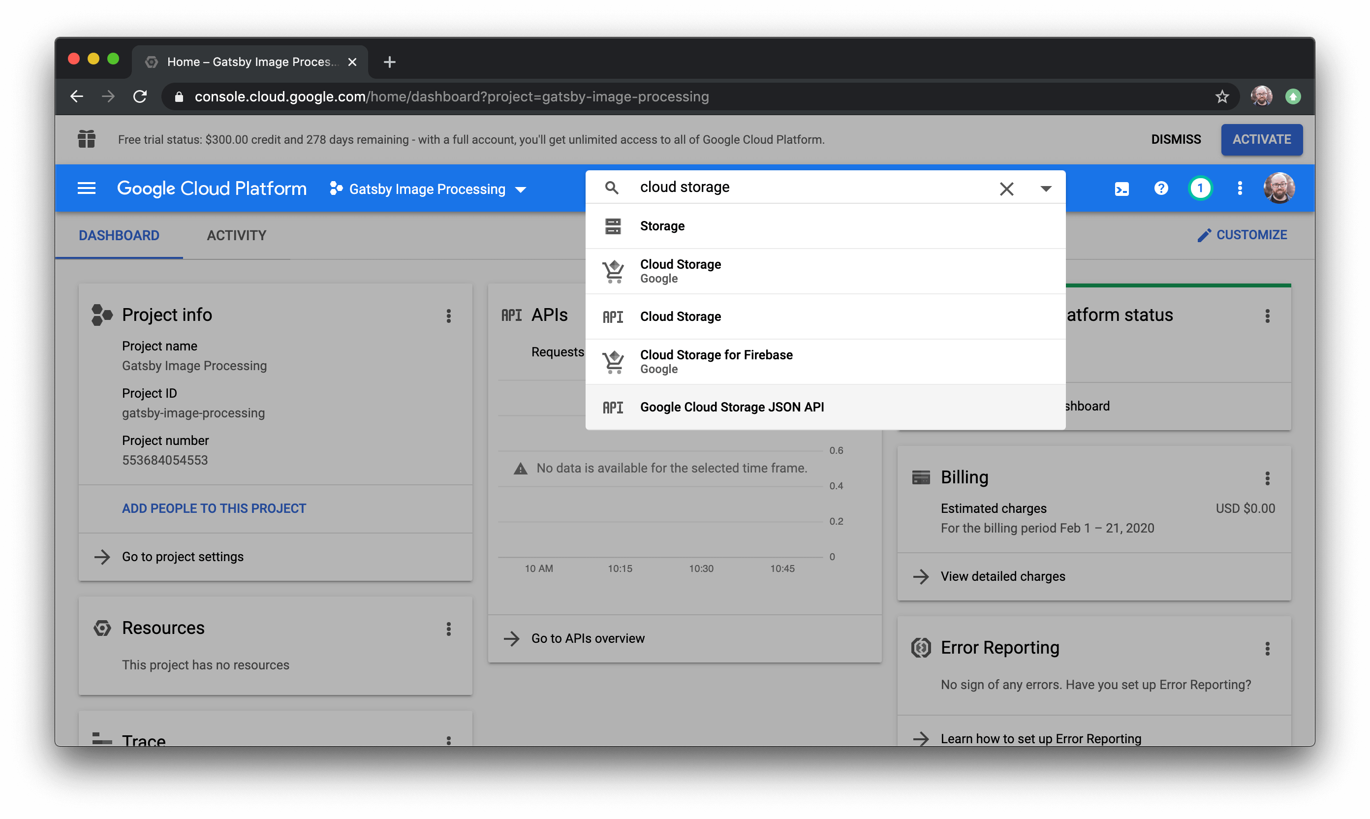

Enable Cloud Storage
Next, type “cloud storage” into the top search bar and choose “Google Cloud Storage JSON API” from the results.
This is required for handling any images that are too large to send using Pub/Sub.

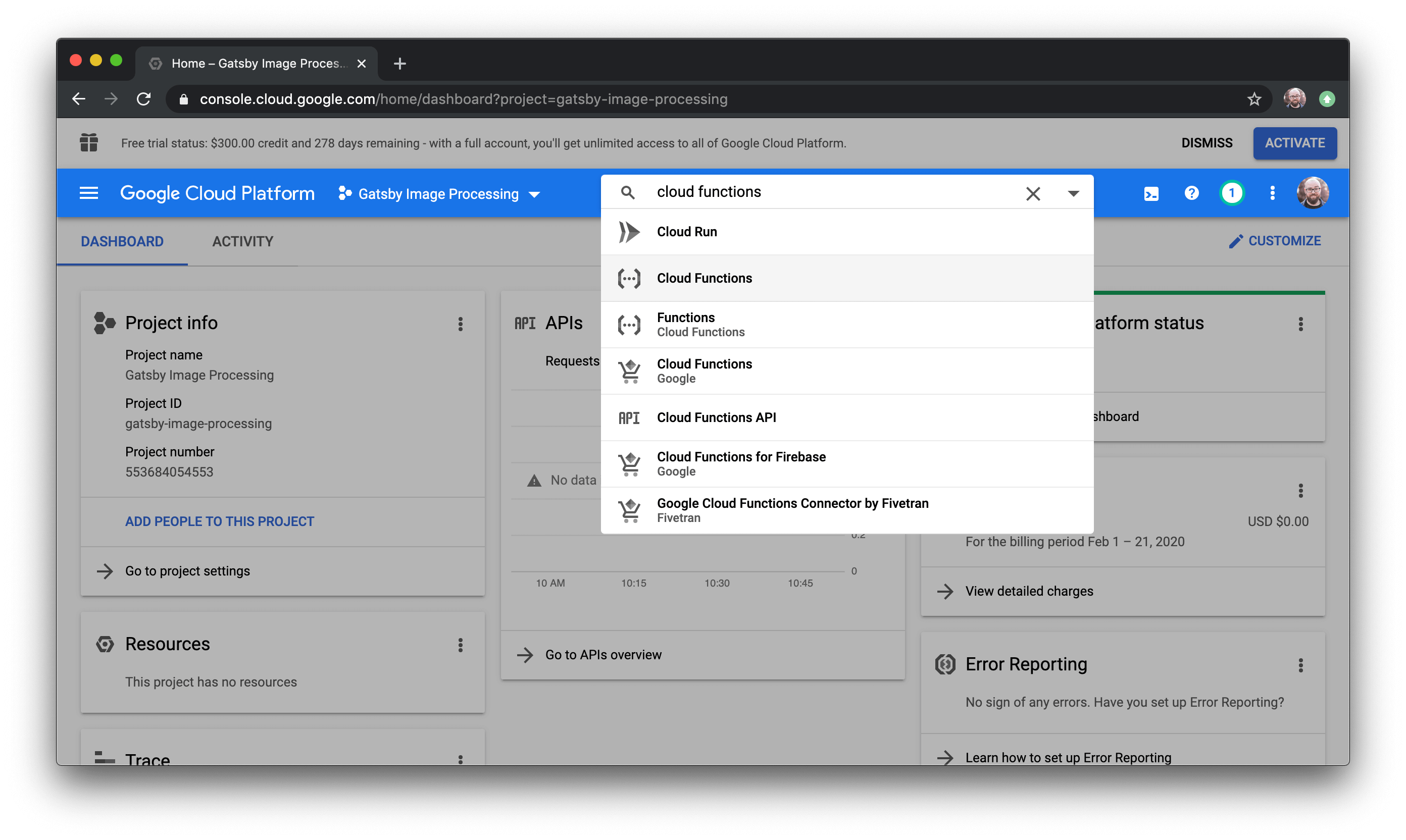

Enable Cloud Functions
In the top search bar, type “cloud functions” and choose “Cloud Functions” from the options (there are a few options here — choose the one that only says “Cloud Functions”).
The parallel runner uses Cloud Functions to actually process images for Gatsby.

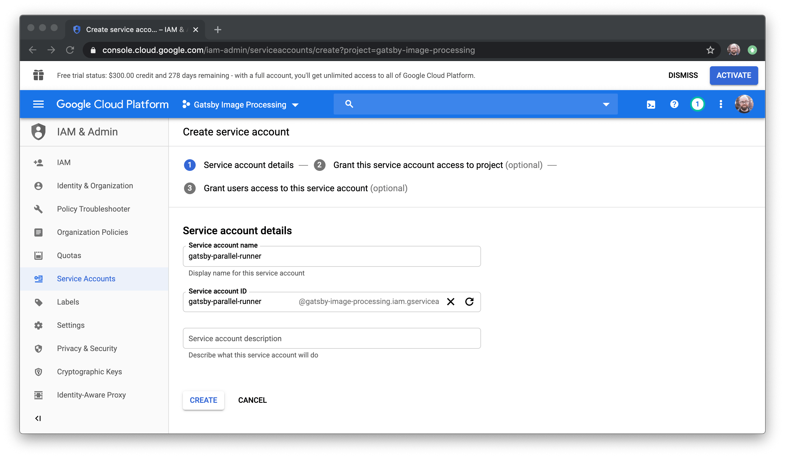

Create a service account and get credentials
Next, click the top-left hamburger nav, choose “IAM & Admin”, then click “Service Accounts”.
On the service accounts dashboard, click ”+ CREATE SERVICE ACCOUNT” near the top center of the screen.
On the next screen choose a name for your service account — to make it easy to remember, maybe choose something like “gatsby-parallel-runner”.

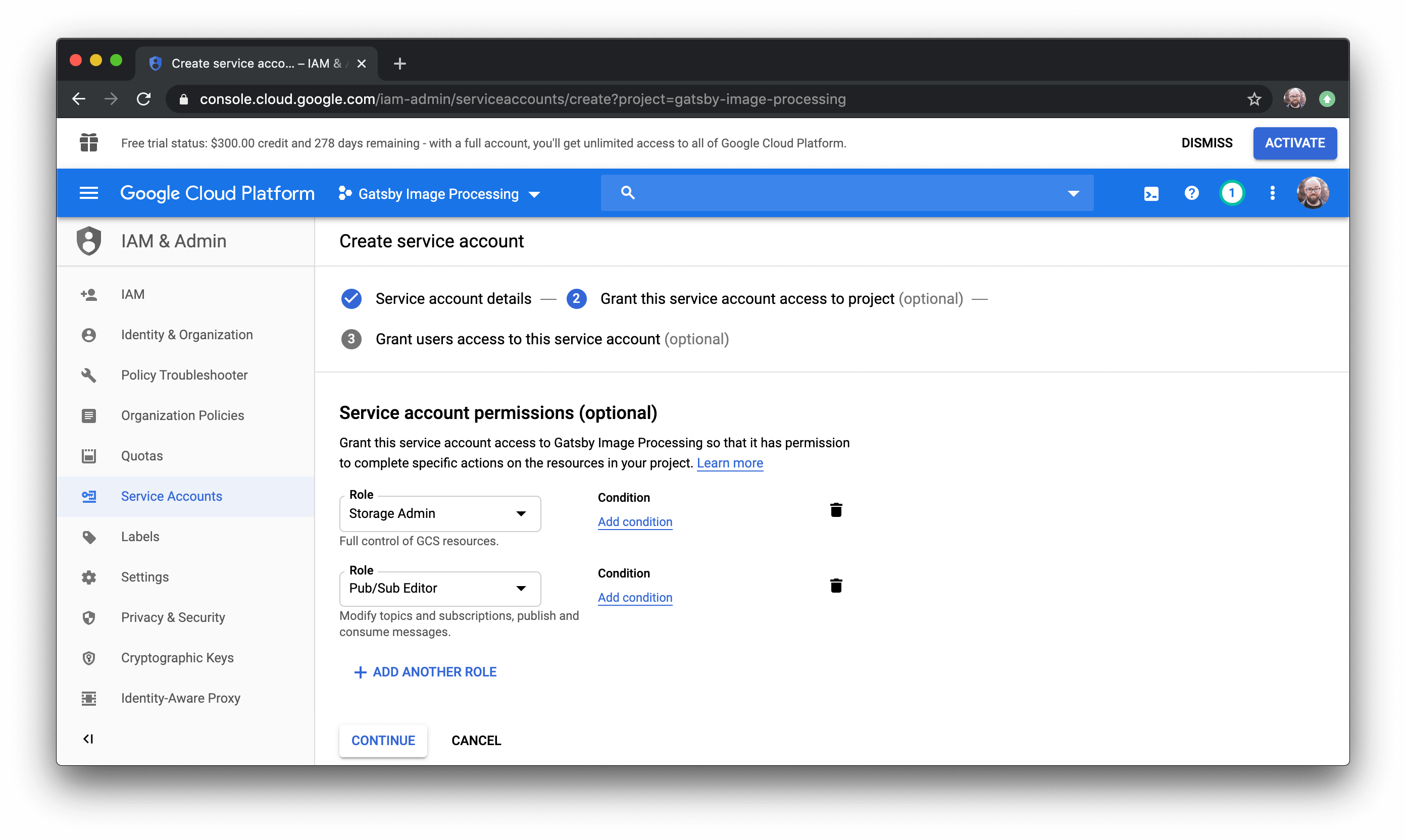

On the next screen add two roles:
- Storage Admin — required to create storage buckets and access them
- Pub/Sub Editor — required to create topics, as well as send and receive messages

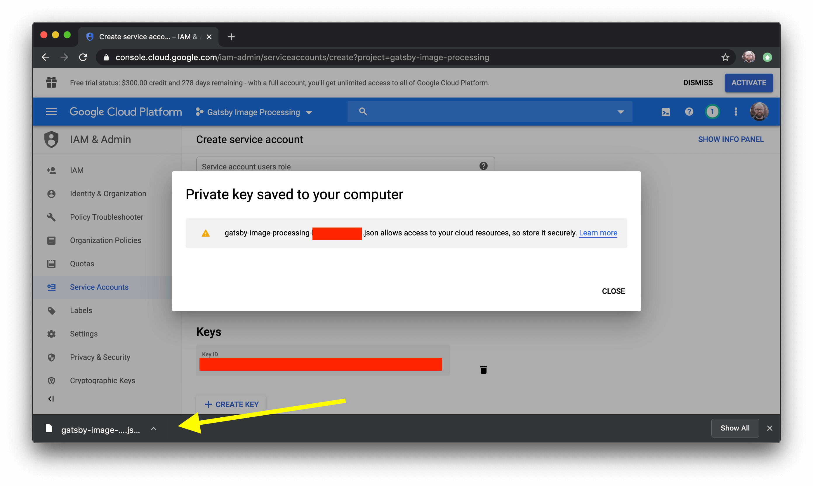

On the third screen, scroll down to the “Create key (optional)” section and click the ”+ CREATE KEY” button. Leave the key type as JSON and click the “Create” button. A JSON file will be downloaded with your credentials.
Move the downloaded file somewhere safe. For the purposes of this tutorial, we will assume that the file will be renamed to google-cloud-creds.json.
Heads up! The information in this file allows access to your Google Cloud account, so make sure it’s stored somewhere secure. Do not commit this file to GitHub!

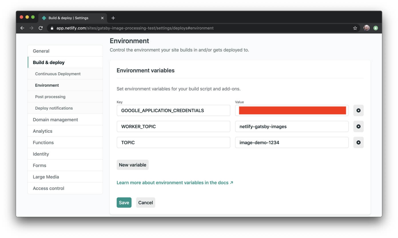

In the “Environment” section, add the following environment variables:
GOOGLE_APPLICATION_CREDENTIALS— set to the base64 credentials from the previous stepWORKER_TOPIC— set this to a unique value (this can be shared between your own sites, but it has to be unique to your Google Cloud account)TOPIC— set this to a unique value that identifies your site

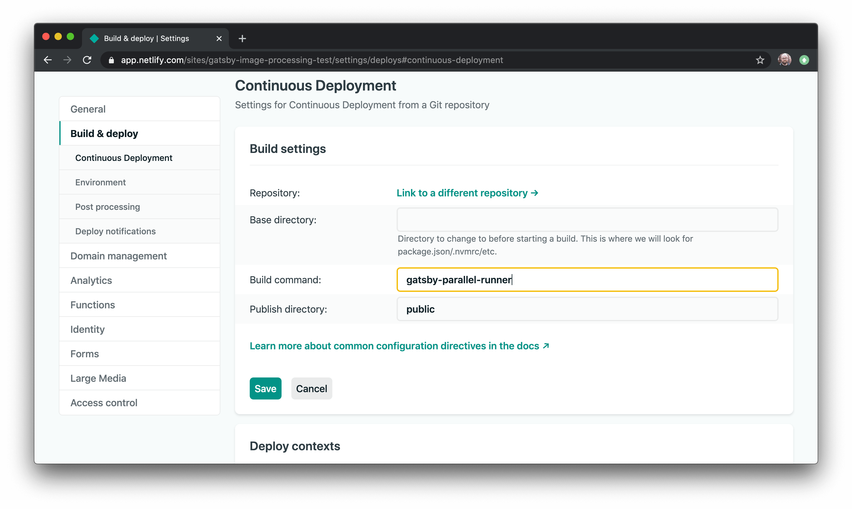

Change your Netlify build command
In the same “Build & deploy” settings on your Netlify dashboard, change the build command to gatsby-parallel-runner:
Heads up! If you use a Netlify config file, change the build command there instead.

On our demo repo, building the site is 47% faster when using gatsby-parallel-runner.
