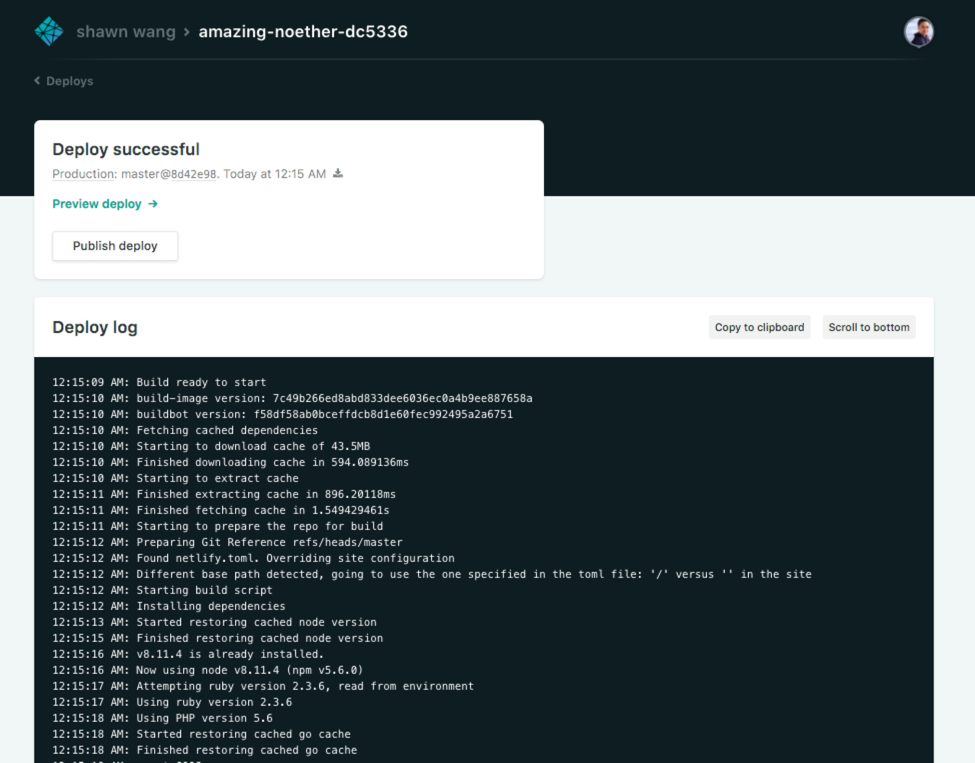

Whenever you trigger a deploy on Netlify (e.g. with a GitHub commit), a new deploy begins with an associated log. It looks like this:

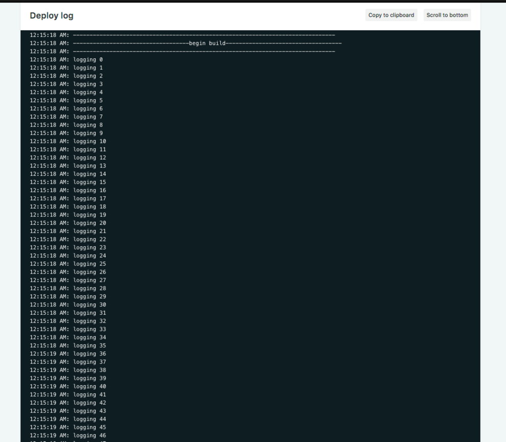

However there is a known performance problem when logs start being very, very big. You can simulate this by generating an arbitrarily large number of logs by just writing a for-loop with a bunch of console.logs (like in this repo), which looks like this:
Through various customer reports with very large builds, we were getting feedback that this log screen was unresponsive for them.

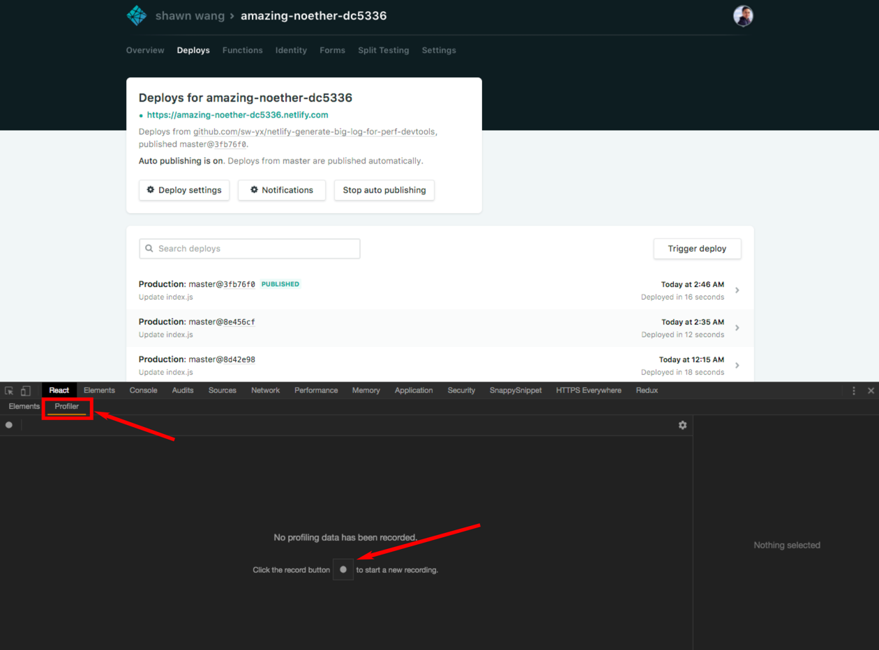

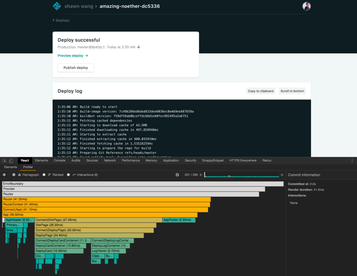

I decided to take a look at it with the new React DevTools Profiler (note that your app must use a version of React that exposes the profiler hooks, currently only available through the prerelease link but likely to be in a future React release). Once you have it installed, switch to the Profiler tab and hit Record:
Now perform the nonperformant action. For us, it is navigating to the page that displays the large logs. Once you are done with the action, end the profiling session and you should get a flamegraph that looks like this:

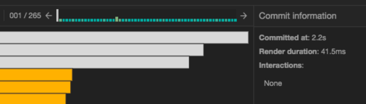

There’s a lot going on there so I’ll try to break it down. Let’s zoom in on the right hand side of the Profiler:
What we see here is there were a total of 265 commits to the DOM during our profiling session, and the first commit occurred 2.2 seconds after I hit record, which took 41.5 milliseconds to render. Excellent!
You can also see a bar chart showing the relative render durations of all the commits — they don’t all show up so you can scroll left and right on top of the bar chart to see the rest of the commits, or click into any one of them and navigate with your arrow keys. Bottom-line: if you have a particularly expensive render (say taking 900 milliseconds) it should show up easily here, and you’ll be able to click into it and work out which component is causing the expensive render.

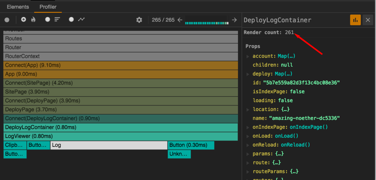

But our app doesn’t have that problem here. The problem is the other one: too many commits! Here I have 265 commits when my script runs console.log 200 times, meaning there are 65 other commits to various parts of the DOM that the console.log isn’t directly responsible for.
I verify this by increasing the number of times my script prints console.log onto the server to 500, and when redoing the Profiler action I see that the commit count increases to 565 commits. So the commit count is going up linearly with the log length, and this is obviously not scalable if we have logs with tens of thousands of lines!

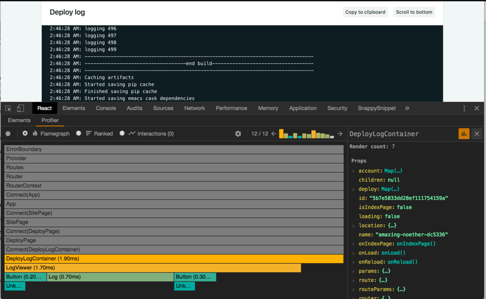

We’re not done yet though. We can use the Profiler to zoom in on the exact component that is causing the issue. Looking around between the frames I see that there are some sections that are highlighted in colors (longer = oranger) and most of my renders are focused on rendering this DeployLogContainer component:
When I have DeployLogContainer selected, the right panel changes to display the props (which flash when they change as you navigate between frames!) as well as a “Render Count” field. This field is pretty useful for us — because when I navigate to the last frame of this field, guess what the Render count reads?
261 renders of this component! That’s the cause of the performance issues.

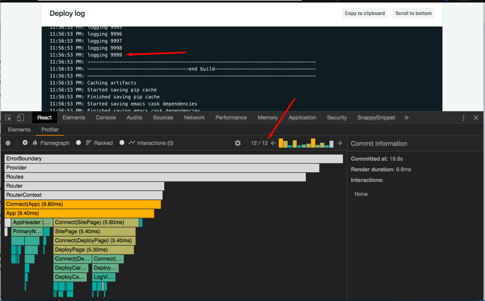

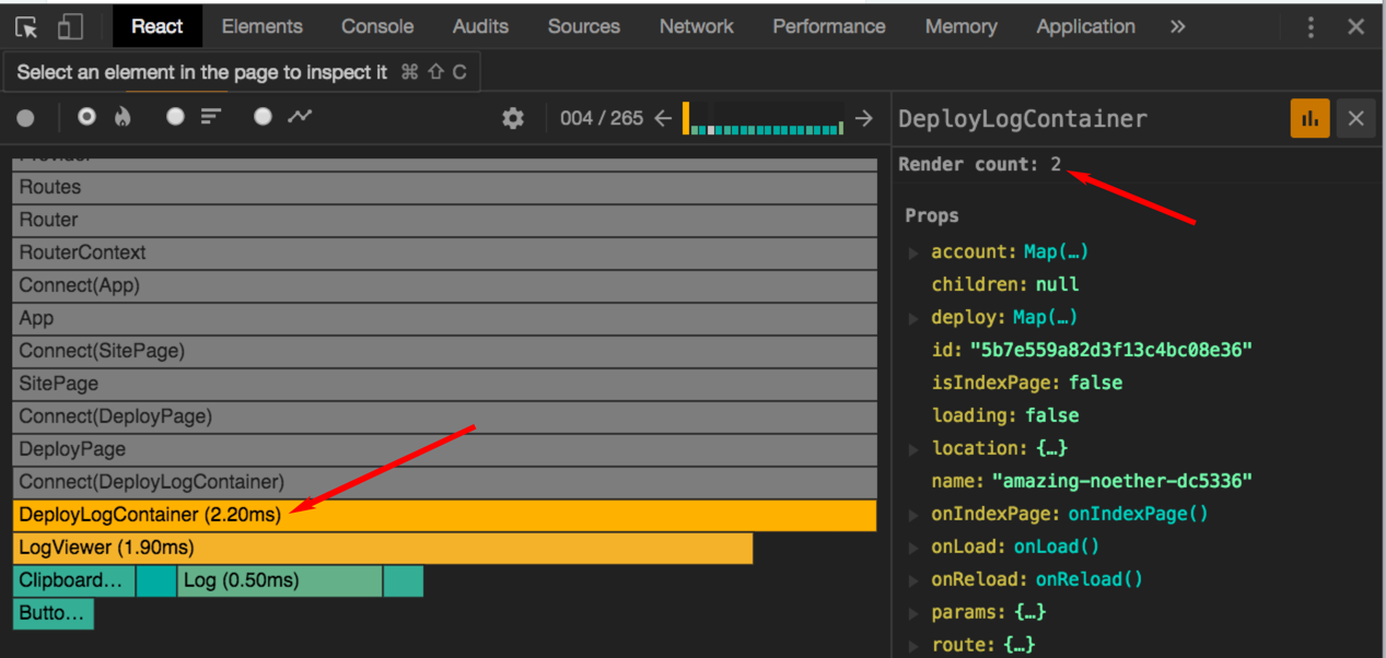

Re-running the app and Profiler, this is the new profile we get from a 500-console.log deploy log:
Only 12 commits! The page also loads noticeably faster. DeployLogContainer is still rendered 7 times, but presumably that is due to updates higher up in the tree, but we have fixed the big perf issue. The real test is when we go for a 10,000-line log:
We have the same amount of commits for a 10,000 line log! Awesome! Moving our rendering from O(n) to O(1) can only be a good thing, right?
