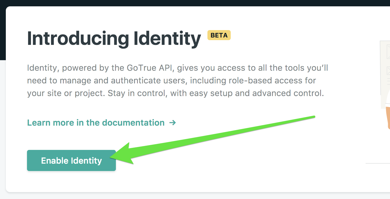

First, head over to your Netlify site settings, and click the link in the main menu at the top to go to the Identity page. The URL is unique for each site, but you can see all of your sites from the Netlify platform. Once there, click the “Enable Identity” button as shown below:
Once you’ve done that, you’ll see a list of current Identity users, which will initially consist of the email address associated with that Netlify account. From this page you can also add more users, but you won’t be able to complete user signup until you’ve done step 2. This is because to confirm an email account, the Netlify Identity Widget needs to be available on your site. -

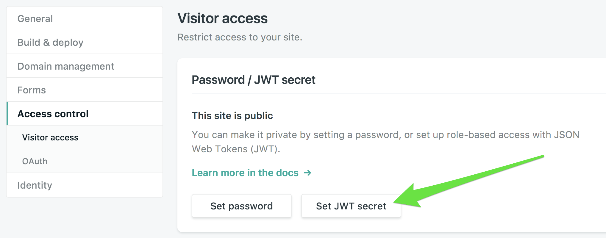

From your site dashboard, go to Settings > Access control > Visitor access, and set the JWT secret that you receive or set from the JWT authentication service you’re using. We need it to verify the signature on your tokens:
