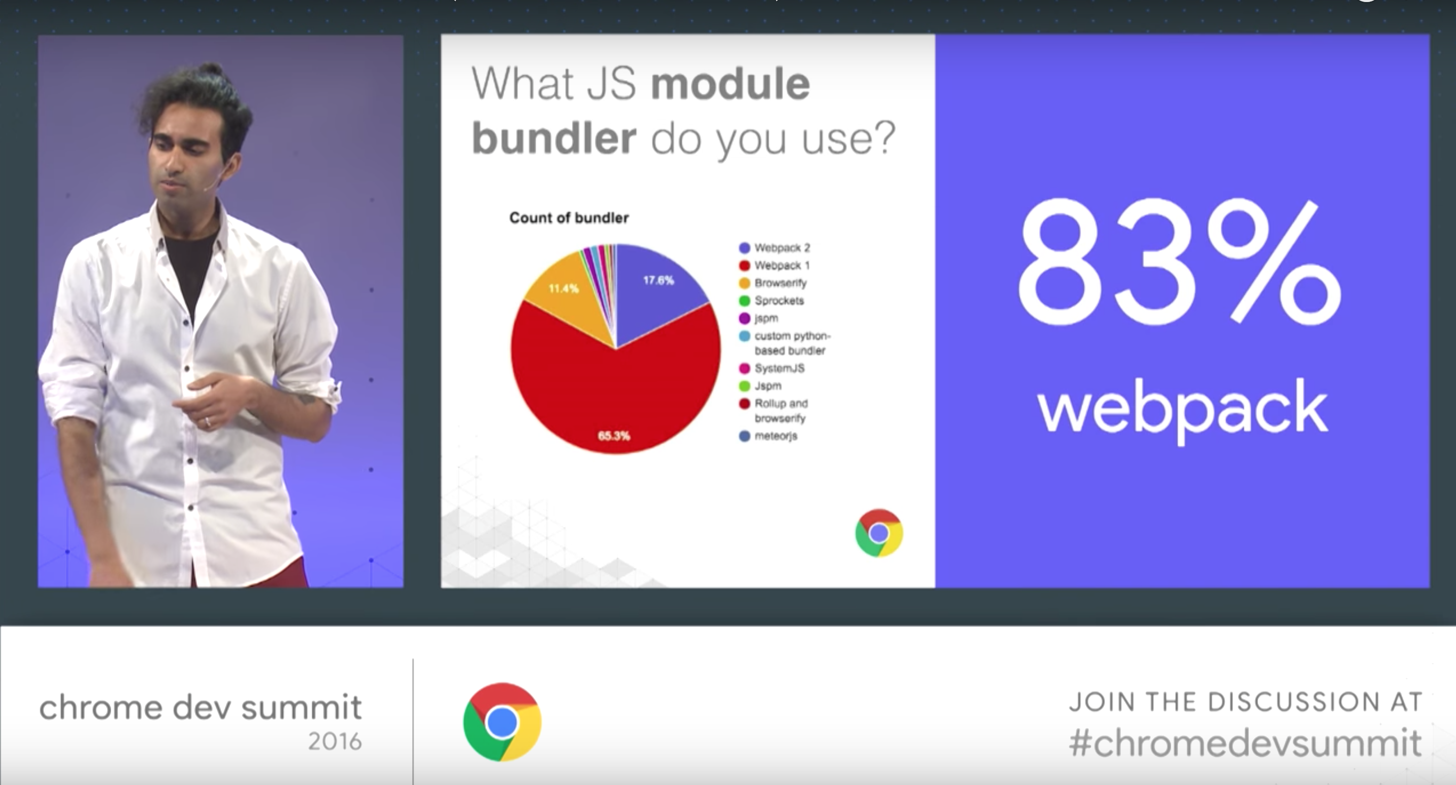

At the 2016 Chrome Dev Summit, Addy Osmani shared a remarkable revelation showing Webpack usage amongst devs who use a build tool to bundle their projects, Webpack owns 83% of that pie. I suppose you can say Webpack has the cake and eats it too.
