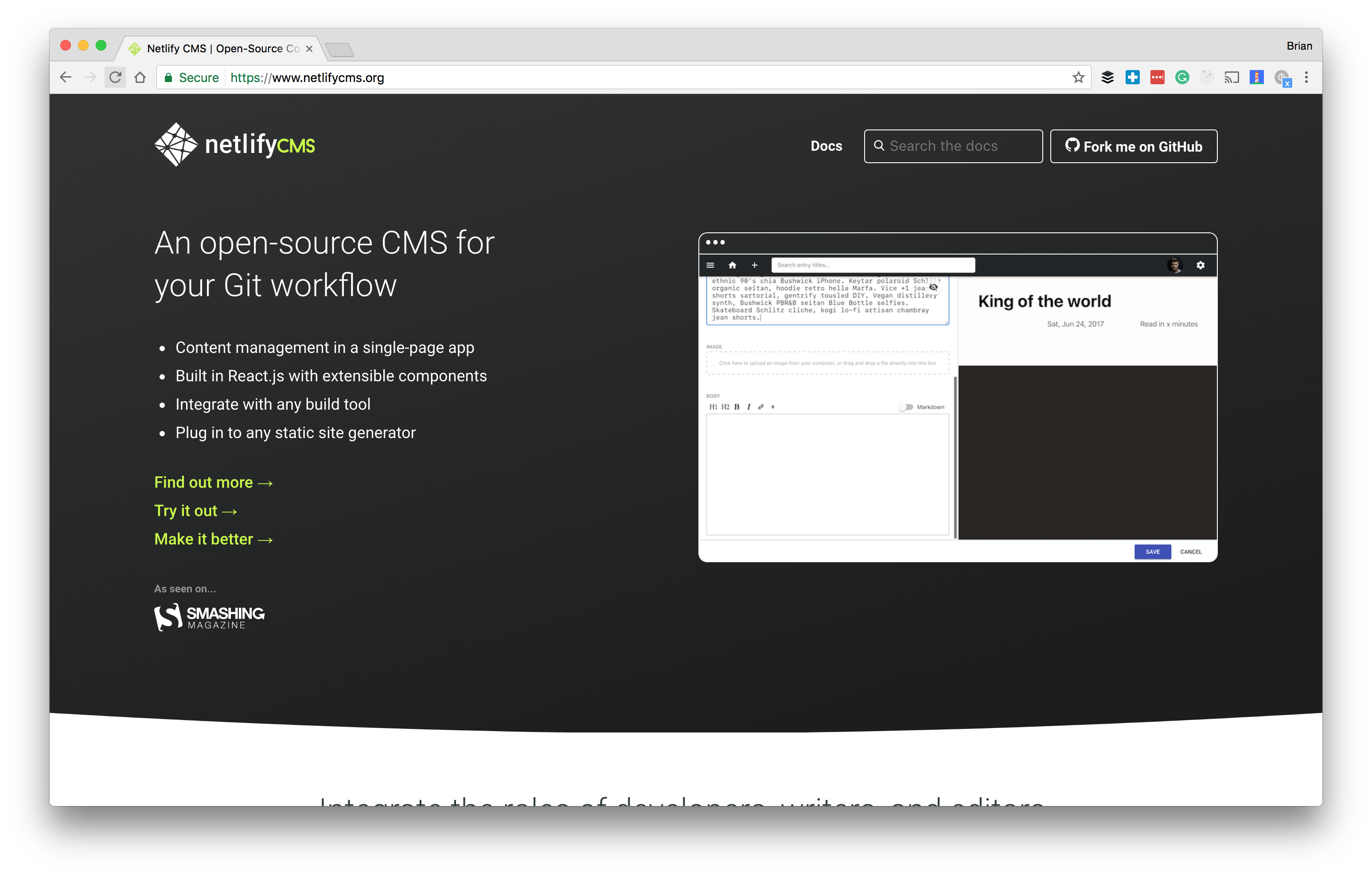

A few months back we launched a new project to the public called the Netlify CMS. If you have not had a chance to check it out, I highly recommend it for your sites built with static site generators.
This post not about the CMS, but about the infrastructure in place to keep the documentation site updated. The CMS project is open sourced and has a documentation folder structure that is colocated with the code in the repository. While making the documentation site, https://netlifycms.org, the challenge for keeping content always up to date presented itself.

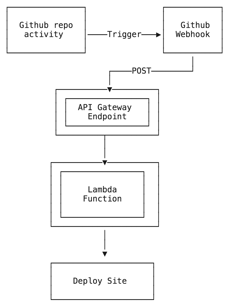

After watching the JAMstack SF talk from David Wells of Serverless Inc., I discovered you can easily keep two repositories in sync with a Lambda function and a few webhooks.
Serverless Webhook
Serverless is a framework for quickly creating and deploying functions as a service. I had an in-depth conversation on the most common use cases for serverless functions which made me aware of the existence of GitHub webhooks. Based on specific events in a GitHub repository, you can run functions available through HTTP.
I put together an incoming webhook for the Netlify CMS ORG repo in the Netlify Dashboard that triggers a new Netlify deploy on demand. I use the GitHub Event Listener example from the Serverless examples repository. This is a basic lambda function set up to be triggered when a GitHub event happens. I chose to trigger events on pushes to master and pull-request merges. Every merge that happens in the CMS repo is not always documentation specific, so these will add up. Luckily AWS offers 1 million free invocations per month and Netlify includes unlimited deploys, so there is no worry that the number of deploys will become financially prohibitive.
The entirety of this lambda function is available to view in the netlify-cms-docs-webhook. I am very pleased with this solution because it checks all the boxes for keeping the Netlify CMS documentation in sync and enabling contributors to commit updates without any hoops to jump through.
