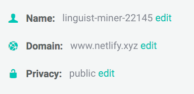

First, make sure that your custom domain has been set. The domain name of your site must match the domain name on the SSL certificate.

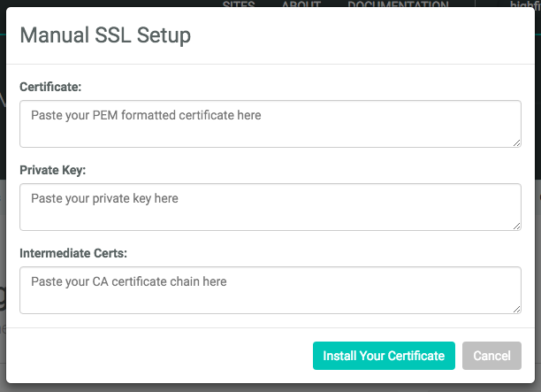

Next click SSL at the top of your page. Then click the button labeled Provide Your Own Certificate.
A window will pop up that looks like this:

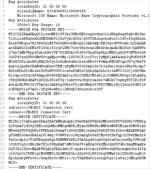

In the top box, you’ll paste in the contents of your PEM formatted certificate. PEM format is the format most widely used by Certificate authorities, and will usually have extensions of .pem, .crt, .cer or .key. The file will look like something like this:
Copy the bottom portion, beginning with the first dash of the Begin Certificate line and ending after the last dash of the End Certificate line. Paste the selection in the Certificate box at the top of the popup.
Next, copy your Private Key. Begin with the first dash of the Begin RSA Private Key line and ending after the last dash of the End RSA Private Key line. Paste the selection in the Private Key box.
Finally, you’ll need to paste in your intermediate certificate chains. The availability of these chains depend on certificate provider you’ve chosen. If you choose to install your certificate without adding in the Intermediate Certs, be aware that while it may appear to work in your browser, it could break when trying to access your site through a mobile interface.

Once you’ve filled all the fields in the popup, just click Install Your Certificate, and your site is secure.
