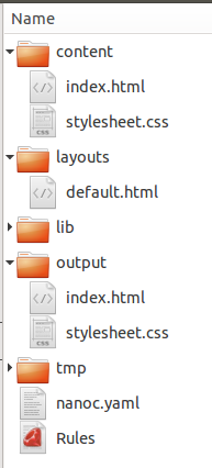

Let’s take a look at what’s under the hood of this Nanoc site. First take a look at the folder structure, as depicted in the illustration below, the files and directories created are as follows:
In the file and folder tree above, there are some distinct folders and to create content and customize the layout, it’s important to know what goes where and why!
In Nanoc we use the term layouts instead of templates and these all go in the layouts folder.
The content we’re creating goes in the content folder and here you’ll find the landing page and a stylesheet, ready for editing.
Then there’s the lib folder, which contains custom Ruby code and the output folder to which the static site will be written.
Of the files, its worth noting that nanoc.yaml contains site-wide configuration details and that the Rules file is used by Ruby to describe how pages and assets will be processed.

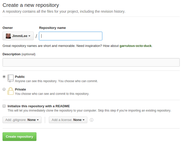

1. Create your Git Repo
Start by opening up GitHub and create a new repository for your Nanoc site.
We’re naming our site nanoc-demo and we’ll skip adding files to the repository until after its creation, as this can sometimes create problems (The README, license and gitignore files).
As you’ll see once you create the repository, GitHub provides very good documentation on what to do next.

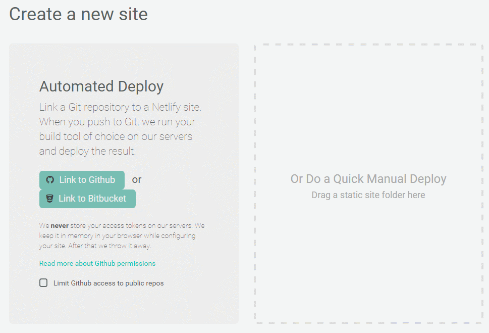

Step 1: Add Your New Site
Click the “New Site” button to get started.
Step 2: Link to Your GitHub
Next you’ll be brought to this screen, where you can choose between manual deploy or linking to GitHub or Bitbucket - we’ll link with GitHub for this demonstration:
When you push to GitHub, Netlify does all the work. No more wasting time on manual deploying of updates or changes!
To link Netlify with GitHub click the button “Link to GitHub”.

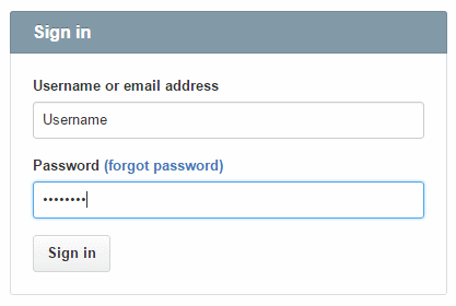

Step 3: Authorize Netlify
You can skip this step or rather it will be skipped automatically, if you already have an account with Netlify set up to automatically login!
If not, you’ll be asked to provide your GitHub login details:

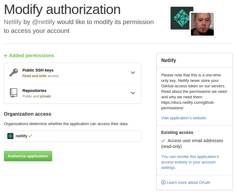

We need to let Netlify and GitHub talk to each other, so review the permissions and then click authorize application.
Like stated in the image above on the right, Netlify doesn’t store your GitHub access token on our servers!
If you’d like to know more about the permissions Netlify requests and why, you can check out our documentation on GitHub Permissions.

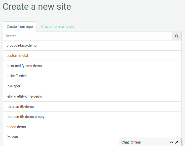

Step 4: Choose Your Repo
Once you’ve connected Netlify with GitHub, you will be shown a list of your GitHub repositories, as seen below.
For the purpose of this tutorial we’ll select the “nanoc-demo” repo we just pushed to GitHub.

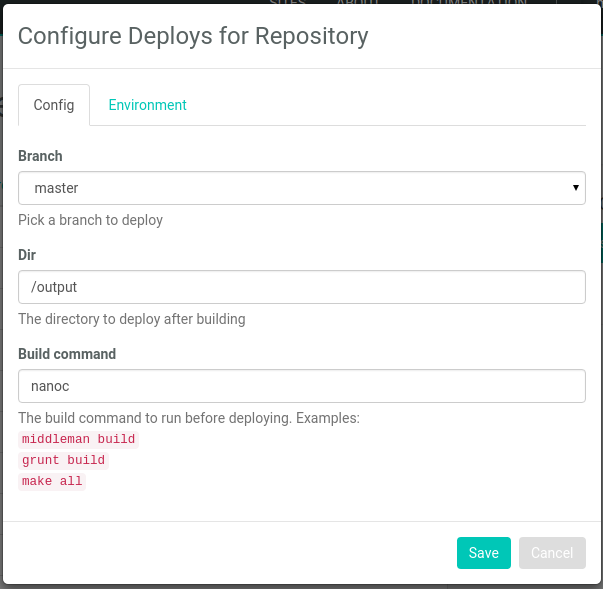

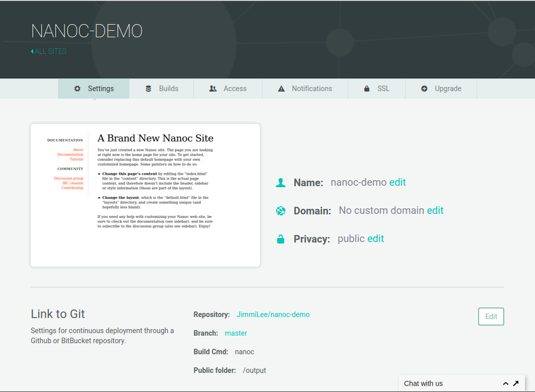

Verify the configuration settings as seen in the screen shot below:
You shouldn’t have to do anything, Netlify has actually done it for you. Click the ‘Save’ button and watch the magic unfold.

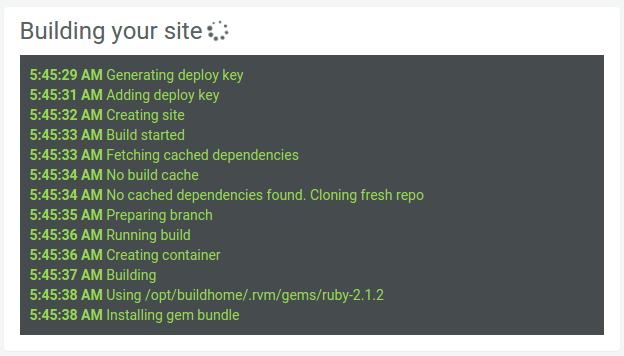

Step 6: Build Your Site
The first time, assuming you haven’t added copious amounts of content, Netlify will build your Nanoc site very quickly. A console will let you know what’s happening along the way. If you don’t want to wait, simply do something else and you can always return and check the log file later, since Netlify will keep the log of each build.
